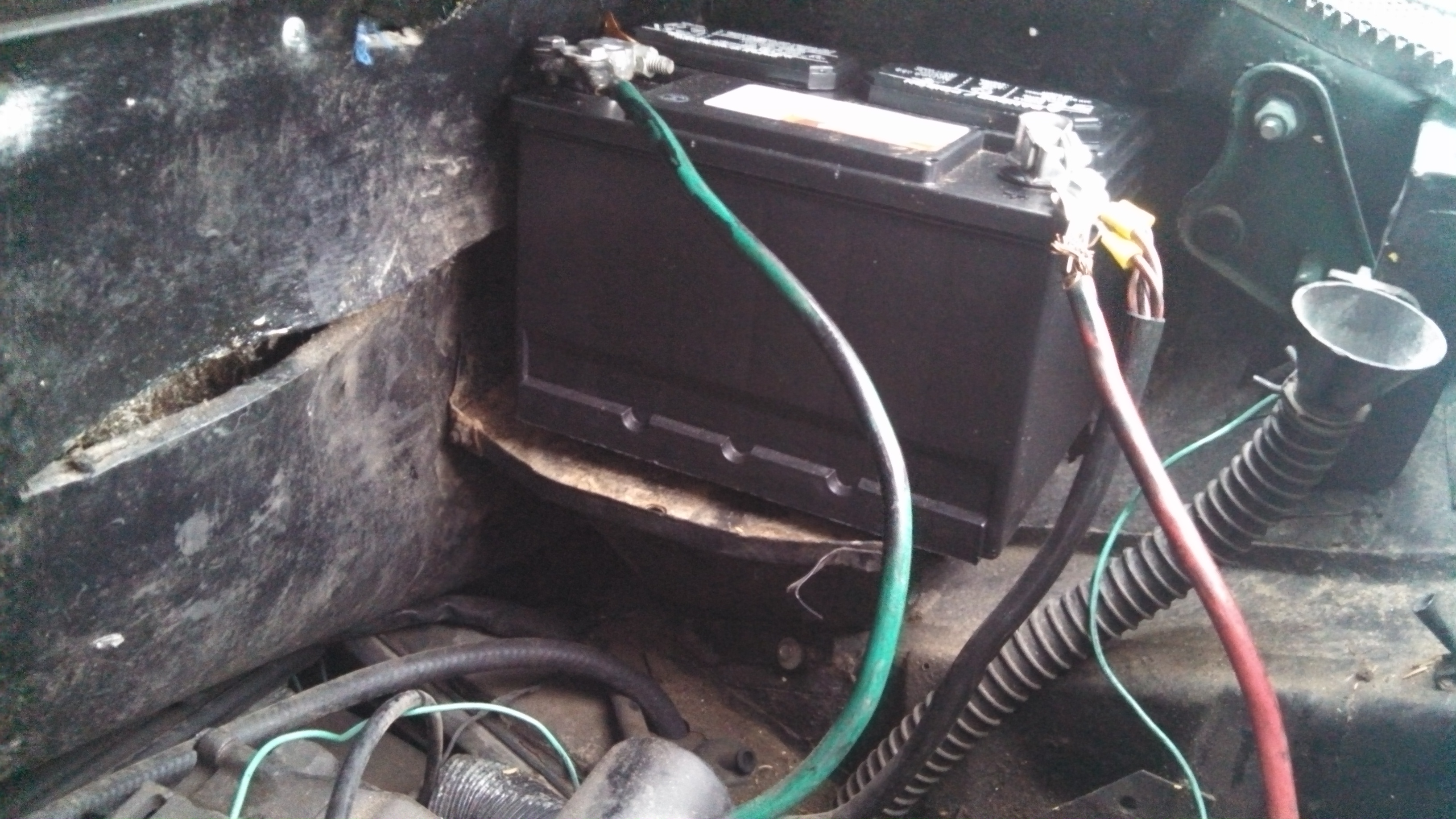

-one small hole under battery tray but tray itself solid along with rest of engine compartment

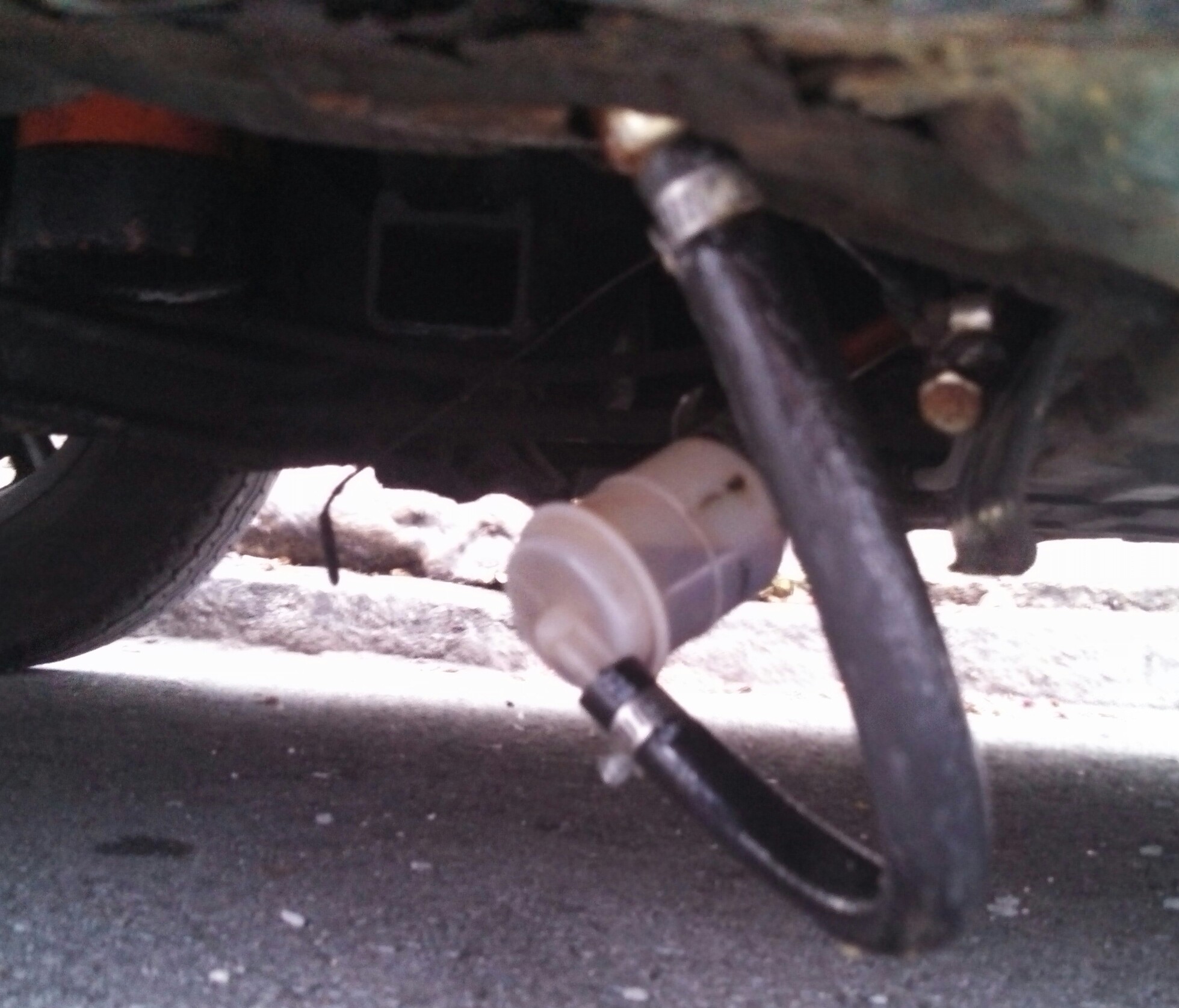

-jury-rigged fuel system downstream of plastic fuel line exiting tunnel

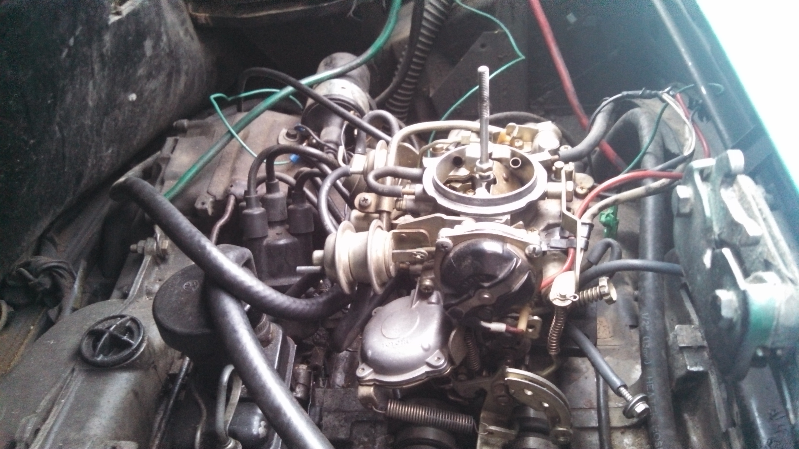

-unusual carb setup (it has toyota stamped on carb?)
I think that is it (for now) but I have a few questions for everyone.
What is the original location for the fuel pump? They have it mounted under the engine compartment in front of the rear passenger side wheel. There is a leak coming from the pump itself that I need to pull and repair but it would seem that location is not the best. I am hesitant to put the pump in the engine compartment but that seems like a much more accessible spot. Anyone have any other suggestions for that setup? The original plastic lines appear in good shape.
The carburetor has toyota stamped on a part of it. (I will add pics of it soon). And lots of the vacuum lines are disconnected or plugged. However, the thing starts and idles just fine. I cant even tell what kind of carb this is. Was there some toyota carb conversion for this thing at some time?

Sounds like the fuel pump is in the stock location. Later cars had the fuel pump mounted under the fuel tank...and many people with earlier cars have moved the fuel pump to that location.

Would you keep the fuel filter upstream of the pump when moving up front? Does anyone have a pic of the stock set-up (rear mounted) and maybe a conversion to front mount?
Steve
Pick up a Haynes 914 manual. It's a great place to start with lots of pictures. Get rid of the plastic fuel lines. Get the metal fuel lines from our member vendor section. If the tires are old then replace them. The rest will just take some sorting out, but don't take a chance on engine fires.
With carbs you will want the filter between the tank and the pump. The biggest advantage of relocating the pump to the front is the vapor lock issue on hot days.
76-914
Here is one, there are many posted. http://www.914world.com/bbs2/index.php?sho...=117077&hl=
Gint
QUOTE(mr914 @ Dec 17 2012, 03:21 PM) *
More pictures.
agree.gif On all counts...
