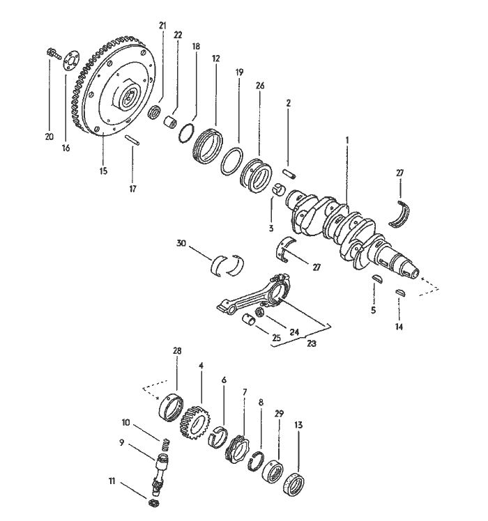

What is the purpose of the crankshaft spacer- pictured below as #3?
914Sixer
Dec 18 2012, 10:24 PM
Stabilize the flywheel bushing?
Mark Henry
Keeps the pilot bearing from working itself into the crank end. On the bus the pilot bearing is in the crank where this spacer goes.
