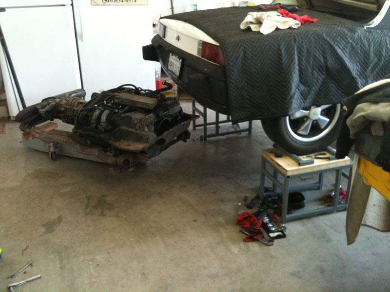

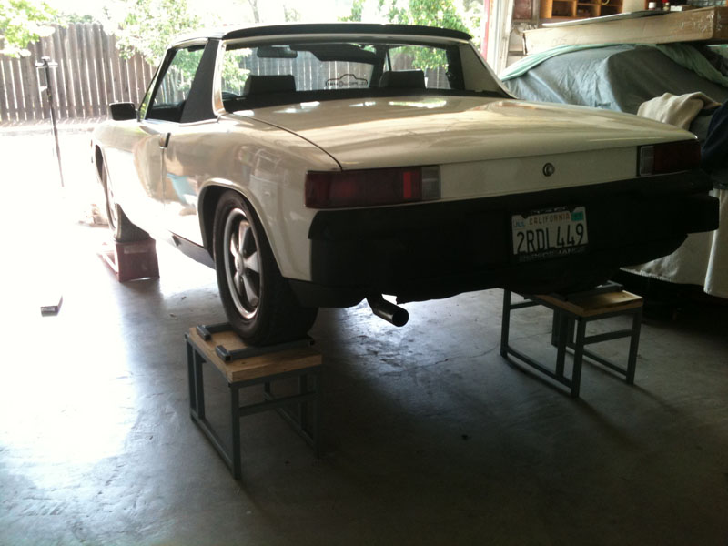

I use ramps for the front, then I have platforms I built for the rear tires to sit on.
Pulled and installed a few motors with this set up by myself.
Click to view attachmentClick to view attachmentI only had to remove the air cleaner, plenty of clearance to leave the wheels on.

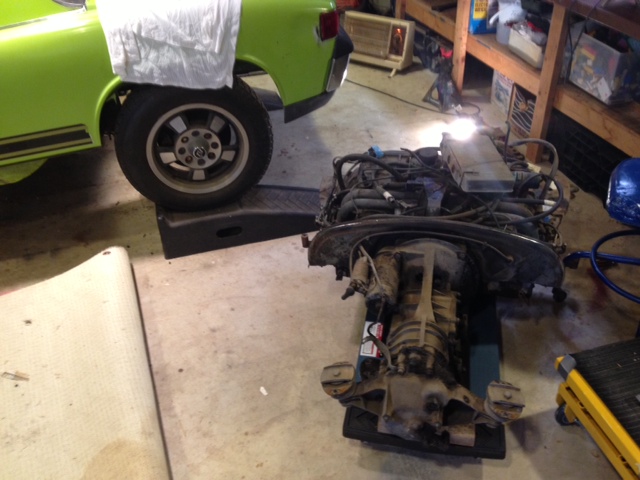

She's out! Tried the table jack, but it sits REALLY high even at its lowest height. Ended up doing it the HF dolly way... Sucked because I had already had the engine/trans out and on the table jack only to realize it was WAY too tall still... had to 3-jack it onto a separate dolly.. talk about scary and time consuming!
Ugh.. oh well.. official second notch on the ol' engine drop belt! Trying not to make mistakes on this one. Let's just say I labeled EVERYTHING!!

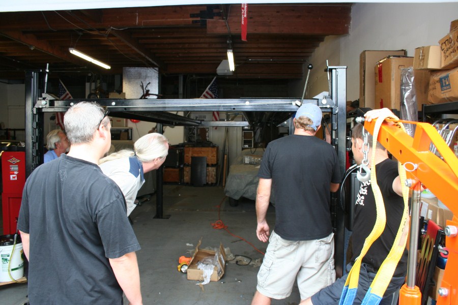

If you have the space for one of these ... I highly recommend them

Those ramps you're using are really low, higher ramps would give you the room to use the table. Or just jack the car up higher when you're ready to slide it out.
Transferring to the dolly must have been fun.
Higher ramps for the back would make it easier, then use the smaller ones in front so the car is still close to level....it does help if it's level.
Hope this helps, looking good!

euro911
Jan 8 2013, 01:27 PM
I'm hep, Jeff
... but it's the best $2k I've ever spent on a tool
The HF hydraulic tables are nice. It can double as a tear-down bench or to transport your engine to a stand. Well worth the $
The only issue with the table is that you have to remove the handle to fit it under the car. I want to fab a fold-over mount for the handle.
