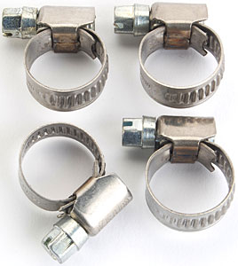

jimkelly
tangerine (cfr ) has them.
http://www.tangerineracing.com/stainlessFuelLines.htm#Fuel Hose Clamps
JawjaPorsche
NAPA sells small boxes of the clamps at a good price. They have 10 in the box. The part number is 705-1226
TheCabinetmaker
Napa, oreillys, auto zone, the bughaus. All sell them
jimkelly
my local napa guy had no idea what i was talking about when i asked him about them the other day. i should have brought an example with me.
Gint
I get 'em at the local chain parts places all the time. Haven't check NAPA, but I never had to because the others have them.
rfuerst911sc
I believe they are called fuel injection hose clamps vs. just a hose clamp. I also have been able to by at local FLAPS.

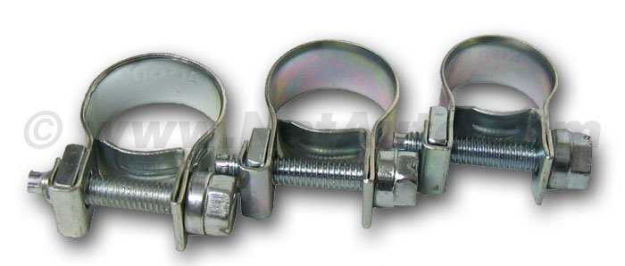

r3dplanet
The second photo there shows something more like "constant torque clamps." I use them for everything with larger than 1" diameters. Much stronger than fuel injection hose clamps or radiator hose clamps, but the range of diameter is much smaller and they take a while to thread on or off. So you really need to know the exact size of initial free outer diameter and how far it down it should clamp before you buy them because they're spendy. But it's total clamp porn. I get them at the local Aeroquip dealer here in Portland.
Having said that, fuel injection hose clamps are perfectly suitable for fuel injection hose clamping.

Cap'n Krusty
The "real" FI clamps have rolled edges, not flat like the ones pictured. While better than the worm screw type, they're still not right.

jimkelly
seems to be some lively discussion going on - and no one is using duct tape biggrin.gif
jimkelly
ok - napa does have them - in 3 sizes
i just got some clamps for 9.5mm rubber hose (3/8 hose) - pn 705-1227 (large)
the pn for 5/16 rubber hose is 705-1226 (medium) (they were out of stock at 2 napa locations)
and one smaller size.
rjames
QUOTE(Cap'n Krusty @ Dec 31 2012, 09:44 AM) *
The Cap'n
I agree with the Cap'n. I sure wouldn't use the ones in the pictures with FI. If they don't have the rolled edges they can bite into your fuel lines. I didn't have a problem finding clams with rolled edges at FLAPS last time I looked. Have they become scarce?
stugray
I had the same issue.
After spending over $10 a foot for the best fuel line you can get, I decided I shouldnt use 10-cent hose clamps.
I searched and found these at Jegs:
IPB Image
http://www.jegs.com/i/JEGS+Performance+Pro.../16050/10002/-1
They dont bite into the hose like the type with the open slots.
You can also find the other kind that have the rolled edges so they are not so sharp, but as mentioned above, they have a much smaler range of hoses that they can work with:
