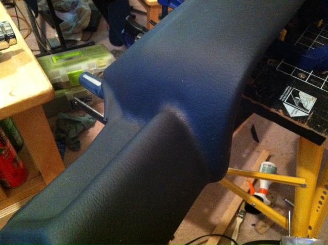

When I modified a 911 dash for my project I used the Flexible Bumper repair filler, worked very well.
Click to view attachmentClick to view attachmentI cut back the cracks so the edges would not be rolled up.

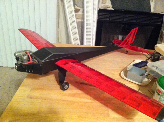

Link to microballoonsBob, if you go this route PM me. I have some leftover micro balloons from my aircraft days.
Bob L.
Jan 8 2013, 12:14 AM
Thanks for some good ideas. I'll probably do the epoxy or bumper filler. I don't want to deal with a layer of foam.
If I do the epoxy I'll be in touch about the microbaloons.
I built a plane but never heard of the stuff.

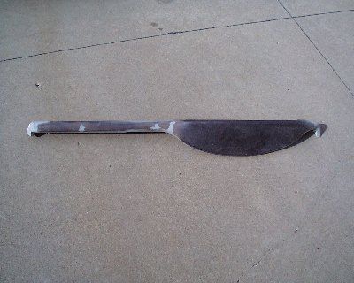

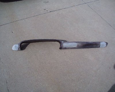

Don't want to hijack but I have a mold. Made my CF 914 dash with it. I just dont have time to go into production. More on this in a new thread...

Bob, It is a CF dash. Not an overlay. I started a new thread with a photo.
