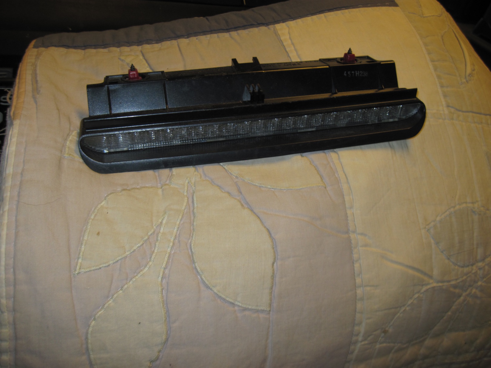

First, I got a center stop light from a wrecked Volvo V70 (MY 1998-2000), part number 9151490. It was about $10 at the local PnP.
I was also able to get about 4+ feet of the wiring harness, which I cleaned up and reused.

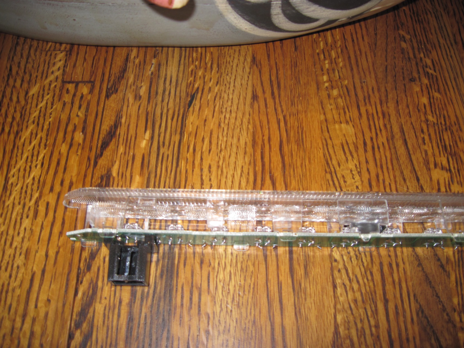

I picked this light as I'm pretty familiar with Volvo stuff, and had noticed on the road that these were pretty bright, even if I wasn't directly behind them. In taking the light apart (curiosity can be dangerous dry.gif ), I found that the wide viewing angle is due to a couple of clear plastic diffusers.

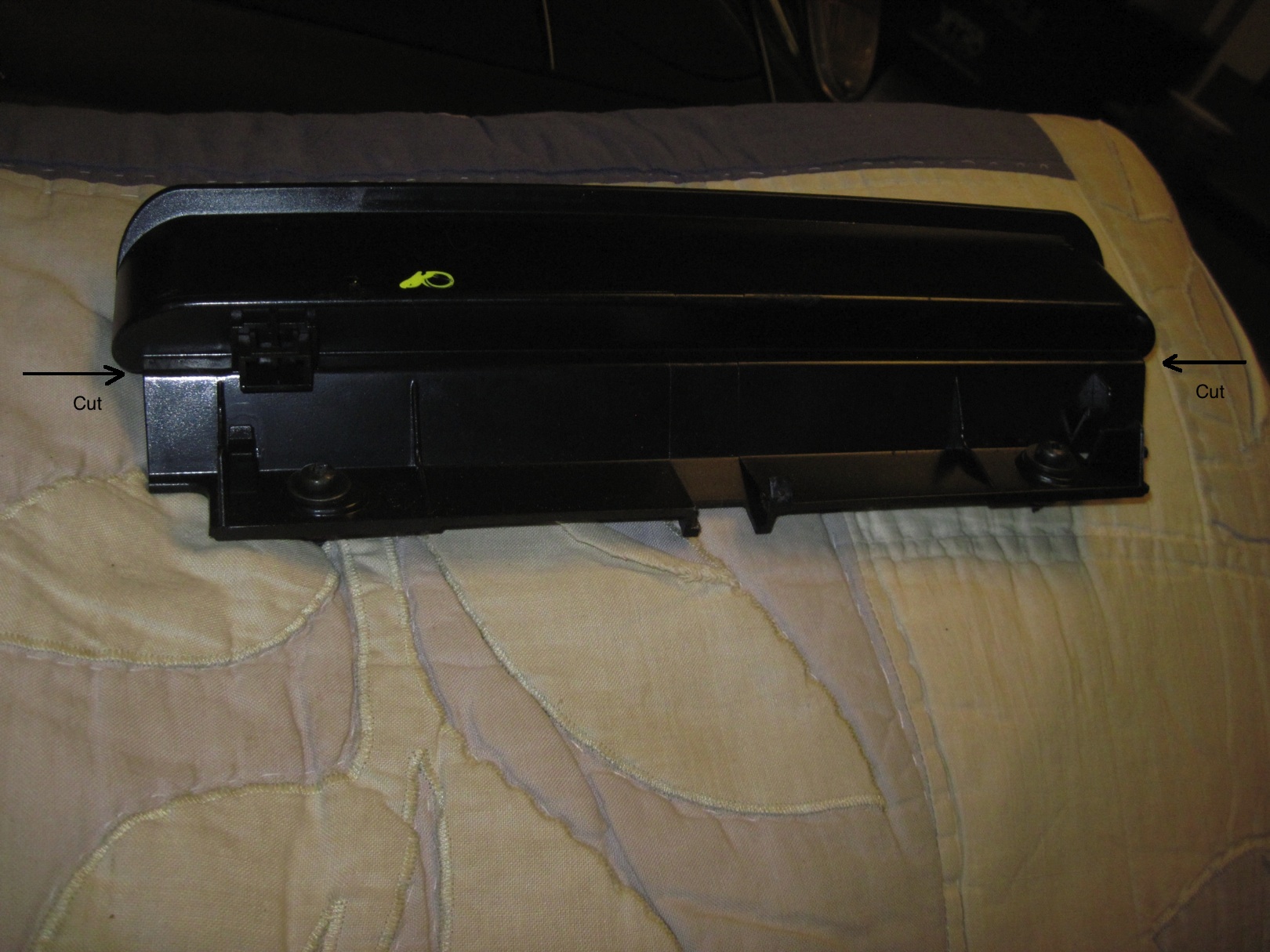

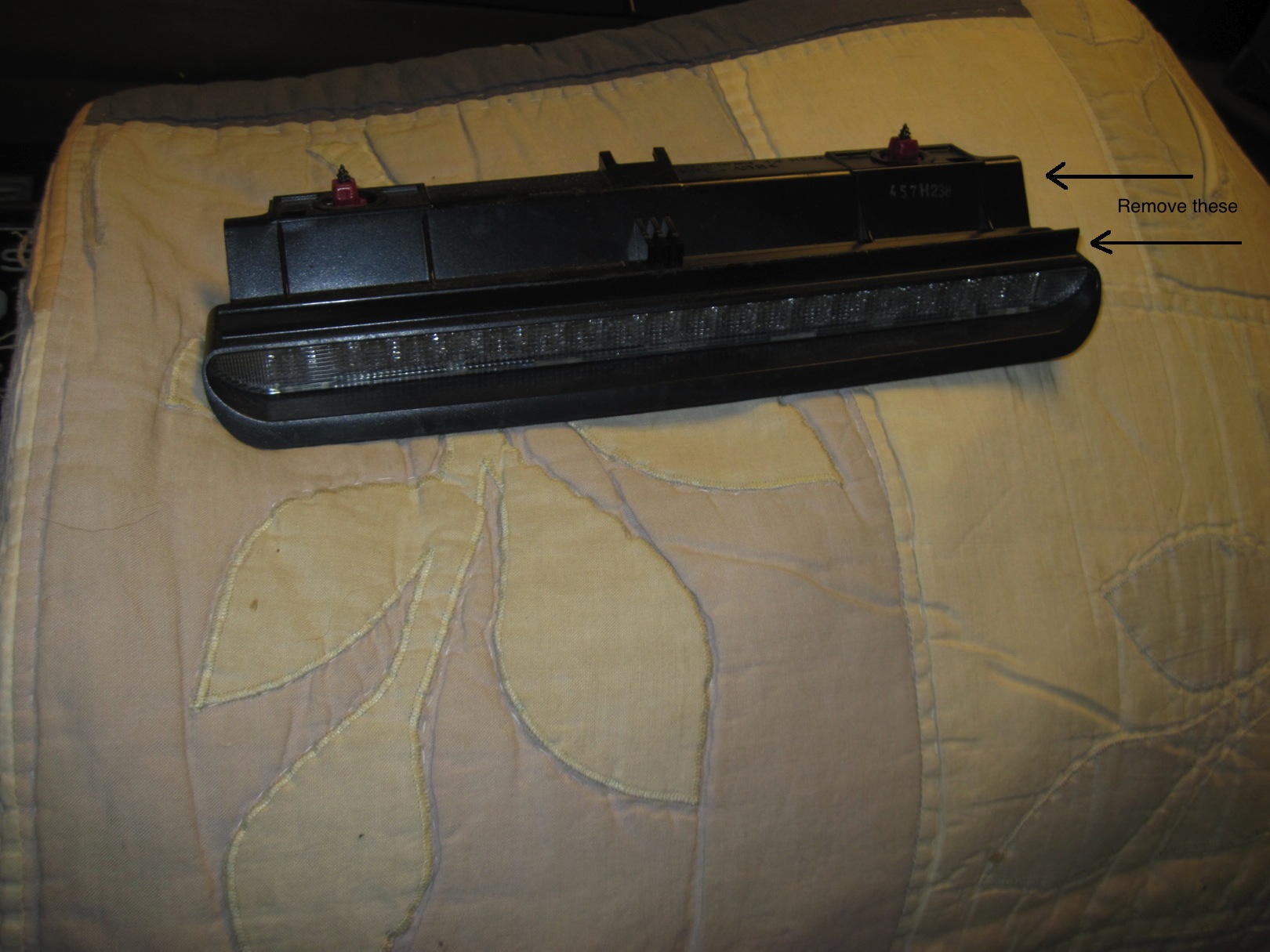

Next step was removing a couple of ribs/mountings from the bottom of the light.
I used a rotary tool (dremel?), then sanded it smooth.
anderssj
Here's another look at the mounting flange from the other side of the light:
For now, I left the lip around the lens in place.

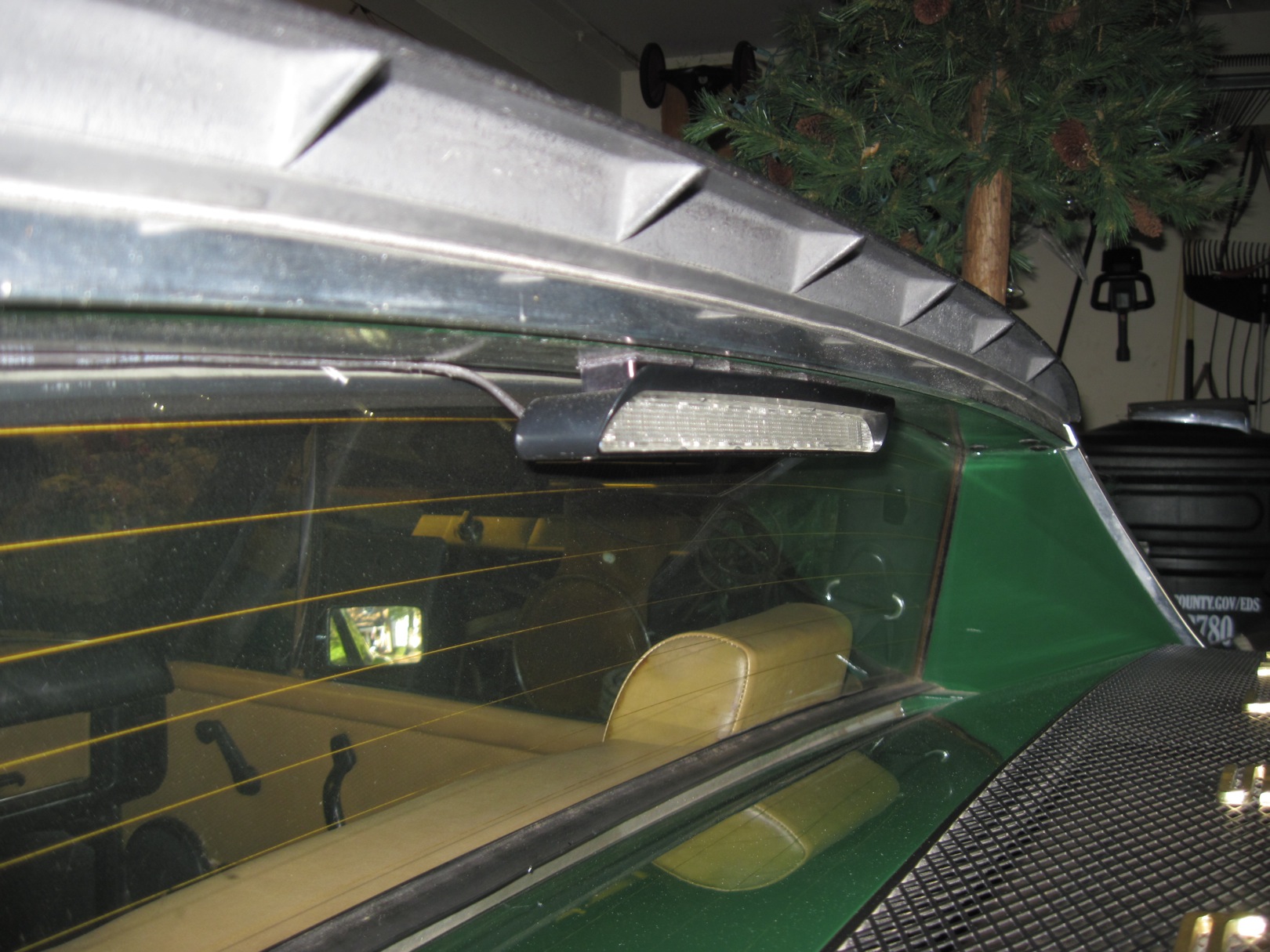

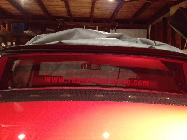

I epoxied three rectangular ceramic magnets to the upper surface of the light. They were 3/8" x 7/8" x 1-7/8" (9,5 mm x 22 mm x 47 mm) and came 2 to a pack (PN 07044, "the Magnet Source," available at the local hardware store).
I got a thin mouse pad at Office Depot, and fixed pieces of it to the magnets (mouse side to the magnet, so the rubber non-slip side is exposed). Sorry, I forgot to take a picture of this part.
You can kind of see the magnets between the upper surface of the light and the underside of the roll-bar here:
I had originally thought about using some of that 3M foam tape to attach the light to the rollbar, but opted for the magnets once I realized how firmly they hold on.

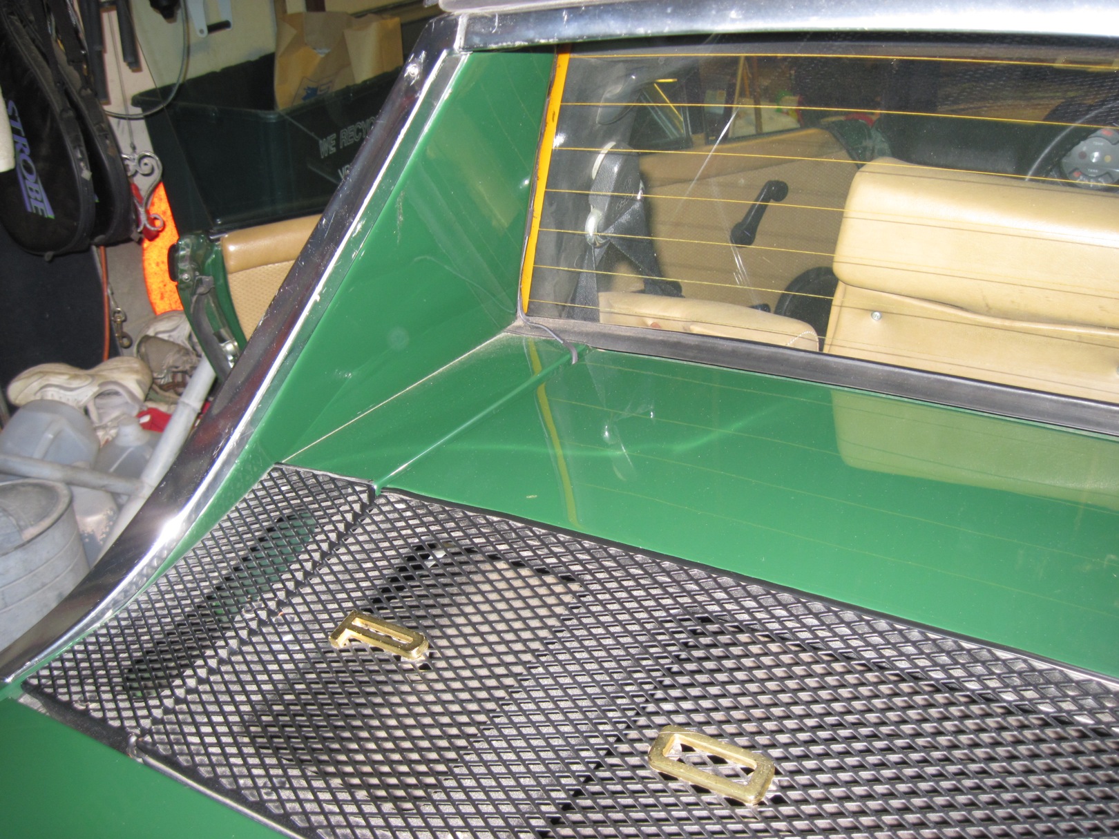

I cleaned the wiring up and put it in heat-shrink tubing. The Volvo wire is pretty small gauge stuff, as the LEDs don't use much current. I ran it along the upper edge and left side of the rear window, then into the engine compartment through the gap between the lid and the body.
I used a molex 2-pole connector to tie into a harness I made, one wire to the driver's side brake light (+), the other (-) to the ground lug on the body just above the relay board. (REMEMBER to disconnect the battery's ground terminal prior to doing any electrical work)

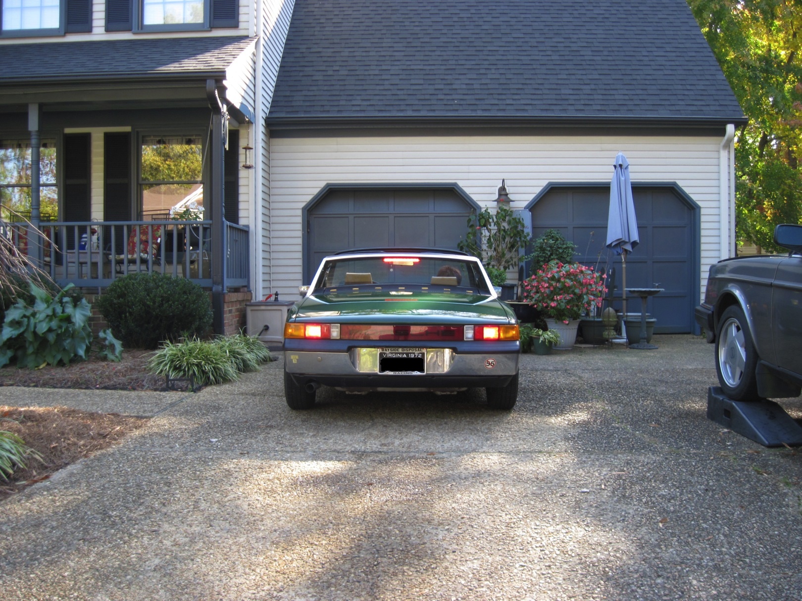

Here's a picture of how it looks with the brake lights on:
