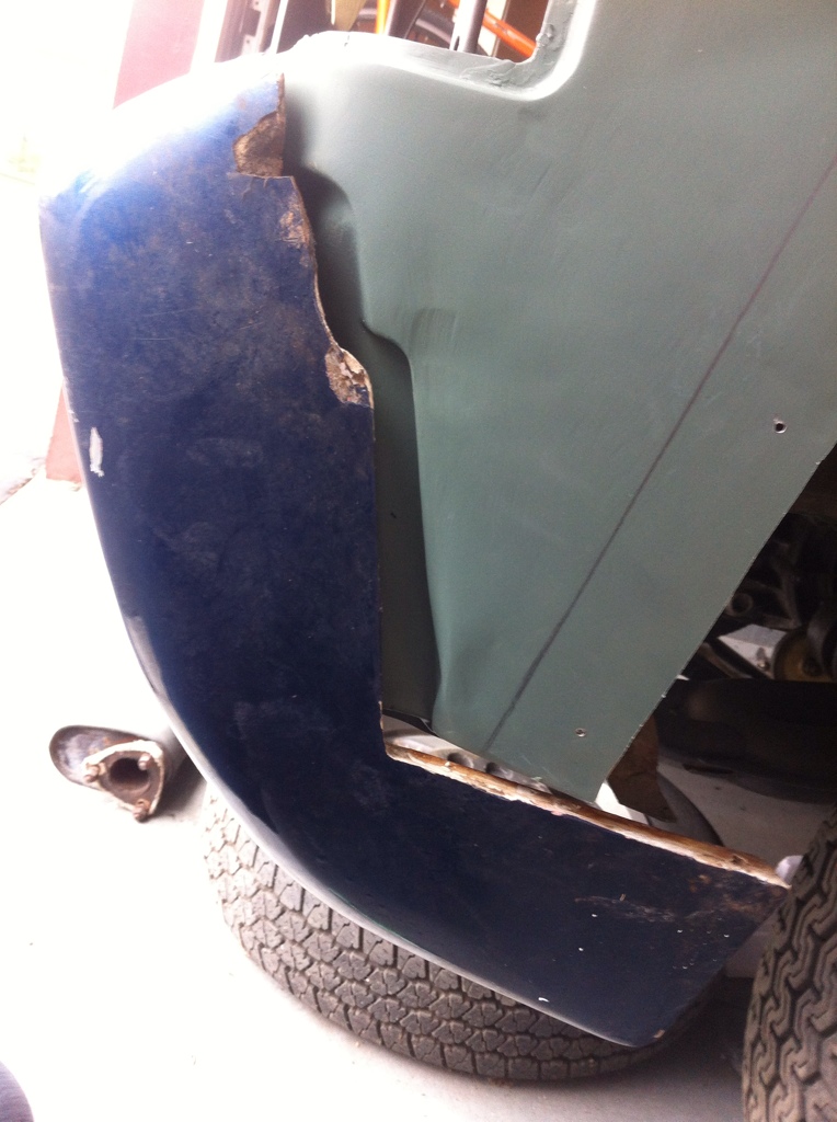

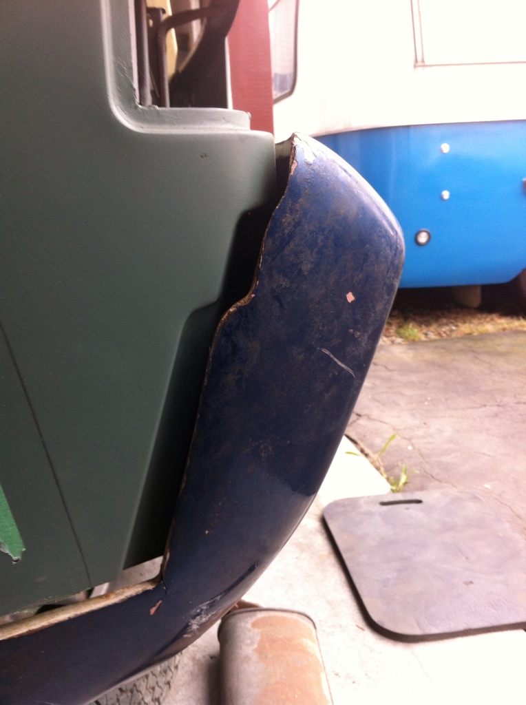

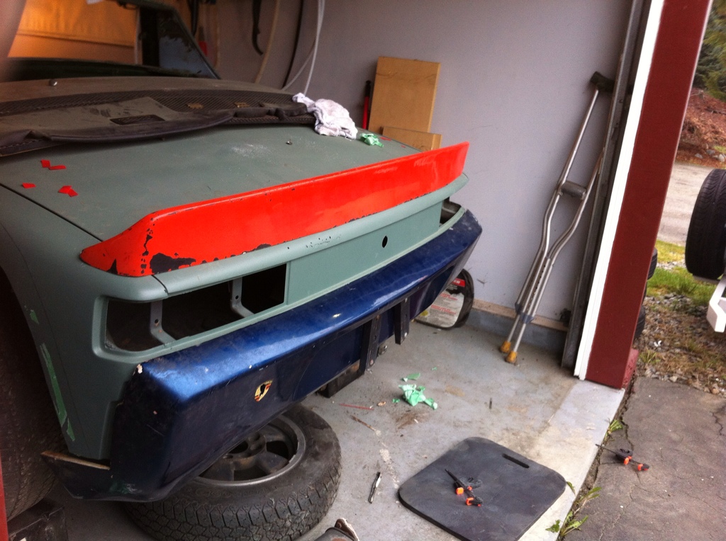

Hi guys I picked up some used 916 bumpers of a fellow teener and the front bumper seems to fit great. But the rear bumper really doesn't line up or fit well at all, anyone have any ideas? Where is the top lip of the bumper supposed to line up on the rear of the car and also the side indents don't seem to match well.

JamesM
did you install these with the dog bones? looks like they are spaced out quite a bit. On mine they are bolted on directly with no spacers.
scotty b
Do yourself a favor. Throw it away and buy a new one. You'll be WAAAAAAY ahead of the game. There were a couple manufacturers for those and you seem to have gotten one of the worst ones, plus it looks like it is full of bondo.

Anyone have a close up of what the finish bumper should look like. I can get the bumper to come in closer as the bottom is hitting the exhaust but body lines seem weird on the sides.
Also the rear spoiler has no bolts or mounting holes ?? Looks like it was installed before...

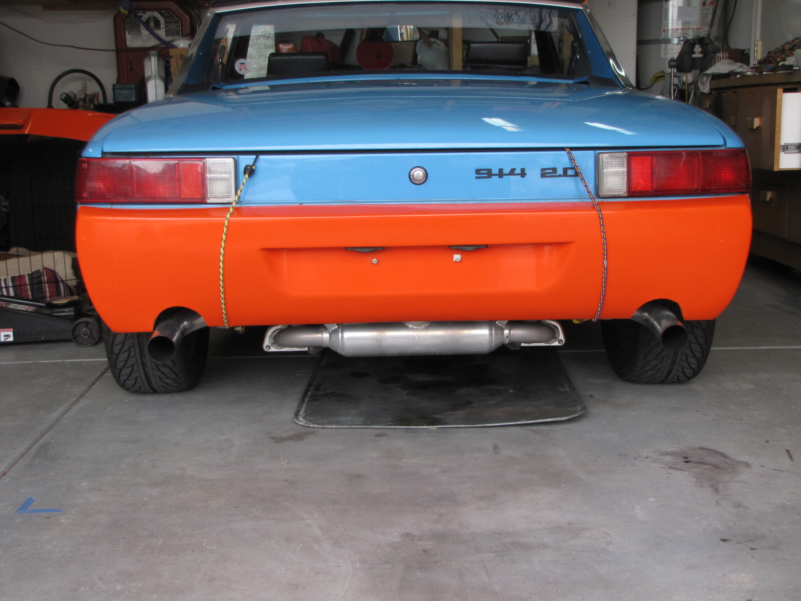

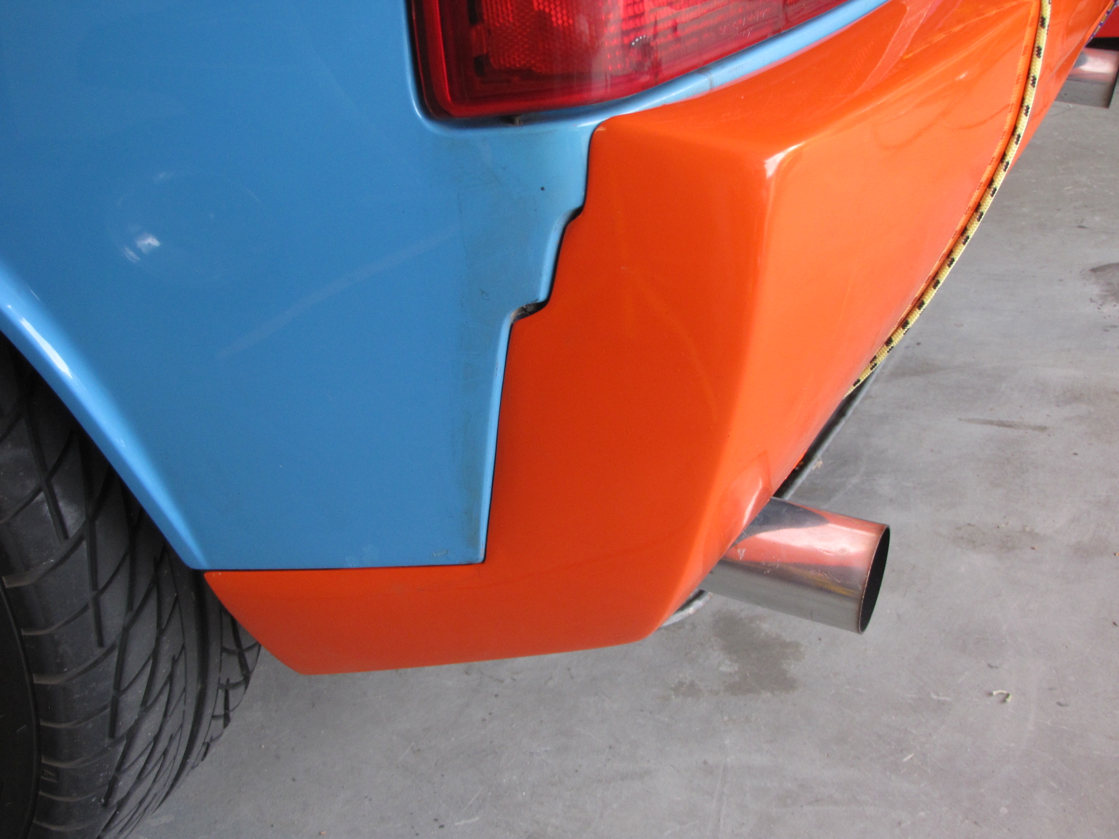

My front fit fine as did the rear with little reshaping. I did make brackets out of aluminum because they fit on an angle. The so-called "dog bones" would not have worked on my 75. I did have to re-shape the exhaust holes to make the Triad pipes fit better. I have spent hours on this work. I have removed all of the orange paint to find a lot of bondo. Some I fixed with resin and fiberglass. Today I am spraying the primer coat to see what it really looks like. I plan to paint them the same color as the car later today or tomorrow.
By the way, if I had it to do over, I would have bought brand new ones. I would have saved many hours of preparation. I would have done this even though mine fit pretty nicely. Well, if I go wide, I will have to do it anyway.

Looking good thanks for the post it really helped a lot. I like the orange blue 76 combo love to see it when it's matching it going to look good.

I remember seeing pictures of the rear bumper on the car they came off of and the Triad outlets were centered fairly well. Work was supposedly done by a reputable body shop. I never test fit them to my car, but the Triad on my car is 42.5" driver's side inside outlet pipe to pass inside outlet pipe. Wonder if the dimensions changed a little over the years?
I think even new ones are going to take some fitment. My guess would be the front fit so well because it had been fitted, modified, and installed previously. All of these cars seems to differ slightly in dimensions. I think the Phoenix Red looks good against the Blue!

Hi Tom
Actually the holes for the Triad are untouched in the photo I posted. I have since closed up the opening a little. Probably would have been fine, but I am kind of anal.
I got them sprayed today with primer. Hopefully Laguna Blue tomorrow if it doesn't rain. I am trying to get them done and installed on the car for a run on Sunday. Again, if it doesn't rain.
