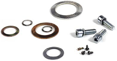

I sent to Pellican for CV bolt lock washers. I think I could have found these at the local hardware store. Are the others not available anymore. Should I trust these?

Actually, I found schnorr washers at my local Ace hardware store. I would not use those washers they sent but that's just me.

Bad on Pelican.
I buy Schnorr washers a hundred at a time.

serrated, black oxide spring washer (Schnorr)

That's what I thought I was getting. Looks like I'll be sending them back.

Belleville and Schnorr are actually (2) different washers.
The Schnorr Safety Washer S (registered) is the correct washer to use. They come black, yellow, clear zinc and stainless steel. M8 is 1000/box.

McMaster washers come in a bag labelled SCHNORR in big letters. I'm content.

The ID should be towards the bolt head. I guess a picture is better...

The washers I have always used have a serrated surface on BOTH sides of the washer arranged at an angle. This one looks a little different.

The washers are serrated on both sides. It just doesn't look like it in the pic.

Boy I'm glad someone spoke out, those kinds of washers will flatten out and you will loose your torque, wired or not.
