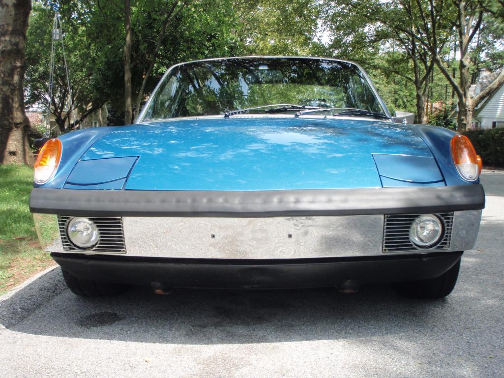

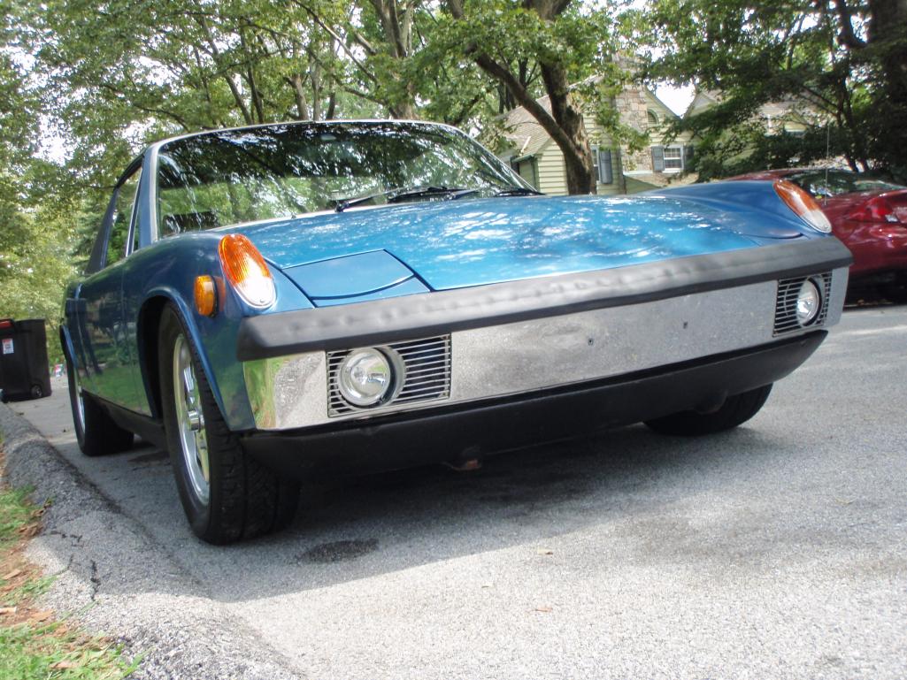

Do you like it Before or After ???
BEFORE
AFTER

I like mine with the body coloured bumpers.
I gotta say that I don't like it as much with the chrome.
Sorry dood.
struckn
I lean more towards the stock look but I think it would look better if you where to go with fender flares too. However, you should keep if you like it and that's the look your going for, nothing wrong with it. Wondering, if you've notice any change in performance, is it functional?

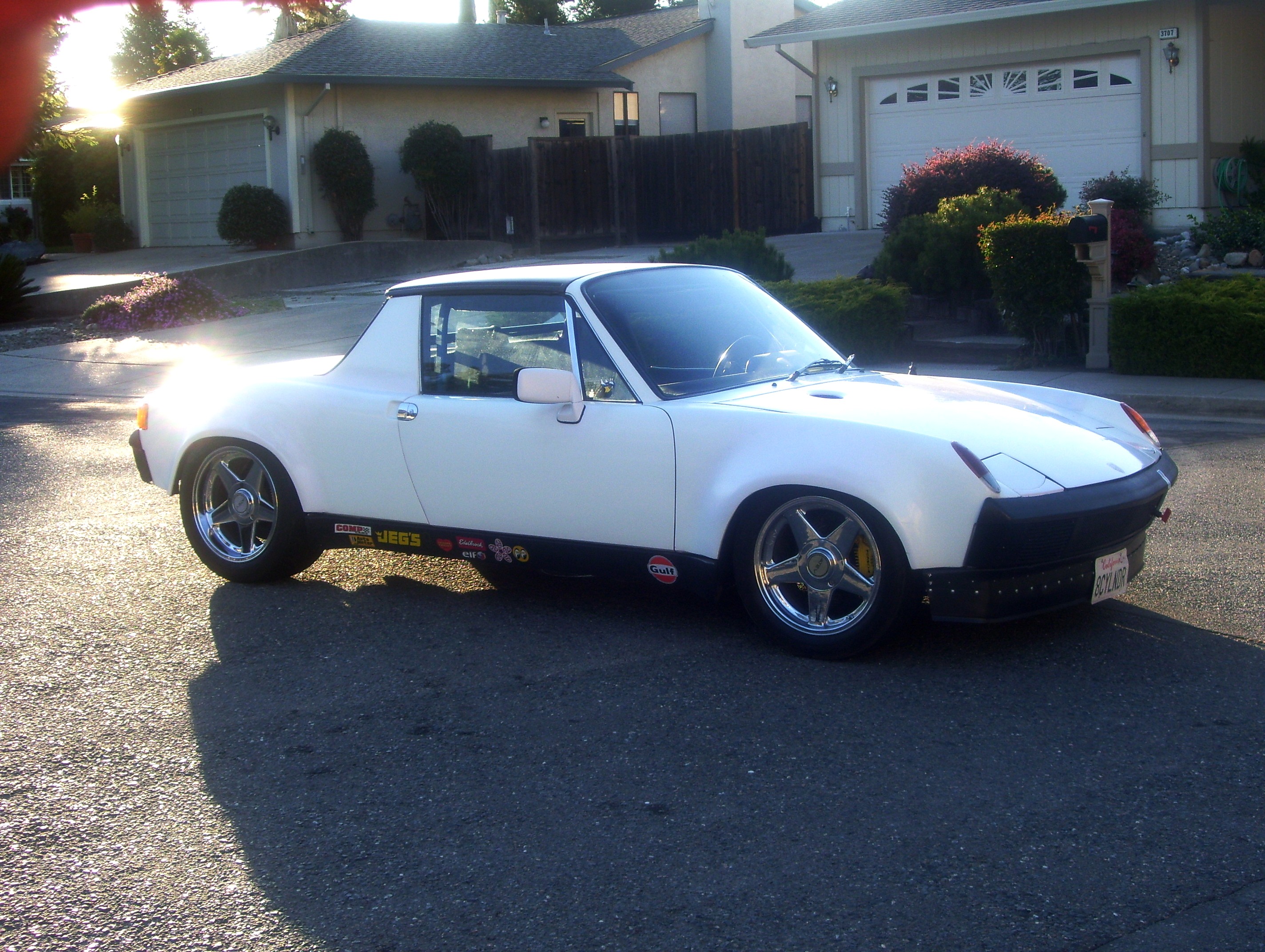

Elliot Cannon
With all due respect for your wife and kids. I think it looks great. You may however notice a slight rise in oil temp. Maybe. I really like the look.

IMHO it looks sleeker with the OE front valance, but you need to straighten that ding & repaint it.
Back in the 70's there was an aftermarket spoiler/valence which had essentially the OE valence profile with a flexible synthetic rubber blade spoiler coming off the lower-rearward portion of the stock valence.
Think of a thin black flexible spoiler blade about 3" deep coming out at about 60 degrees below horizontal from the lowest point on your stock valence.
IIRC Performance Products & a few other aftermarket "Porsche-hauses" sold them. Wish I could find a pic of one in my old PP catalogs! dry.gif
IMHO those were best looking, and the flexible blade bent if you hit a tire stop, curb, driveway apron - so it wouldn't break the blade nor the GFR resin valance portion.
PS - get Mikey's repro bumper top pads for those bumpers. That dimpling on yours means it's rusting at the stiffener & studs inside, and it will eventually crack on the top &/or underside, then dribble rust down on that nice chrome bumper & sweet paint! His have better/less porous "rubber" & SS metal innards & studs which won't rust -ever! Better than OE!

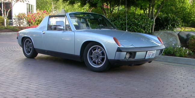

I like mine, see below, but with that said, there will be those who say otherwise...

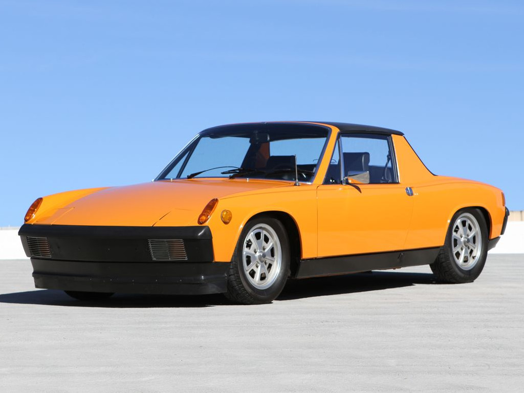

If you keep the air dam / rubber skirt combo be careful with steep driveways, big speed bumps, etc. When my car was lowered (below), I couldn't get out of my driveway without hitting the rubber skirt. Now you may think no big deal it's rubber, but the problem is that if you hit the skirt hard enough it will deform the air dam and may cause it to crack. Mine was cracked in three places before I eventually dumped it and went back to the stock valance.

I did the exact same thing to two 914s I owned in the '70s and want to point out the obvious. You now have lower ground clearance. The reason I mention this is that I totally messed up one of my air dams while driving on uneven pavement where there was a slightly high crest in the middle of the lane. If I recall, it cracked the air dam and I had to replace it -- and avoid driving in that area.
The car looks beautiful and I love those Fuchs on that color car.

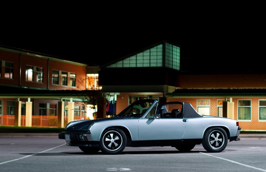

I like the fiberglass alone, but it's a little cleaner.
Sorry no safety bumpers
