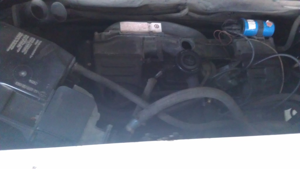

Since it sounds like you are not completely sure whether you have a 1.8 (L-Jet fuel injection) or 2.0 (D-Jet), if you post a few pics of your engine bay we can help determine that.

And I hope this is good enough picture.

Well, just in case it wasn't clear, that is a 1.8l L-Jet AFC motor as per the picture, unless it is master of disguise.

I agree, looking at the pics from what I can see, there are some aged vacuum lines that I would be checking.
