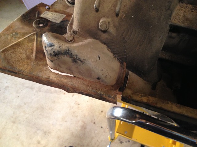

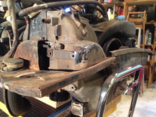

In the middle of a teardown and cleaning up the tin and stuff... I have a '73 1.7 with A/C and one of the tin pieces fits kind of goofy. I want to straighten it out before painting, but I'm not sure how it's supposed to fit... I've attached a few pics showing different angles of it before removal. I'm wondering if that indented part where the screw is on top is supposed to be dented in like that or perfectly domed? It doesn't seem like that rise is tall enough to allow the flat part of the tin to sit flat. In the 3rd pic, you can see where I hammered it out and it seems a little better, but I was hoping someone was familiar with this tin piece and could confirm what it's supposed to look like. Any reference pics of it?

It should be flat. It looks quite different from other 914's I've had with AC. The way the tin is cut is what I'm referring to.

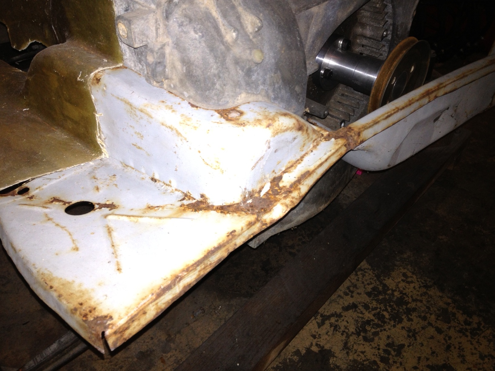

Awesome pic! Didn't even cross my mind that mine was cut out on that one side like that. That's where my big steel bracket thing is bolted to and goes up and lays flat on top (a big "L" shaped piece that goes up the side and lays flat on top of the housing.
You can see in my second pic the "seam" on that piece appears to have been cut or broken at some point. Should I weld that seam closed?
Yup, weld away.
