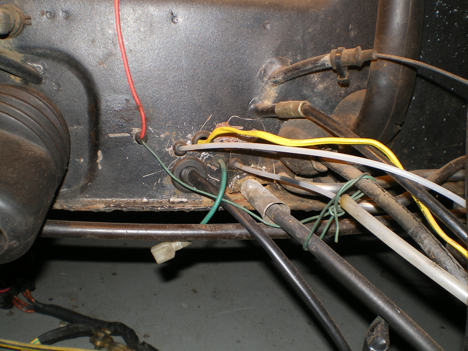

Drill a hole and use a grommet. I'll post a pic tonight if no one else has by then.
EDIT: Here ya go. As you can see I've violated this one many times. There is a ton of room there. Remove the access cover on top of the tunnel by the firewall. Look down there with a lite and mirror if necessary. Just try to avoid the area that is doubled. If you drill 1/2 single layer and 1/2 double layer your grommet won't seal as well. As far as your AFR goesyou will need to split a grommet or use one grommet within another and blk silicone to seal. The connector on the cable is larger than the cable it comes off of.

And 76-914.... which of the many wires is the AFR cable?? is it the one that looks like it has the grommet with in another grommet loosely, on the left side of that cluster f**k of cables, haha.

That's it before the black silicone to glue it in place.
