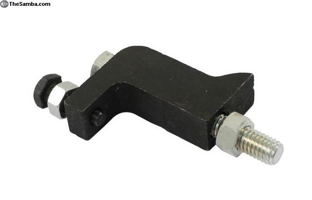

Mark Henry
There is a cheap tool you can get, any VW bug shop should have it.
It bolts to the case and just uses a threaded screw and your feeler gauges.

QUOTE(Mark Henry @ Feb 12 2013, 01:30 PM) *
IPB Image
This looks to be the ticket!
IPB Image
