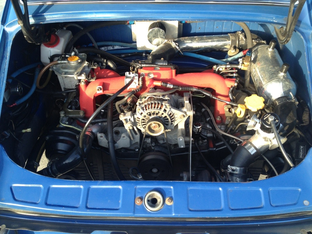

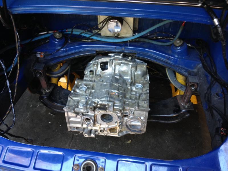

Hey guys, I know its not a 914 but hoping to share info and request help on my project since the 912 board is fairly devoid of these conversions.

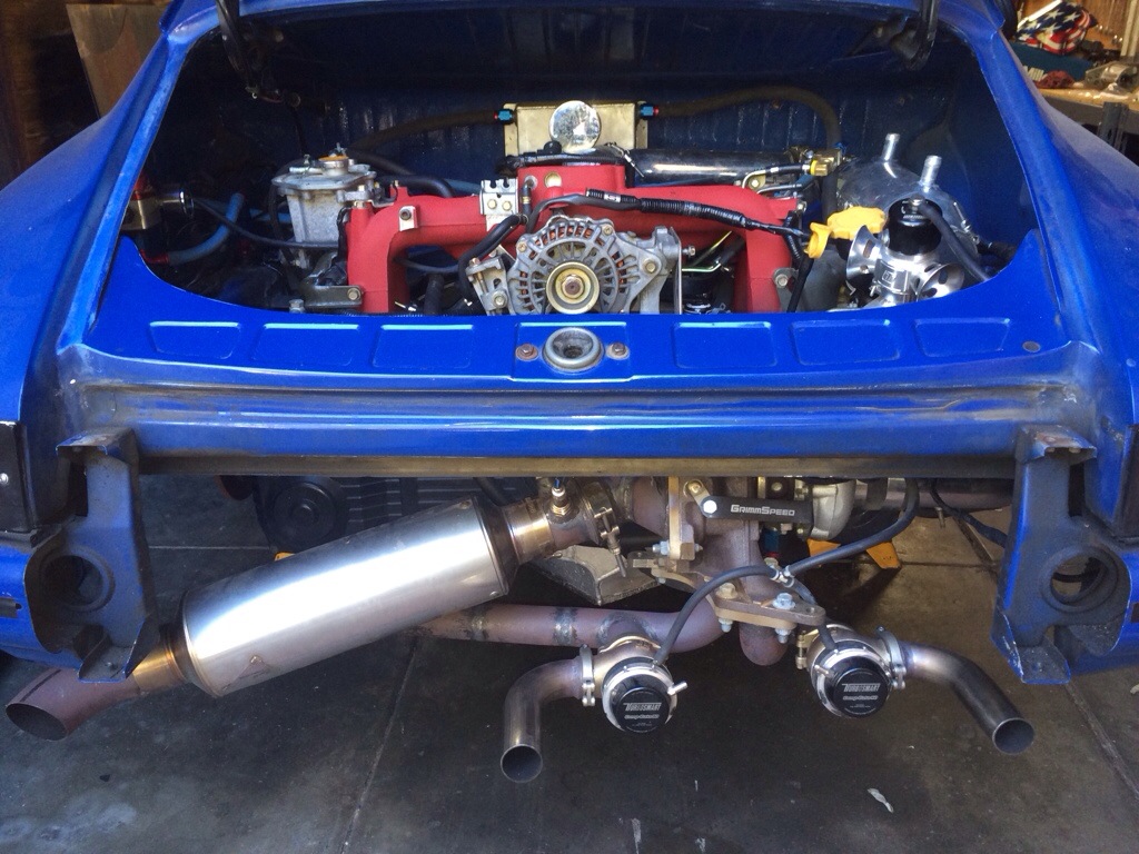

car is a '68 912 and last year I installed a 2005 STi Spec-C JDM motor and running the stock ecu and stripped down harness. I used an adapter plate and adapter flywheel and stage 2 Sach pp/clutch.
for exhaust i used a pair of 2 into 1 header stubs that outback makes and brought each bank up to a turbo flange, then exhausted it to Coast Fabrication muffler. used twin turbosmart EWG with a locked out IWG.
on the inlet side, ran it thru the stock MAF thru the turbo to a water/air intercooler and a turbosmart BOV

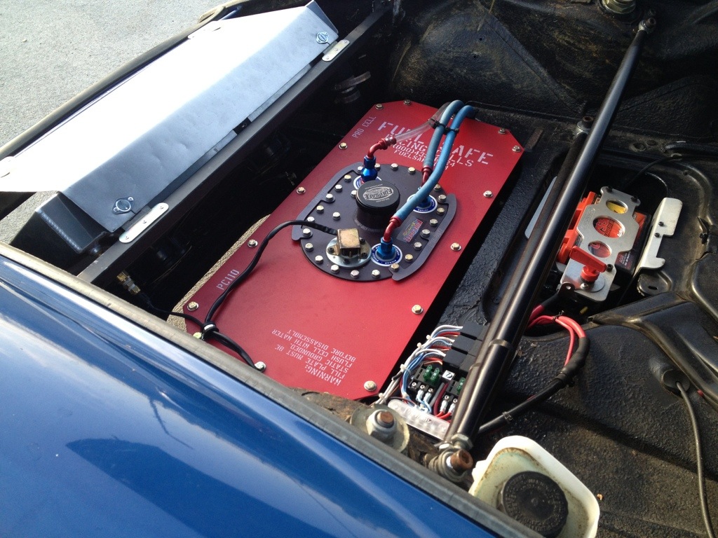

up front im running a ron davis radiator and a fuel safe fuel cell with the mostly bent tubing run under the car just inboard of the pinch seam, similar to how the factory ran the oil cooler lines and short sections of 1.25" hose connecting.

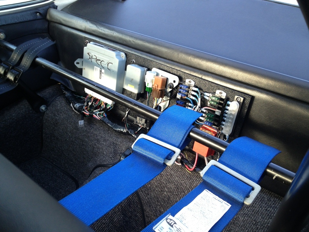

with the stock ecu ive have the stock tach sent in to North Hollywood Speedo to modify to take the ecu tach signal and redo the face to 8k redline
the rest of the car is set up with 82SC front end and fresh Bilsteins and elephant polybronze bushes all around and lowered ride height.
So that was phase one and been running her for the last 4 months or so. drove from SF area to Santa cruz and if i kept the revs at 3k then got 30 mpg but was only doing like 60 mph. if i increased to 75mph then 3400rpm and 24mpg. so i decided to go down this subaru path yet further and scored and 2010 WRX 5 speed that only had 20k miles on it. I am swapping in a reveres ring and pinion and will utilize 930 adapter flanges.

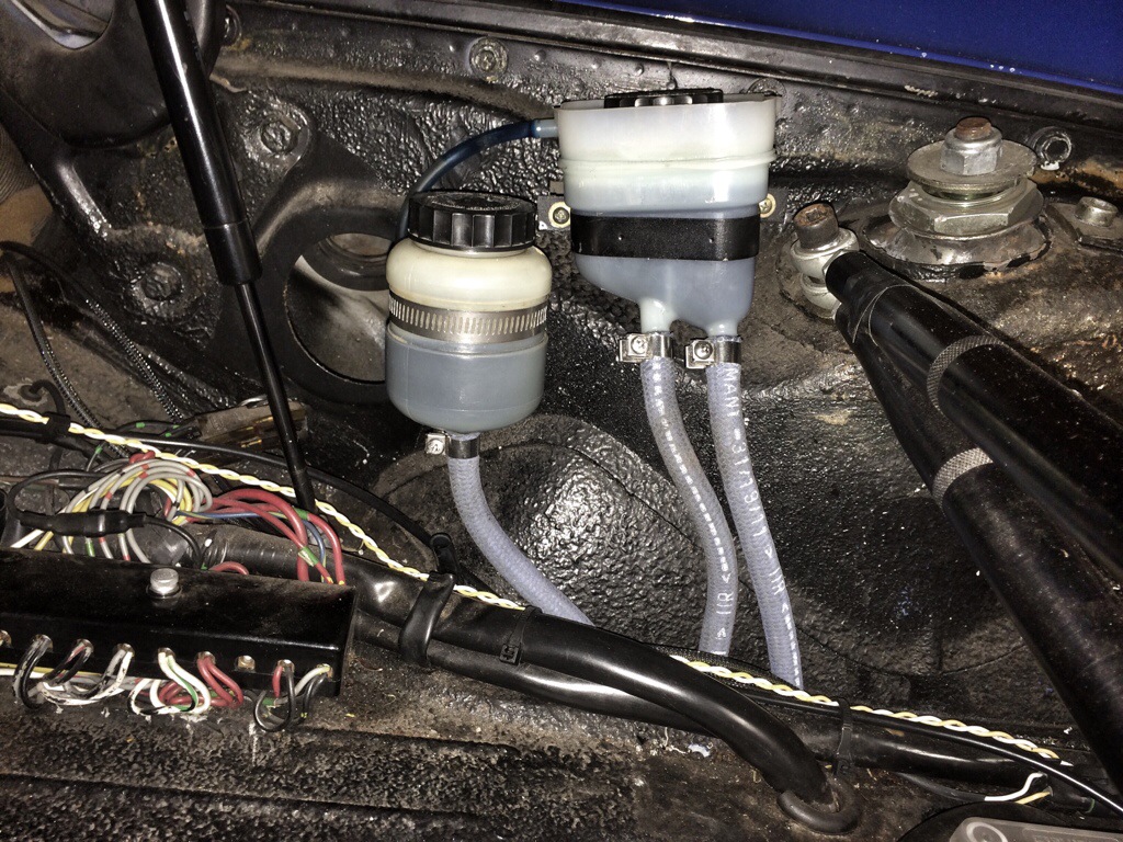

I have the Tilton pedals in mine, using short M/C's for both clutch and brake, but damned if I can remember which right now. It'll come to me. There's more information in my build thread, link in my sig. Clutch works great, but the larger brake size leaves me with way more pedal pressure than stock.
Edit: I remember now, Howe M/C's, the shortest out there, so they'd fit in the footwell without cutting any metal and still provide sufficient (max) leg room. I did use a nicely bent banjo fitting on the slave cylinder for clearance. It's been a while though, and don't remember right now where it came from, but again, it's mentioned in my build thread.
jpnovak

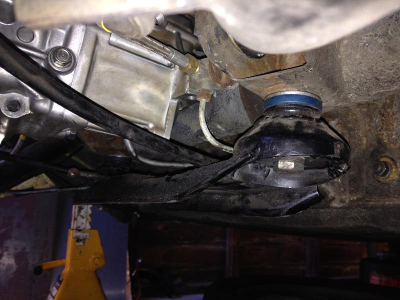

Ron, I used a Honda application for my MC. drilled a secondary hole next to the brake booster, built a 90 deg tab and welded it to the floor in the steering tunnel. Let me check the notes and see what the part number is. I had to make a connection rod that went from the stock cable trunion to the MC operating "pin".
The biggest problem I see with this conversion is the location of the slave cylinder. It is top center on the transmission. I do not think it will clear the center tunnel or more importantly the rear suspension cross member/shock tower. It sticks up quite high. Since I cut the rear truck out of the 914 there are no clearance issues.
Is the 901 showing problems yet
a914622
QUOTE(jpnovak @ Feb 16 2013, 06:39 PM) *
Actually the wrx slave cylinder sits lower and behind the clutch rod. It is the same pull to release as the 915 porsche boxes. The rest of the sbarus use a push style clutch and the slave mounts in front of the arm.

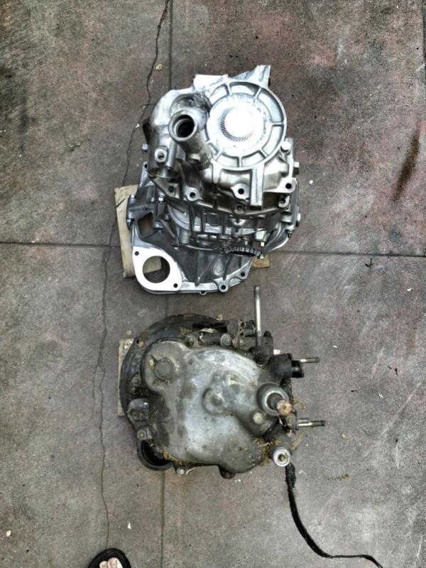

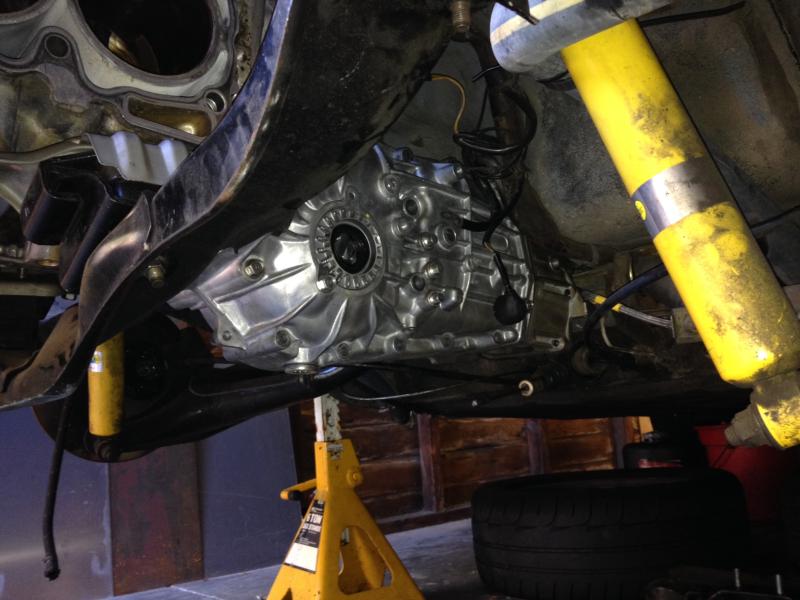

d914: yep, ive seen the video of how the Todd at subaru gears cuts down the case to make it essentially like a 915 so it turns out like this
IPB Image
ill look into the sub cv to 930 mating but may end up being close to same price to cut down the 930 axle/respline and get a cv for the tranny. good option though thanks

-The stock slave is bolted to the top and is a push style but i was thinking of dumping that slave for a Wilwood and mount it as a pull from the other direction like DBCooper

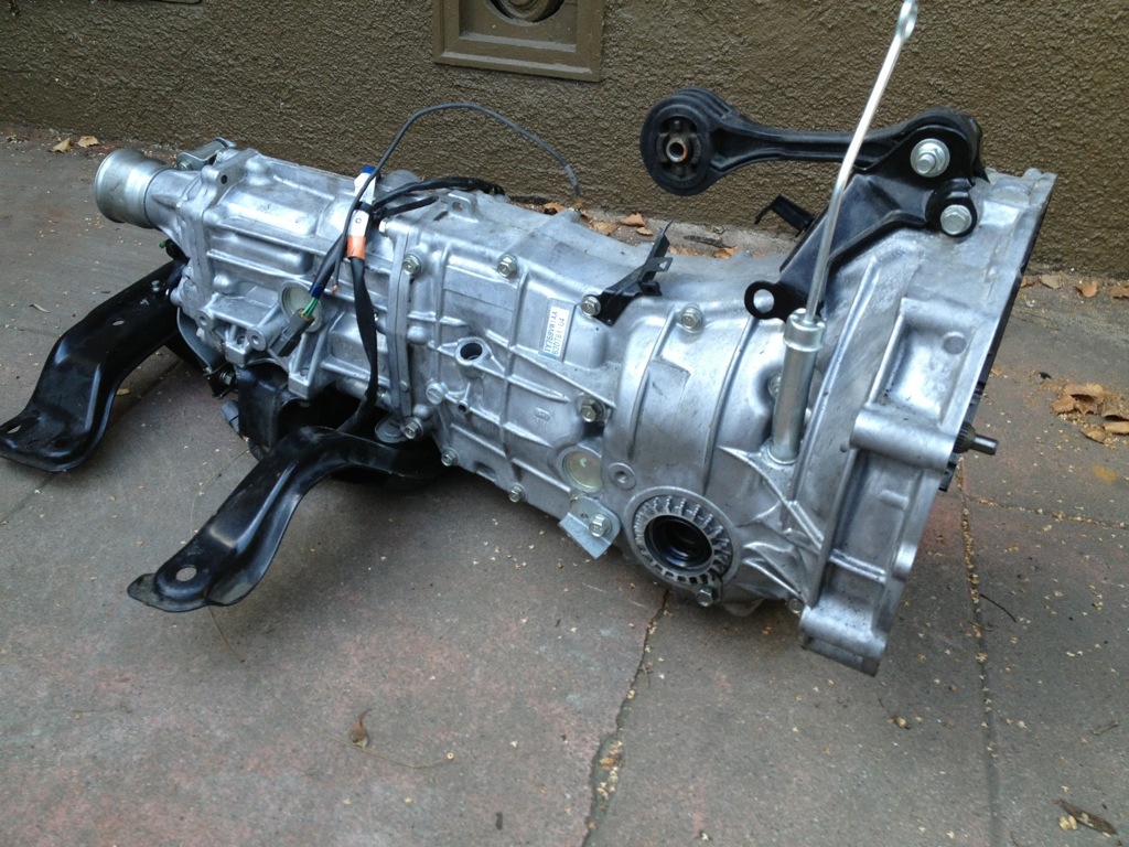

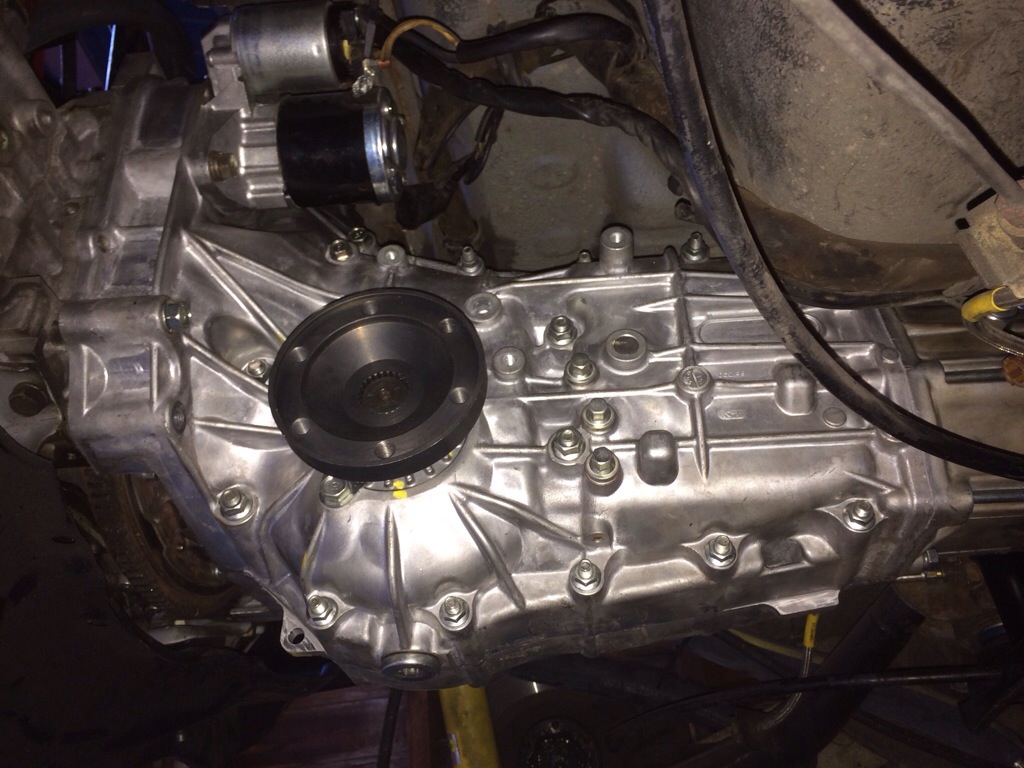

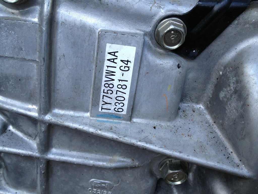

the 2010 wrx is a ty758 and the clutch slave is mounted to the top so its facing the transmission bell housing to "Push"
here is a shot of the tranny but i dont think you can see where it mounts. i'll try to get a better pic later

here is a video identifying some of the differences between the pull vs push type release. in 2008-2010, subaru switch the wrx 5 speed in a few ways.
http://www.youtube.com/watch?feature=playe...p;v=gJ_96JZhJmI
1) from a pull type to a push like the 2nd tranny in the video
2) the output axle in the wrx in the video ty754 has the axle attached to the diff in side but in the 2008 to the 2010 the small stub axle is part of the CV assembly so it just slides in. to use the subarugears adapter flanges, the small stub axle from the earlier needs to be installed into the diff.

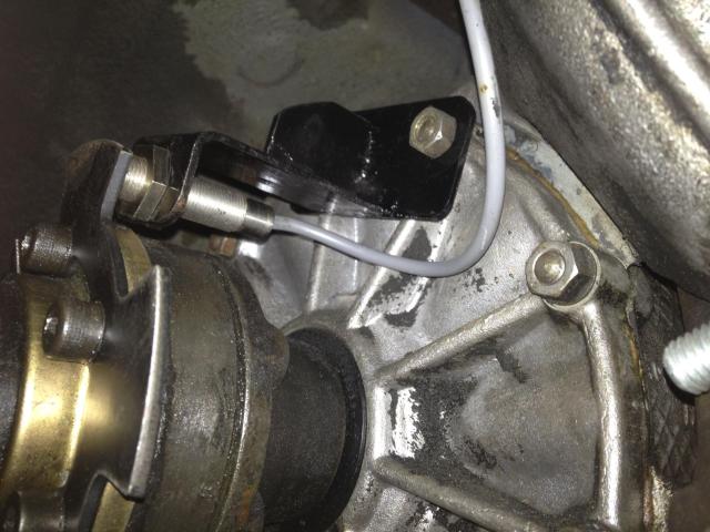

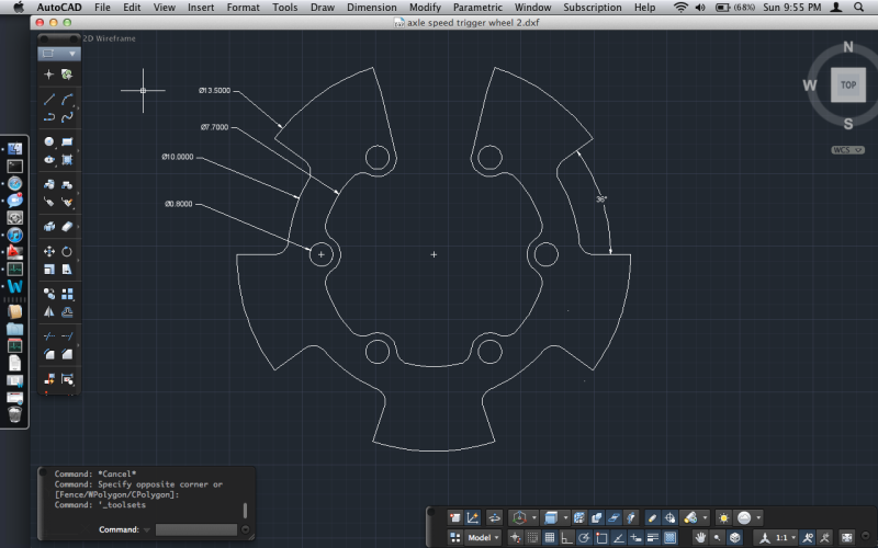

3) the speed sensor was moved off of the transmission and is on the hub at the wheel with a trigger wheel/sensor located there. so i'll just run the same set up i am running now with a trigger wheel bolted to the inboard CV along with the vr sensor

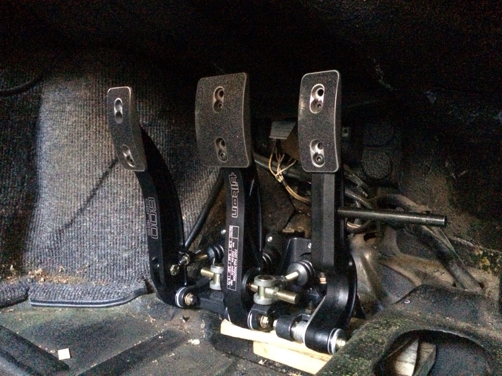

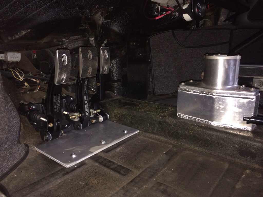

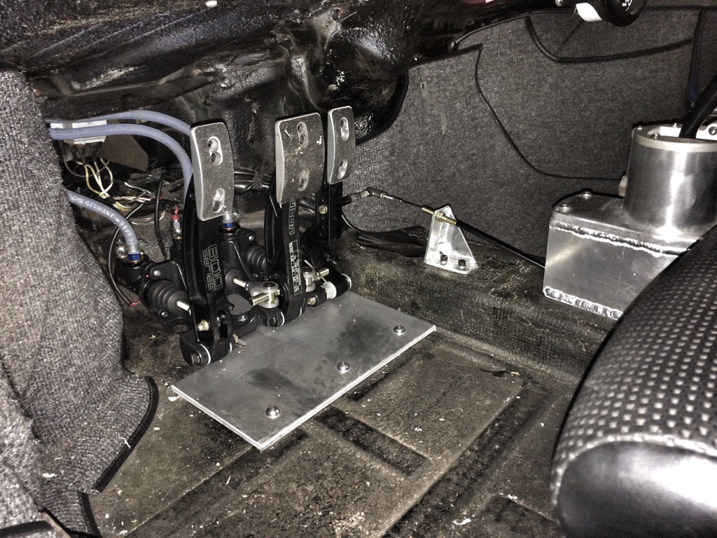

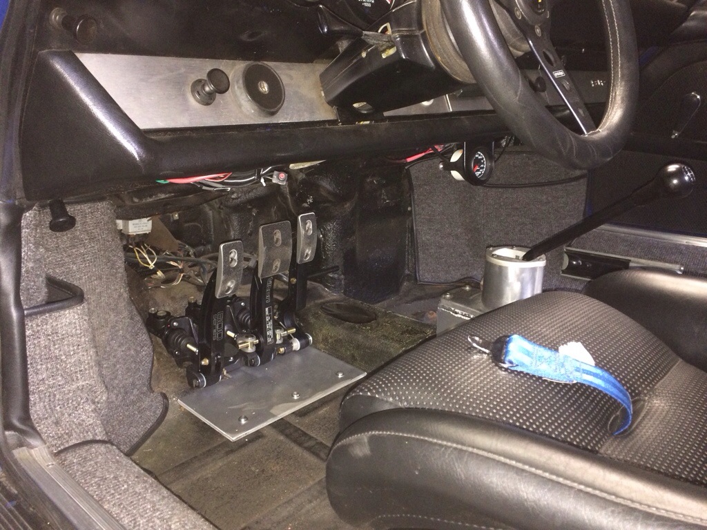

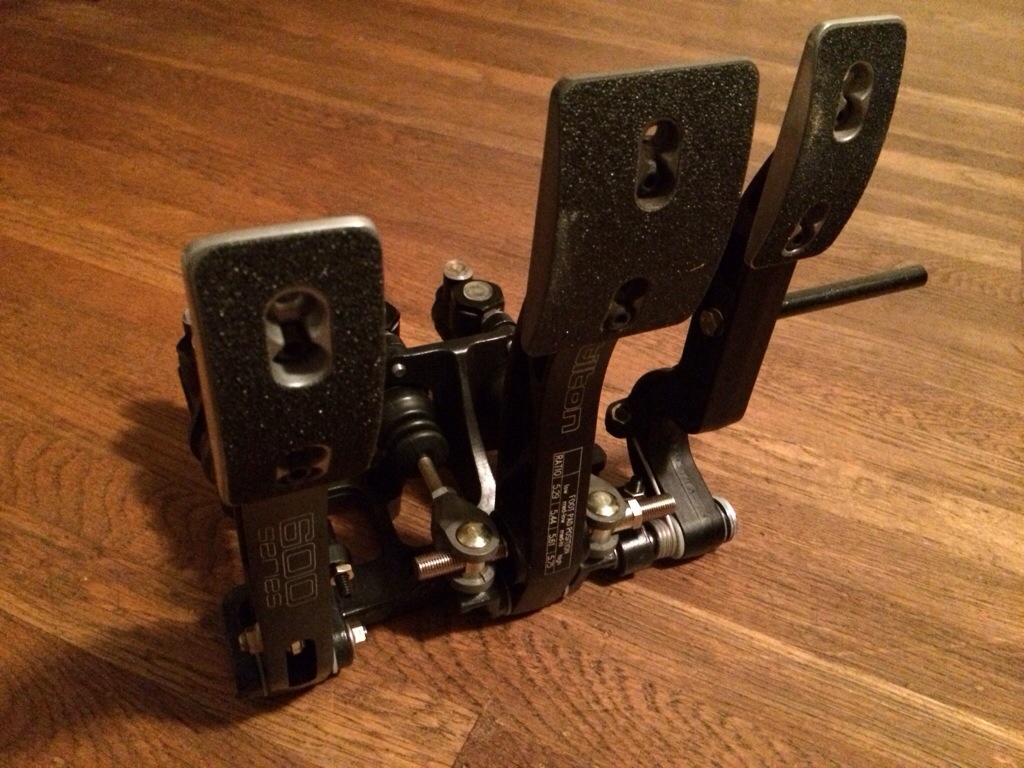

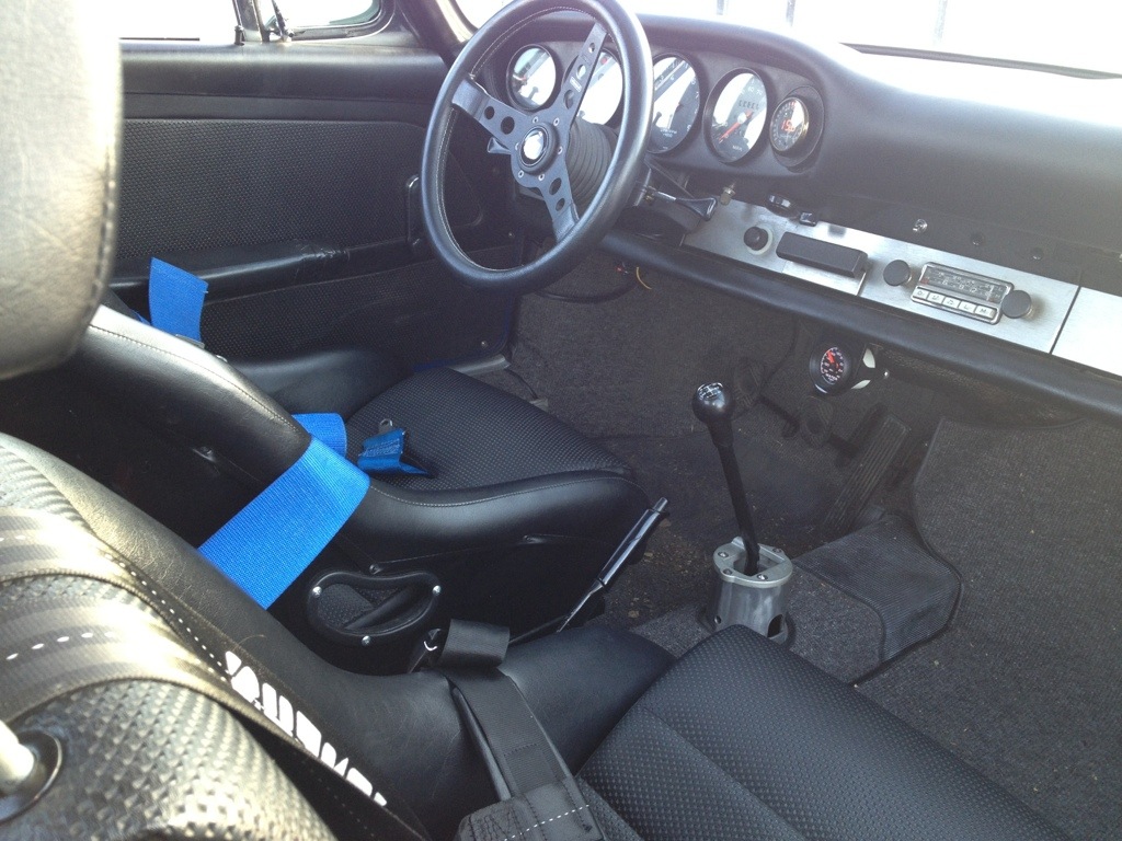

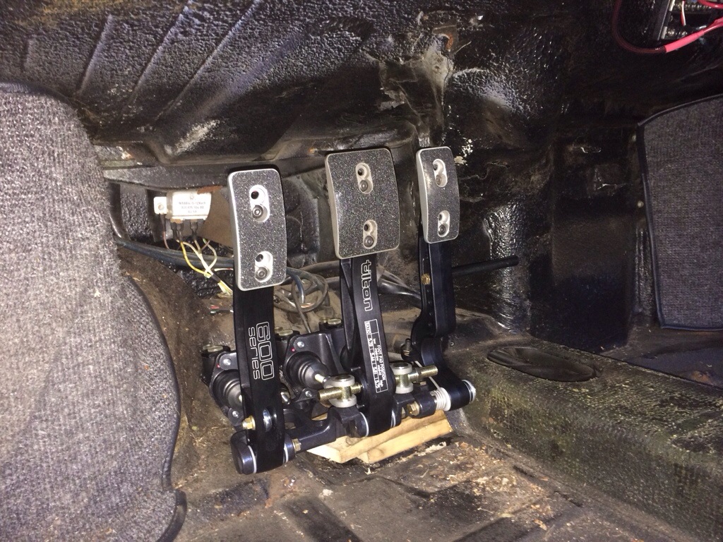

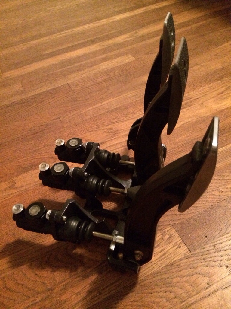

here is the pedal cluster that DBCooper is using that I'm considering. looks like i wouldnt have to do any cutting in my 912, just do the same pedal board and move it far to right so brake and gas are in the same relative position
IPB Image
here is britains
IPB Image
Britain Smith
Is that the same speed sensor I am using Ron? They work great.
The pedal assembly works good as well. I use tilton master cylinders for the brakes and a Howe Racing one for the clutch.

Yep same sensor!
I need to get in pedal box area and make take some measurements and see how it will fit. I know it will be different and take some getting use to im sure.

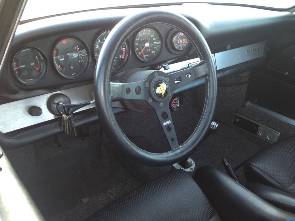

thanks for the kind words. i gutted the non functioning clock. I gently pried from the back of the black bezel ring and it came off. removed the glass, removed the guts then used a scrap piece of black textured ABS plastic to fit within the bezel and mounted the ARF gauge to it. ran the wires thru the back of the clock body. reinstalled the bezel to the clock body and recrimped the bezel in place. then the clock body just mounted as it did before. cost = $0.00 welder.gif

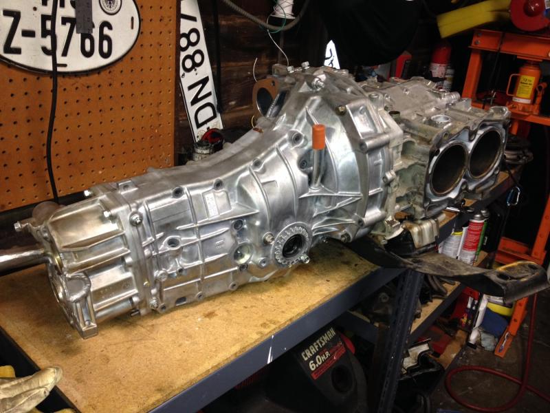

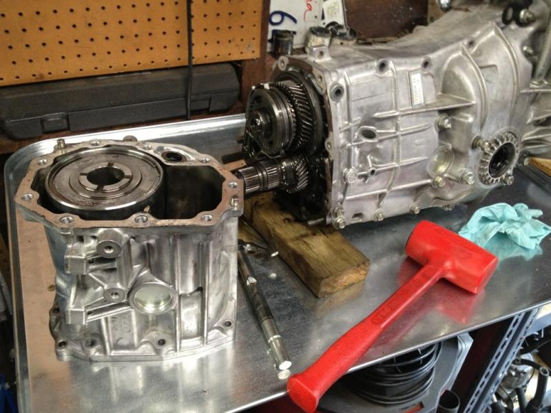

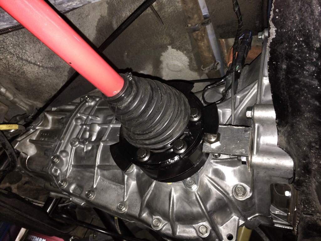

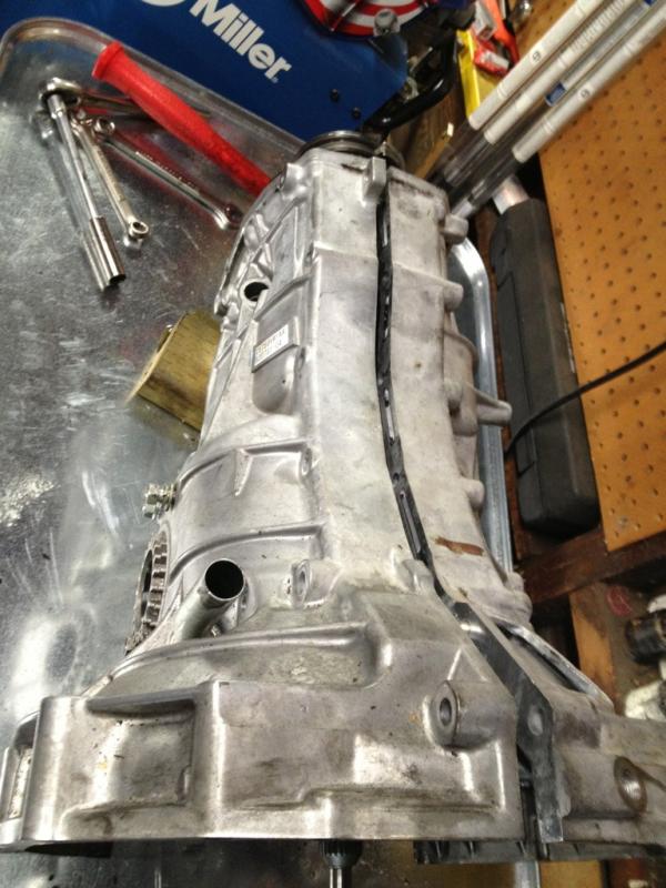

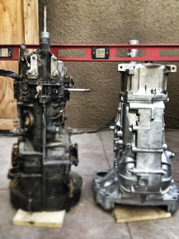

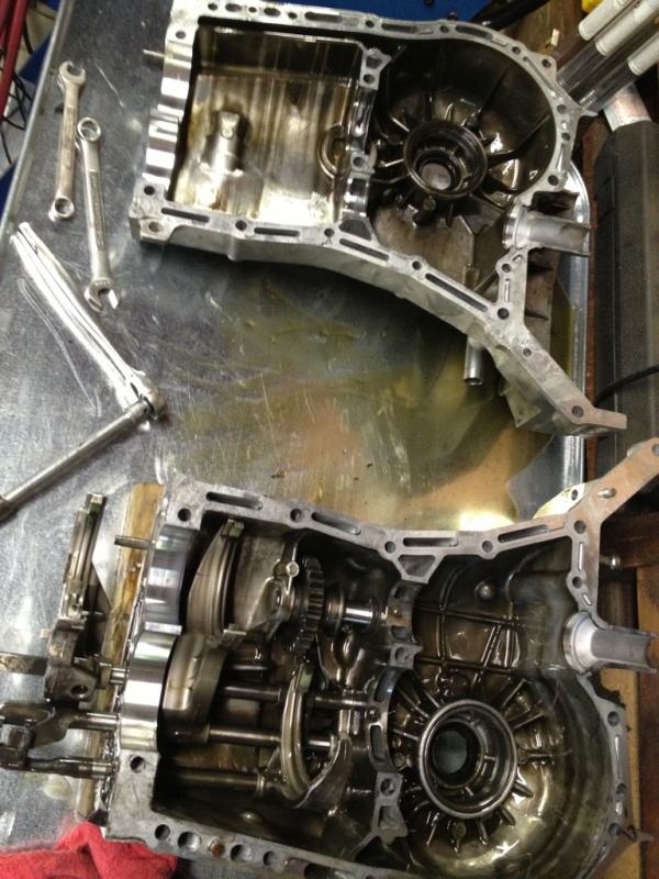

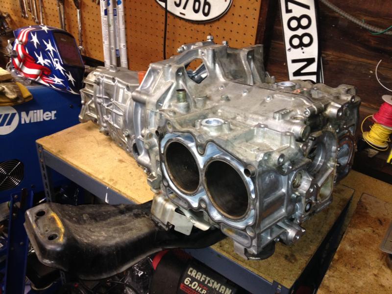

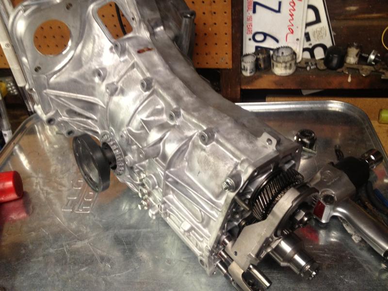

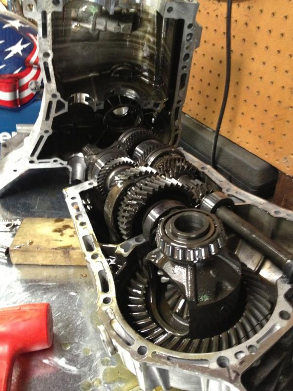

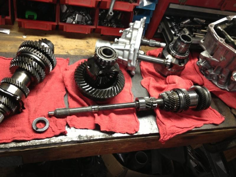

Time to start on the TY758 WRX tranny. Here are a few shots taken during the tear down, pretty simple, lots of case through bolts, only 4 internal bolts, a few love taps and she opened right up :wink: . Btw, the new LSD pictured is a factory JDM unit and will receive the Subarugears reverse ring and pinion and outside will get a 930 to Subaru flange.
IPB Image
IPB Image
IPB Image
IPB Image
IPB Image
IPB Image
IPB Image

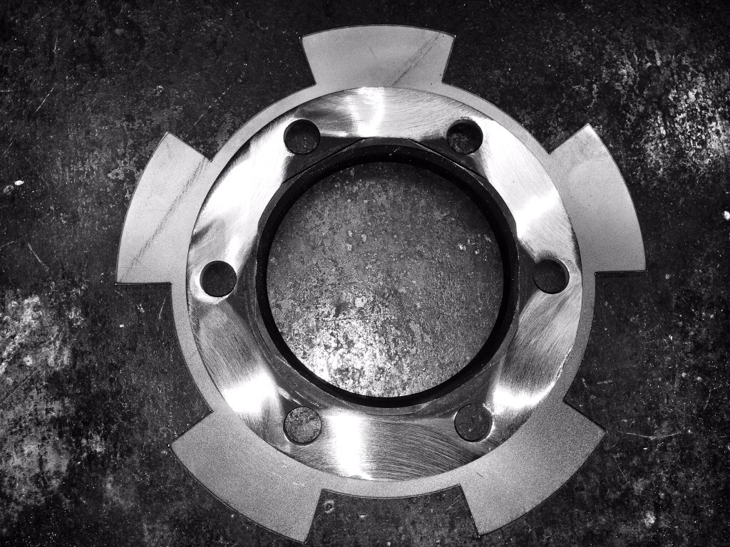

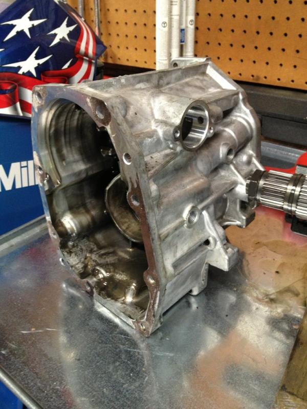

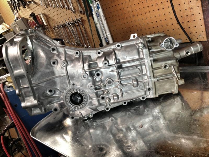

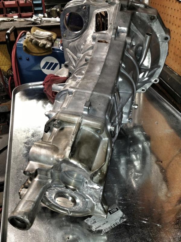

Finished up trimming the new nose cone and plugging it up. Ready for assembly. I wanted to compare my spare 4 speed 901 before I gave up on the 901. It nearly identical!!! Overall, Bell hosing face to tip of shift rod housing 73.5 vs 74.0 cm (Porsche to Subaru respectively), bell housing face to flange center 16.5 vs 20 cm (Porsche to Subaru respectively). My only fear is the actual position on the shift rod at 10 o’clock vs 6 but I think I'll have it enter above the shift tunnel and have the shift rod above the tunnel as well and make raised platform for the 915/wevo shift tower sit on.
IPB Image
IPB Image
IPB Image
IPB Image

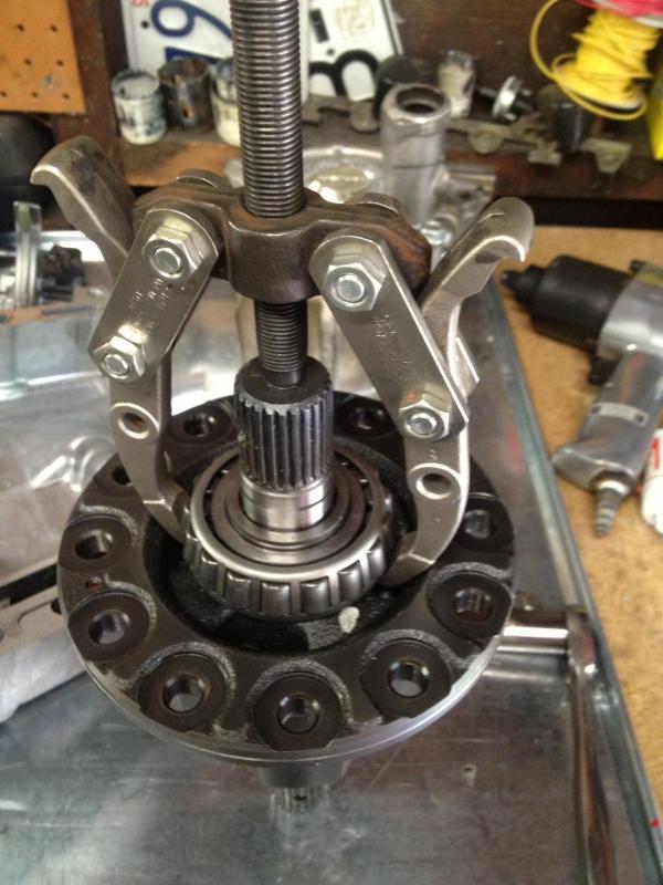

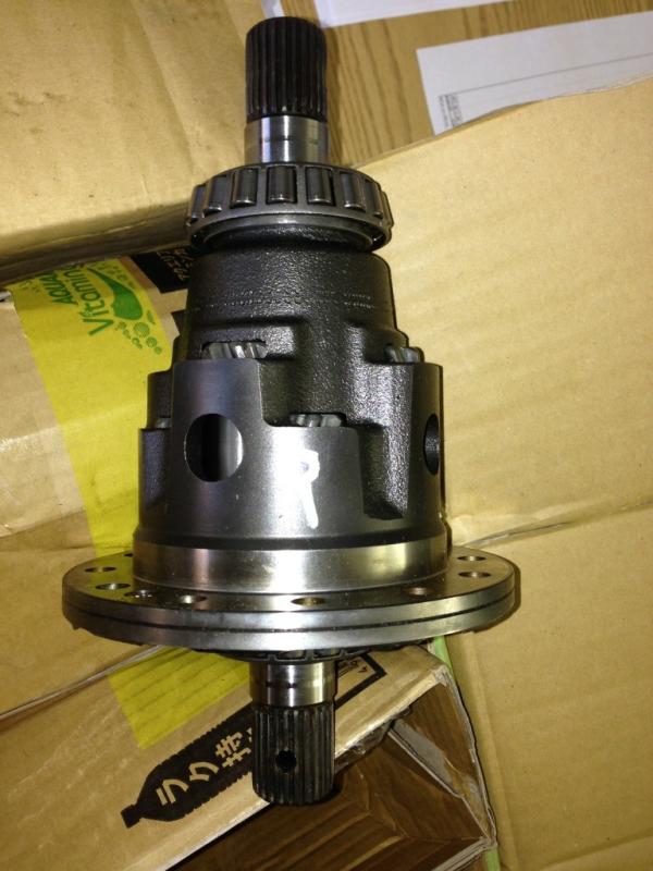

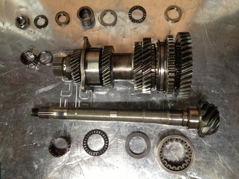

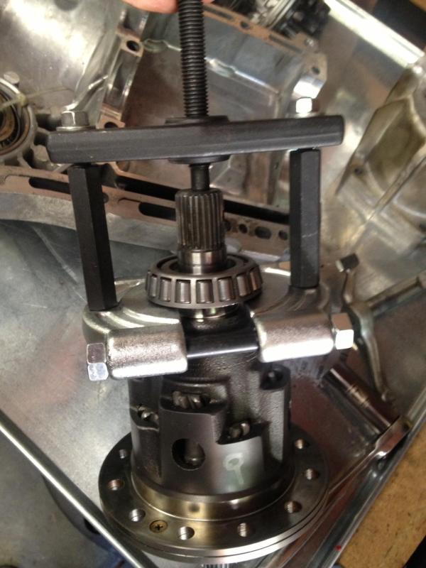

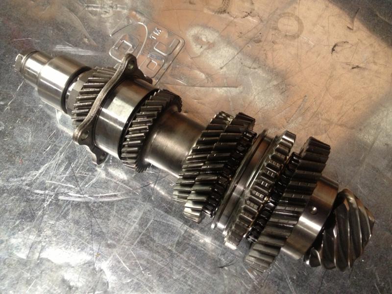

got a chance to start pulling the bearing off the open diff and install them on the LSD keep the matched bearing/race together.
IPB Image
IPB Image

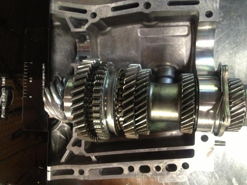

then pull the gears and bearings off the original pinion and install it on the new subarugears pinion
IPB Image
IPB Image

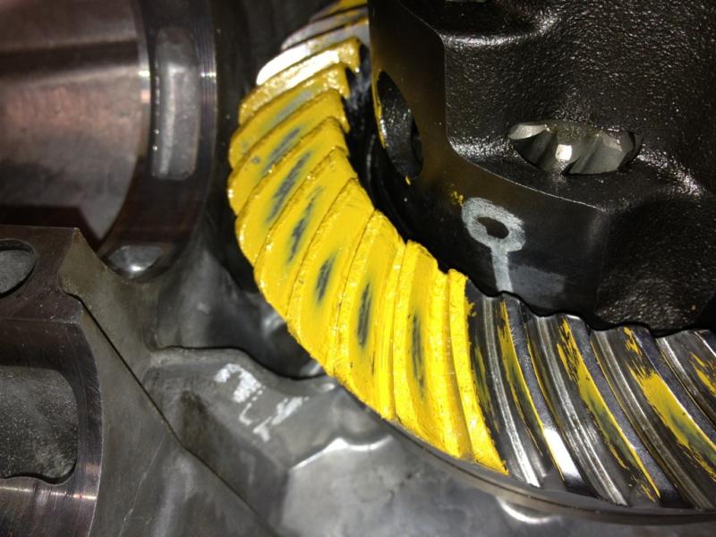

bolted the pinion assembly to the case and used the pinion depth tool and with the original 2 shims, nearly perfect. i'll have to get some gear marking compound to check the pattern this week and install the seals/gaskets
IPB Image
IPB Image

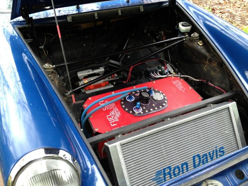

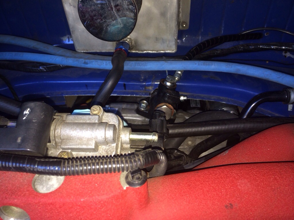

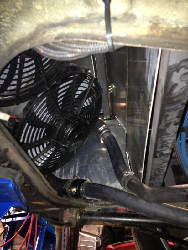

So, radiator mounted up front and using the 912 gas tank opening for the exhaust. here was an early stage before i enclosed it and after i put in the fuel cell.
IPB Image
IPB Image

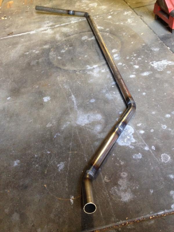

i tigged up some 1.25" tubing with mandel bends to run forward along the pinch seam and connect to motor/rad via the same gates style hose you guys use.
IPB Image
there are 2 spal 14" fans drawing air in via sealed rear mound. this was a complete unit from Ron Davis. the stock ecu control each fan to temps and load situations i selected.
as a note, you NEED to have a bleed line running from the radiator back to the turbo tank otherwise air will be trap in this style of a set up. i am running a -4AN hose front to back for this.

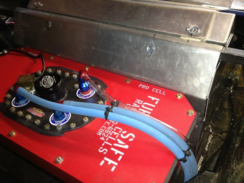

as a side note, that 10 gal fuel safe cell fit perfect and i was able to adapt the stock sending unit (had to trim it down and re solder some internal wires and works with the stock gas gauge.

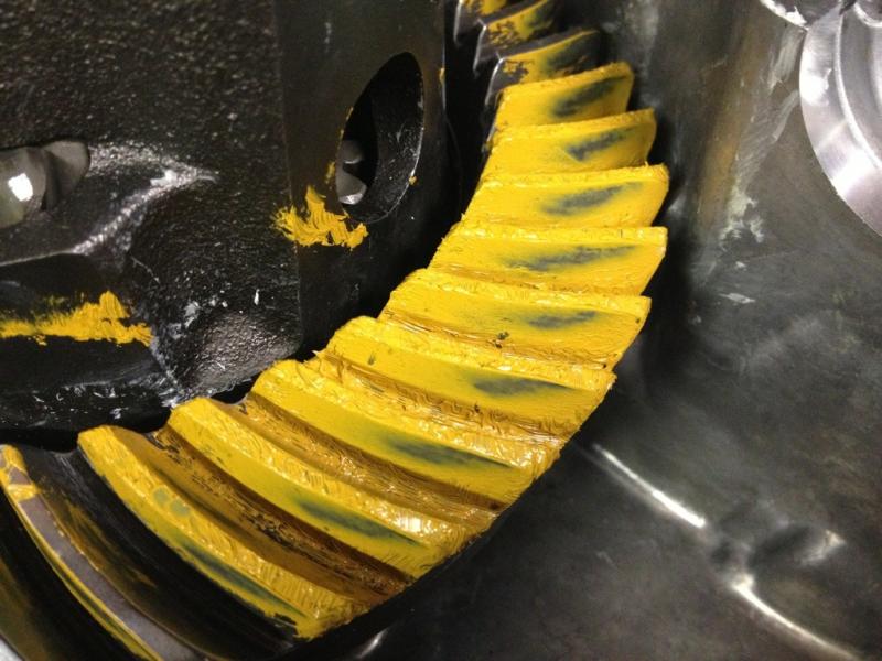

I used a pinion depth tool and its spot on. I marked it up and it seems like a slightly thinner shim may be called for. Thoughts?
IPB Image
IPB Image
IPB Image

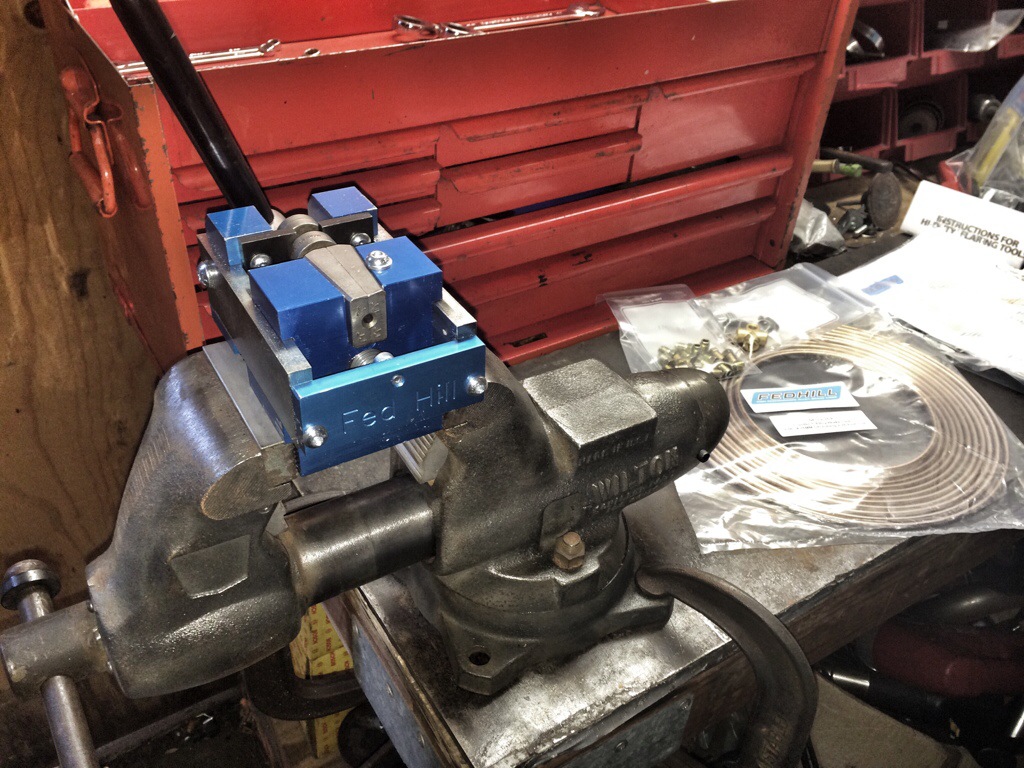

got wilwood clutch master and slave and will fab on brackets and run the hydraulic line.

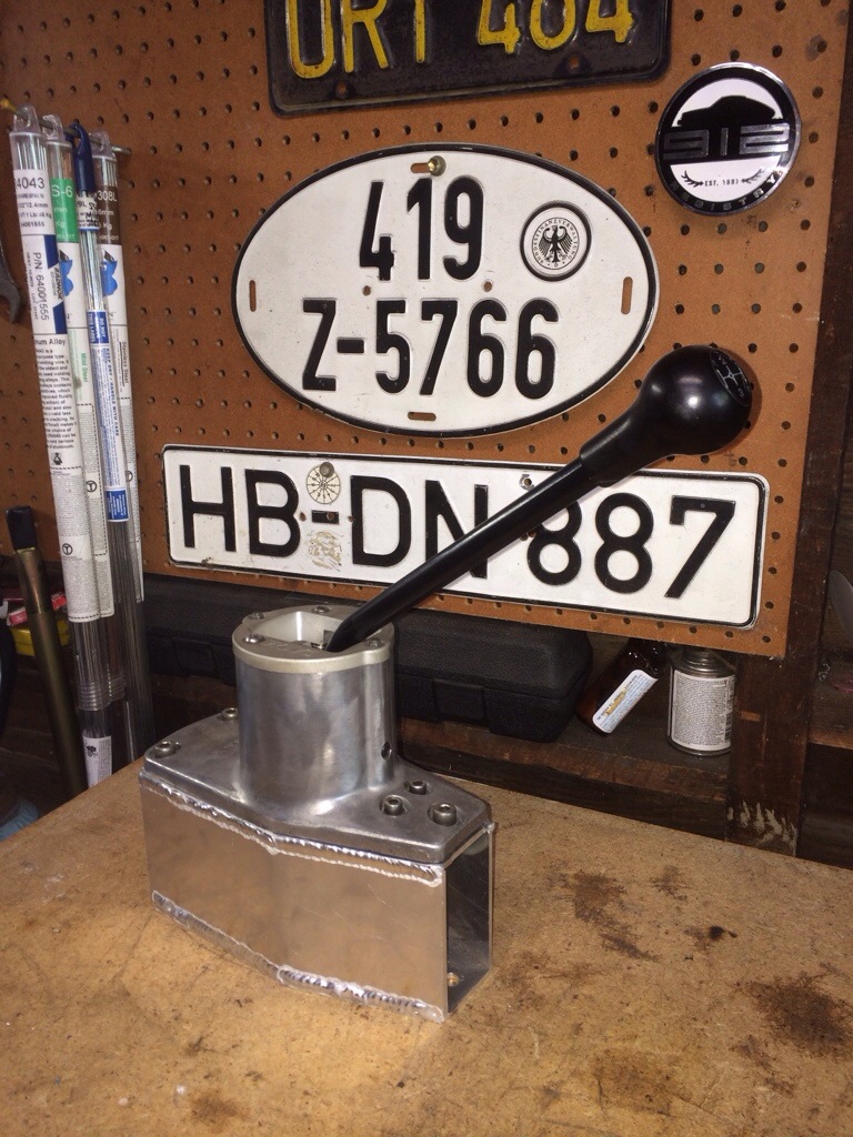

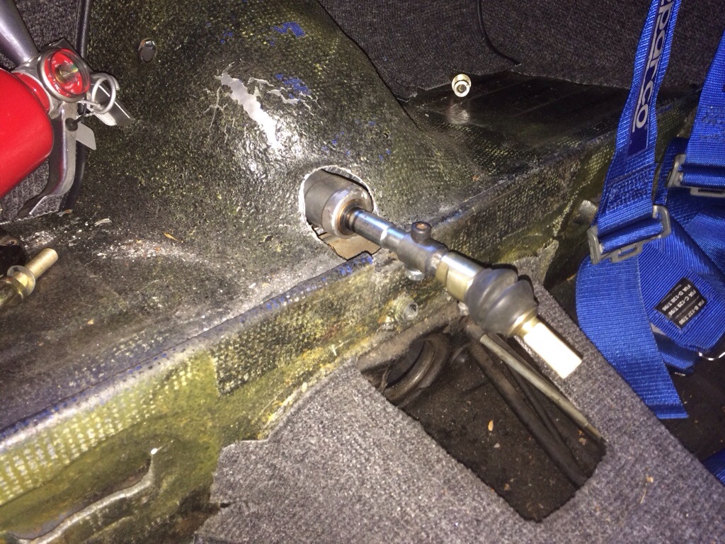

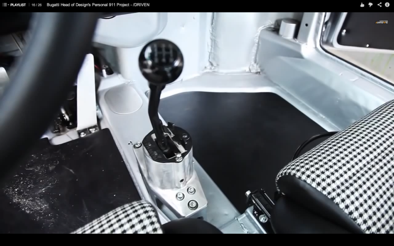

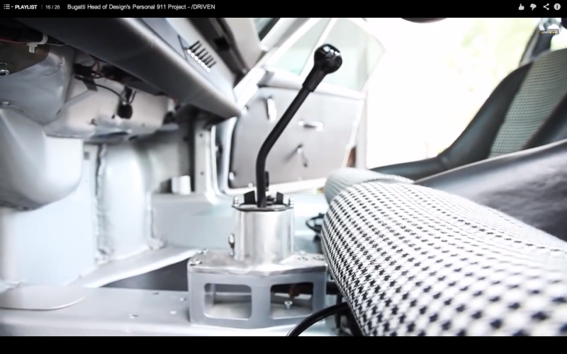

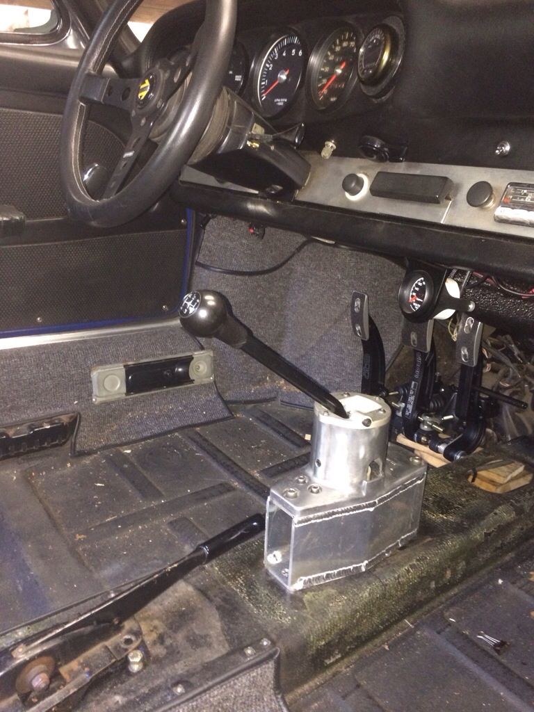

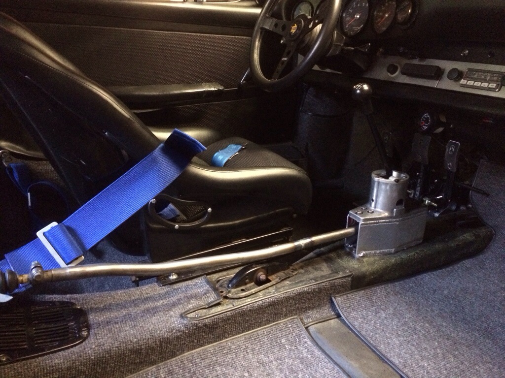

finally since i cant run the cable shift as you guys do, will have to run something like this but off set to pass side and hopefully clear the ebrake
IPB Image
IPB Image
jpnovak
Ron, Just run a Hargett or something similar to raise the shift rod above the ebrake assembly.

they hargett is bank and from what ive read is a pita to still access the ebrake. i already have my wevo shifter and coupler so id rather note fork out more dough, the above elevated platform should be simple to cut and tig up and call it a day biggrin.gif

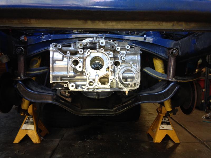

got the trans mount mocked up to use to oem unit. figured out the mounting for the Wilwood hydraulic slave and will hopefully get the fab up a mounting bracket for the Wilwood clutch slave to work with the stock pedal as other teeners have documented.

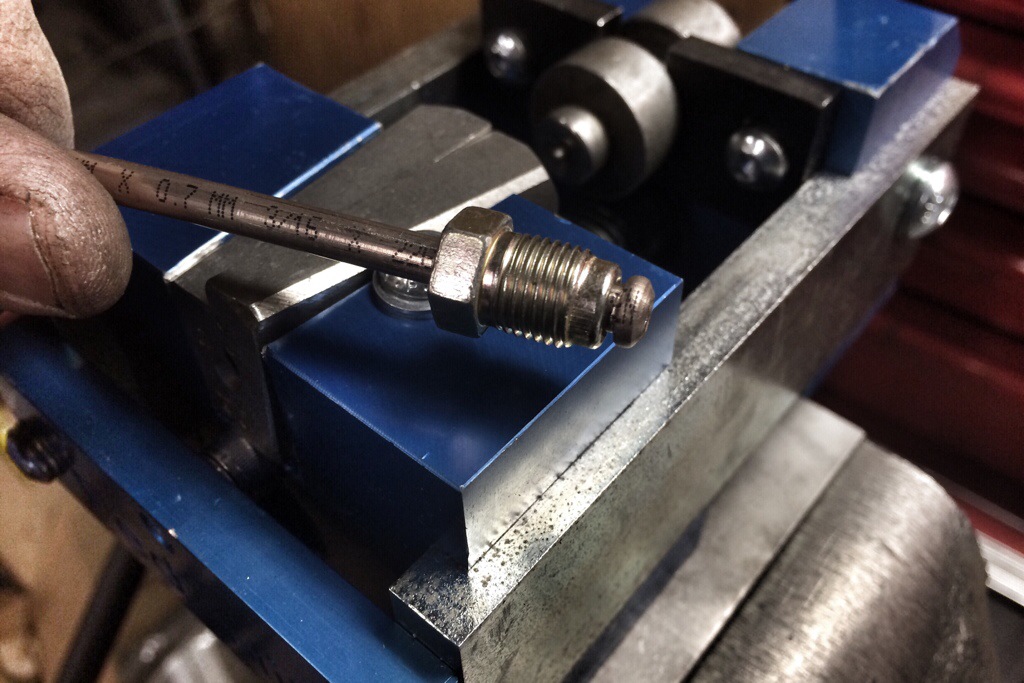

Received an order of OEM hardware to bolt the flywheel and pressure plate and clutch disc alignment tool as well as proper bolts for the transaxle to motor. Bolted everything together and slide everything back in place. Needed to trim here and there around the stock suby starter and for the stock suby clutch slave. Looks like she was born there. Made a little adapter to connect the Subaru shift rod to the Wevo shift coupler so I can use the Porsche shift rod (will likely need to be shortened slightly though). I’ll start on the pedestool for shift tower soon. Started in next project…new pedal cluster for hydraulic clutch and improved braking biasing. Need to make a run to get some material and start fabricating!
IPB Image
IPB Image
IPB Image
IPB Image
IPB Image
IPB Image
IPB Image
IPB Image
RonW
btw, if anyone is planning on putting a suby in their car and wants to keep their 901, ive got my conversion plate, conversion flywheel, and stage 2 clutch/pp for sale. <1000 miles of use, normally $1200, yours $900 obo +shipping and any pp fees.

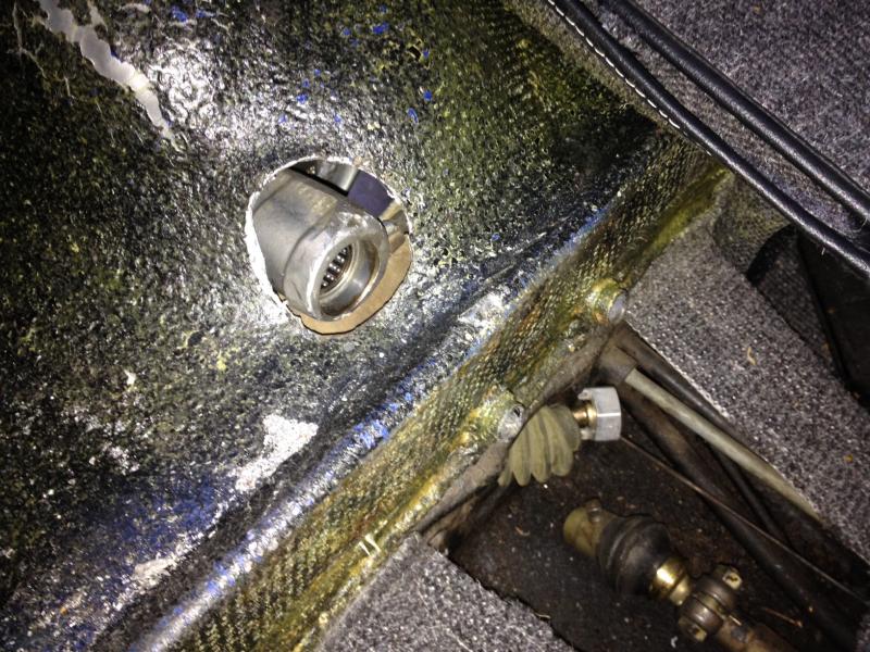

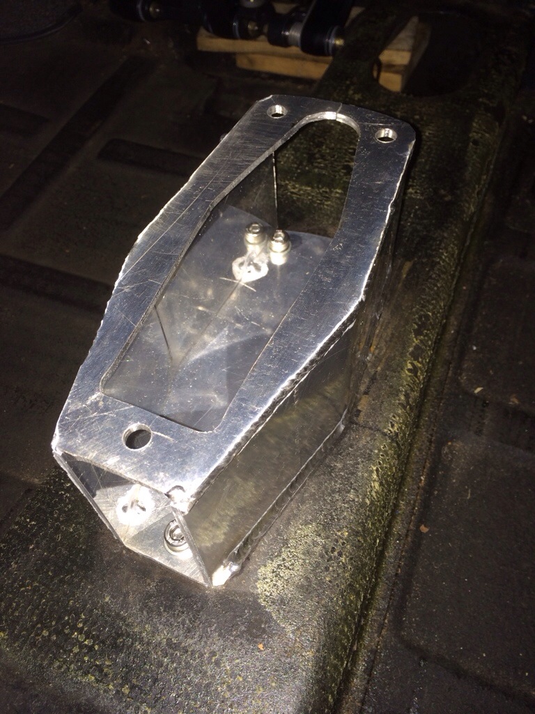

finished up the shifter pedestool, Tilton pedal cluster mount and modifying the shift rod. need to order 930 CV's then take measurements for 930 to 912 axles and place an order with Sway Away next week. i think the spline count and diameter of the 912 is the same as the 914 but not 100%
IPB Image
IPB Image
IPB Image
IPB Image
IPB Image
IPB Image
CptTripps
Man...I keep going back/forth about the Tilton pedal cluster. seems like it'd be a little cramped in the 914, but honestly the 912 looks even more cramped!
Great build man.
RonW
For reference, I am 5' 9" and medium build and in the same seat w the OEM pedals I felt most comfortable in the most forward position and w the Tilton, I'm one maybe two seatings back and don't feel cramped at all.

Nearly done plumbing and ordered a custom throttle cable from pegasus which i'll have to add an 8mm barrel to one end because they don't apply have them and i'll run it thru the tranny tunnel to a bracket and attach to the tilton.

been a while lurking and wrenching until i had anything to really substantial to post
-rented a brake flare tool from FedHillUSA and enough lines and fitting to essentially redo all the brakes lines. got the Cunifer stuff which is so easy to work with.
IPB Image
IPB Image
-got a set of VB911R rear calipers and Porterfields all around from Eric at PMB, things are sweet.

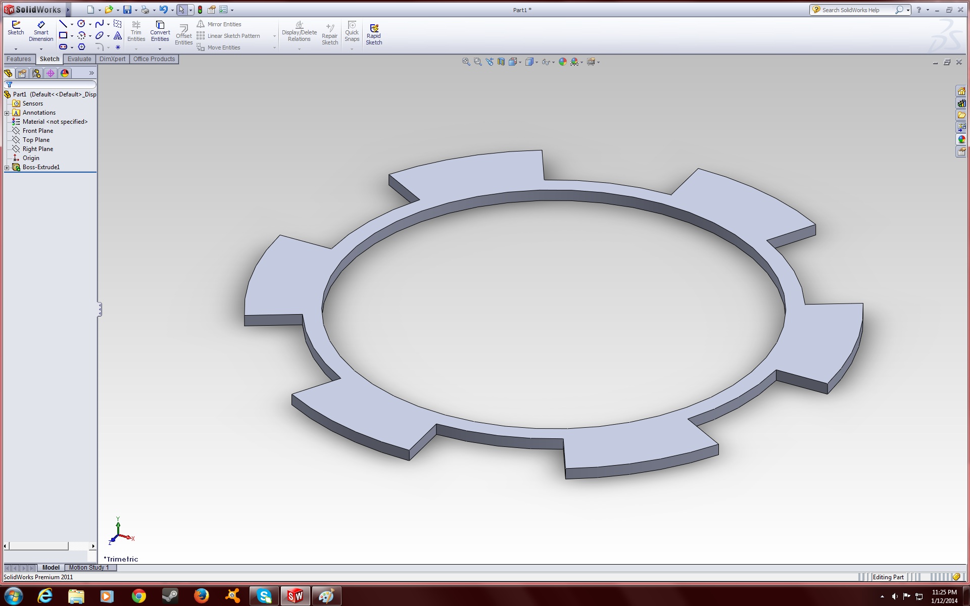

-designed a VSS trigger wheel since 2011 trans stopped using the internal one to the tranny of course... headbang.gif
IPB Image
-had Mario and the dubshop laser cut it for me and then tig it to the boot flange
IPB Image
-lubed and bolted the 930 CVs and Sway away axles up
IPB Image
-fund a early '66 single master reservior and ran 7mm hose to the masters
IPB Image
IPB Image
-filled the trans with Motul 300 75-90wt
-bleed the system and since wife and kids were out of town, no one around for a leg work out to pump for me so i got a Motive and love that thing.
-burped the coolant system, pita
-turn the key and she started up after her winter slumber biggrin.gif To my delight, clutch engaged, went into gear and pulled right out. but after a few feet i heard a POP and i stopped, pulled forward and POP again, i thought $HIT i broke a cv! what happened was some bubble wrap that the calipers were shipped in were under the car when i was pulling out happy11.gif
anyway, slow short jaunts around the hood and everything seems to be fine. gonna have to get use the the shift pattern now lol the trans shifts oh so buttery smooth!!! just a nudge and click, click, click.
at this point, the only thing i'll need to redo is the brake masters. they are too big of a bore and the pedal is just too heavy and almost no stroke. im currently running 13/16" and i think i'll drop it down to 7/10" and that will give me better pedal feel i think with the 48mm piston SC calipers fronts and 38mm piston caliper VB911R rears.
