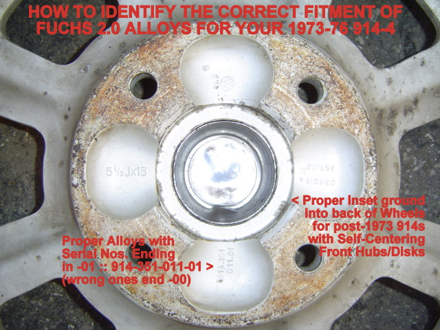

A much better solution is to have the back side of your wheels machined to accept the ring, as it's easier to R&R wheels/tires & change flats.
Machine like this pic....
Or get the proper wheels.
