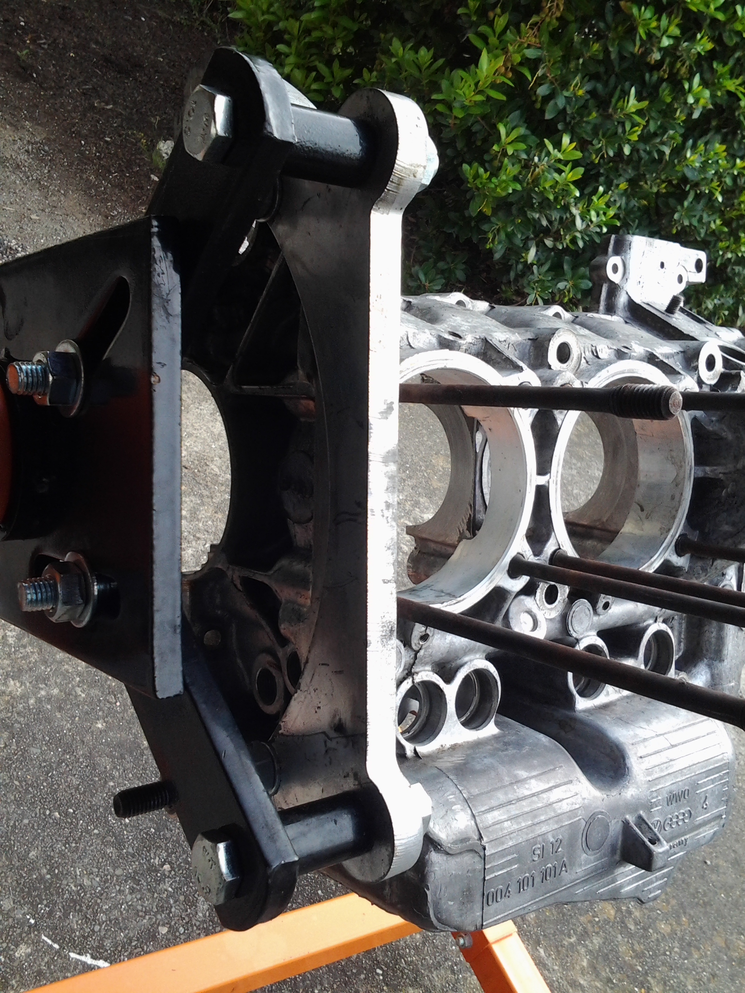

This is what I've got - an adapter for the regular stand.
Any way you go, make sure that the engine stands on the circular lip around the flywheel housing. The 2 arm stands that only hold the engine from the bolt holes are prone to fail and concentrate all the force in a single small location. I've seen a lighter bug engine case broken by the stand when one of the arms collapsed and the other broke the engine case hole that was connected to.

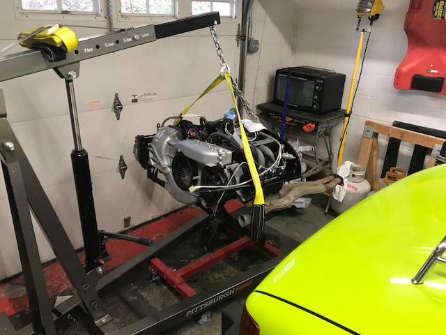

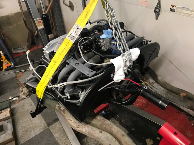

Remove the muffler and bracket, then separate the transmission. Bolt the yoke onto the engine. Then you can either lift it onto the stand with a few strong people...or use a small hoist/shop crane. I usually do it solo with a HF 1 ton folding crane, a webbed lifting strap and a length of chain. Slip the loops of a strap on each end of the engine bar, and wrap a length of chain around the top arm of the yoke. Adjust the length of chain so the hook is pretty much directly above the throttle body. Then loop it all directly through the crane hook or onto a carabiner first. A leveler helps, but not totally necessary if you go slow and guide the engine as you lift.
I have pics somewhere. Will look for them and post.
Be safe and good luck!
Edit: pics added...
Click to view attachment Click to view attachment

the engine hoist is ideal. but if you won't use it much, you can sink an eye bolt into the door frame above your garage door and use a cable come-a-long to lift the engine. I have used this method many times and it works just fine. Also worked for removing outboard engines and outdrives. lifting the garden tractor etc.
iankarr
Mar 3 2018, 09:06 AM
The come-along / ratcheting winch is a great idea! My crane folds so it doesn’t take up a lot of space. But the come along would be less of a dance trying to get the crane and stand close enough without their legs interfering. Thanks!
