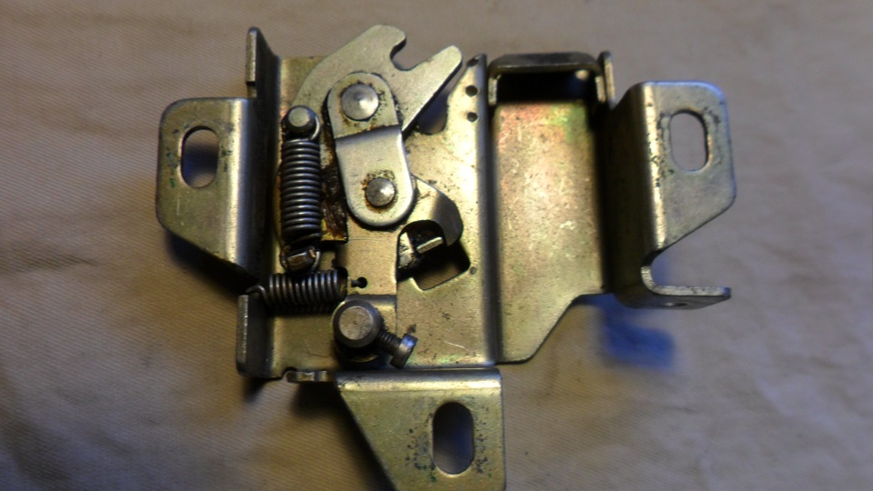

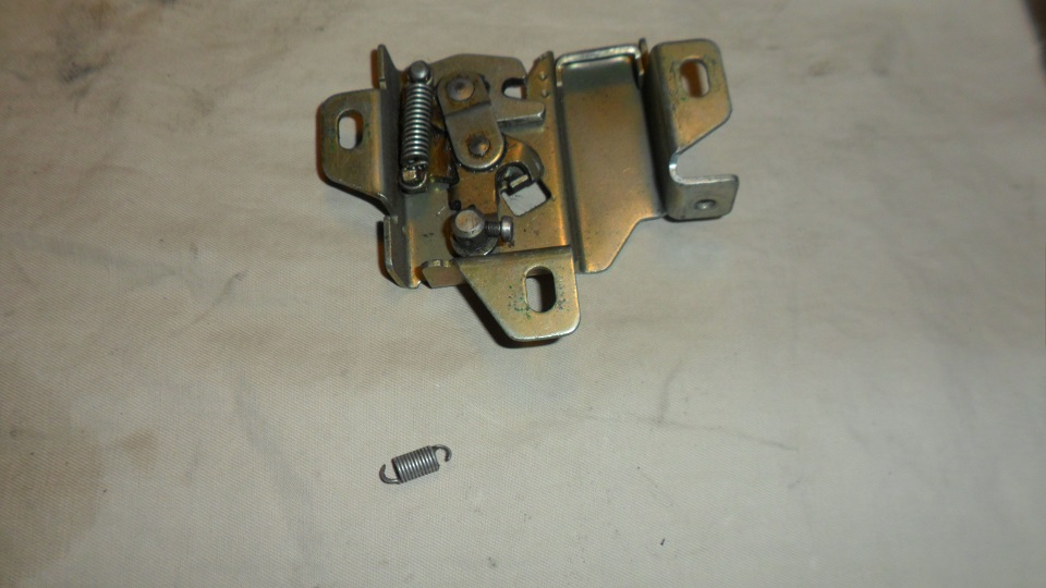

saigon71
The spring I found in the trunk definately came from the latch to help it on the return motion. Re-installed it but didn't notice much difference in the operation:
