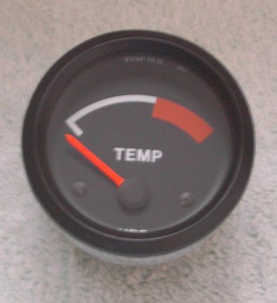

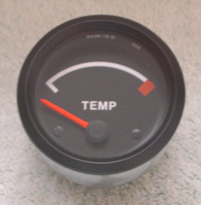

PS edit - there were 2 different OT gauges used - 73 with a wider red band & 74-76 with a narrow one, & IIRC they used different senders at the engine too.

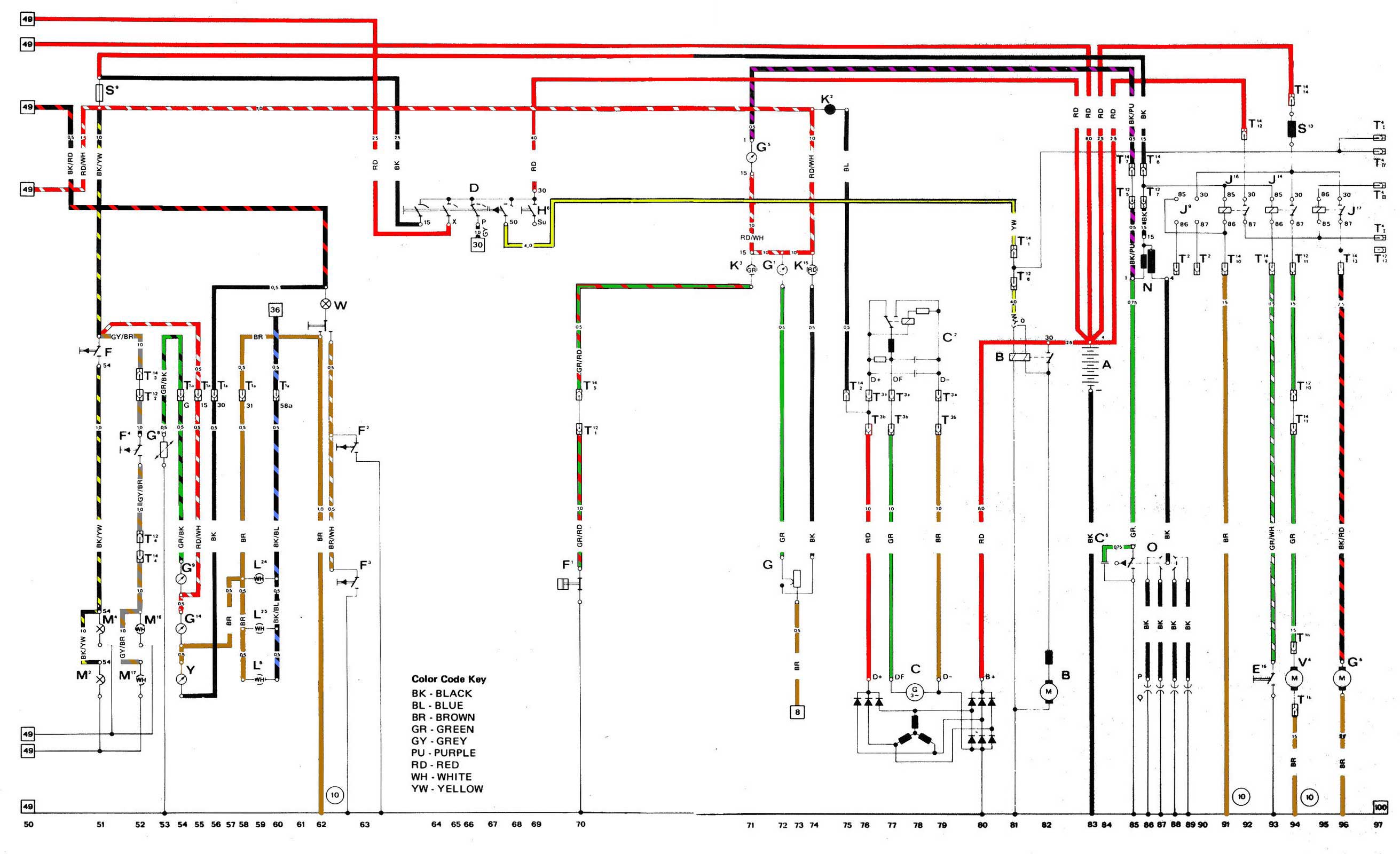

I think the console wiring is about tracks 51-63-ish in the schematic below

Yes the '73 gauge caused a lot of undue concern...peopl thought their cars were overheating because the red zone was too wide.
