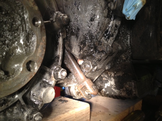

stateofidleness
Engine and Trans are out of the car up on a stand.. was re-installing some tin pieces today and had the "baggie" of my screws sitting on top of the tranny. Took it out of the bag and wouldn't you know it? of all the places it falls into the hole in the top...
dirty is right!! I've been using everything to try to get this thing clean.. brake cleaner, degreaser, screwdriver, wire brush... stuff is hard as a rock and thick.... I don't even really know what it is. It's either CV axle grease, oil, or some type of "undercoating"...
Engine leaked pretty badly from the pushrod tubes (already fixed) so I'm assuming it's many years of caked on oil spraying... damn PO's...

I have crap like that all over my transmission too. It looks like globs of black tar. confused24.gif
bandjoey
Simple Green. Spray it on. Soak 10 minutes. Scrub brush. Garden hose it off. Repeat as needed. Simple will devolve paint after 5-6 hours so wash it down good.
