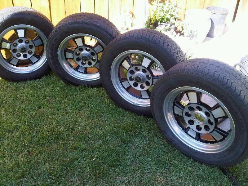

I had some new 195-65R15's put on my 72 Friday. It is my local mechanic's shop and he always lets me help with the tire work. I watched him balance the tires/wheels. it took a LOT of weights to balance out. He noted that every one of the Riviera wheels had a slight wobble to them, side to side wobble. HE got them to balance. It drives perfectly smooth at 55mph but when I get up around 60-65 there is some slight shake that I can feel in the ride. I don't suppose there is anything that can be done to "straighten" the wheels?

I've used these wheels on a couple of my cars and they were all difficult to balance. They required lots of weights to get them right. Also because the offset isn't the same as the factory wheels you'll get some bump steer.

These balanced fine. Maybe it's the manufacturer's QC these days confused24.gif ... these were made by American Racing ...
... and are currently for sale happy11.gif ... (tires not included).
