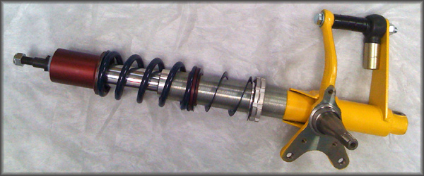

This is a coil over system from elephant racing. They will modify the Bilstein for a hefty price but I'm planning on doing it and have sourced the struts already. Could cost well over 3000 just to source, modify and purchase the correct springs but when your done, it is a much more manageable suspension and you can eliminate the torsion bars.

Great advice.. I have Rebel's RSR set up on my car.
