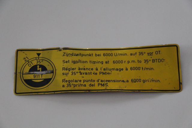

Hi,
my 914 6 engine has a ignition timing sticker for a 911 T - see pic attached. How does the correct one sticker for an early 1970 914 6 look like?
Best,
Mark

Click to view attachmentSince the engine IS a 2 liter 911T, that may very well be the original label.

Mar 17 2013, 03:55 PM
Top is ROW
Bottom is US

Maybe it's not a six engine. . . does the engine have the 640xxxx serial number by the oil breather outlet?? that's where six's numbers were factory stamped. . 911T would have the serial number up by the alter / fan housing. . .

You may have a '68 or '69 T engine.

I have a German domestic 914-6 with the same 911 T timing sticker, imported to the US in the late 70's by the original owner with the COA original engine. I bought it from him. The timing sticker is very faded and a little hard to read, but appears to be original to the car. Engine #6400818, type 901/36.

It is the matching engine to my /6 with a 640... number next to the breather. It was located above the fan. I will do a pic later on.

This could be explained by something as simple as a alternator repair were the strap was used from another engine. I have had 2 ROW cars and they both had the sticker I posted a picture of.
