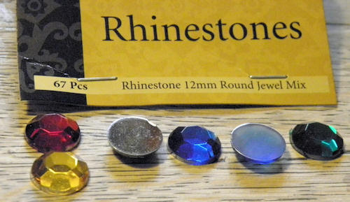

Click to view attachmentLooking around at the local craft store I found these for $2.99:
Click to view attachmentThe backs are silvered but a few wipes on 1000 grit wet or dry removes it. Check the blue jewel, second from the right to see the result. Lots of color choices too.

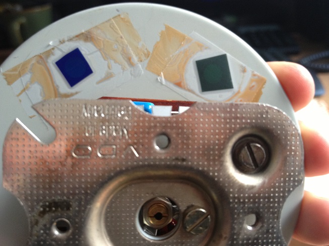

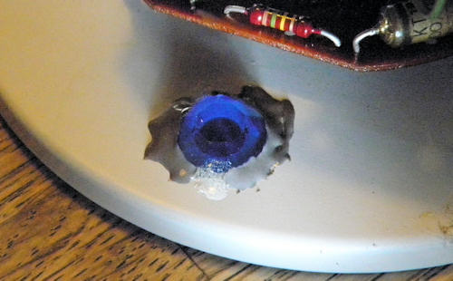

A bit of JB Weld on the back of the instrument face:

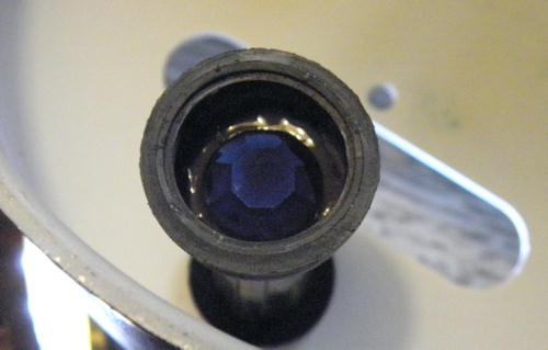

Click to view attachmentAnd inside the rubber light shroud:

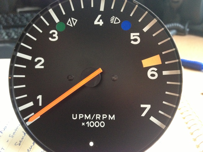

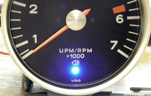

Click to view attachmentAnd try it out with a blue LED:
Click to view attachmentI thought the single jewel on the instrument face might make the light too bright so I added the second into the light shroud, YMMV...
