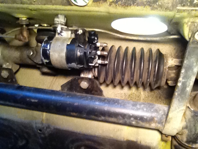

Plumbing the fuel lines to connect up the relocated fuel pump is becoming very problematic. Specifically the supply line my biggest headache. Between the 9mm tank downpipe, the 9mm to 7mm Tangerine Racing reducer and the stock fuel filter there doesn't seem to be any way that I can work the final line to the supply inlet of the fuel pump. The AA relocation kit instructions show a 9mm inlet to 7mm outlet fuel filter but a 7mm inlet 7mm outlet filter came with the kit and from what I gather from forum searches, these reducer filters are NLA. I picked up a very nice reducer from Tangerine Racing but now I'm running out of space under the tank to route the supply line. Any pictures, diagrams or suggestions would be much appreciated.
Here's a picture of the new pump location above the steering rack:

Here's what I did to mount the pump up front. Mine's in a different area than yours but the hose routing should be similar.
There is a lot of room to run the hoses. Use about 5-6 feet of hose for each supply/return. Loop the hoses over towards the driver footwell then back to the tank and lines to the engine.
This will give plenty of slack to allow the tank to be removed without having to disconnect hoses.
In the pic below, the gas tank is already attached. The extra 10-12 feet of hose doesn't affect the operation of the system.
