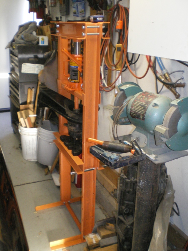

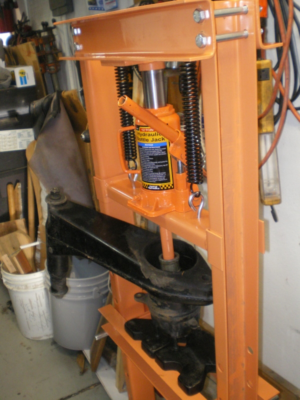

Why did I wait so long to buy one of these? Yes, the job can be done w/o one and I've done it w/o one. But never again! biggrin.gif I like it so much that I will share it. Anyone of my SoCal Bro's need to use it just stop by. It's the cat's meow. Damn you Eric Shea. Your an expensive man to hang around with. av-943.gif lol-2.gif

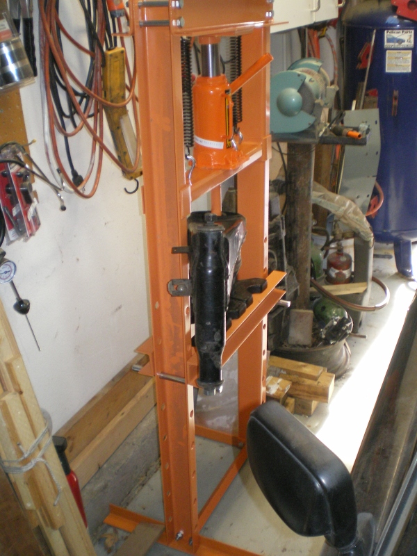

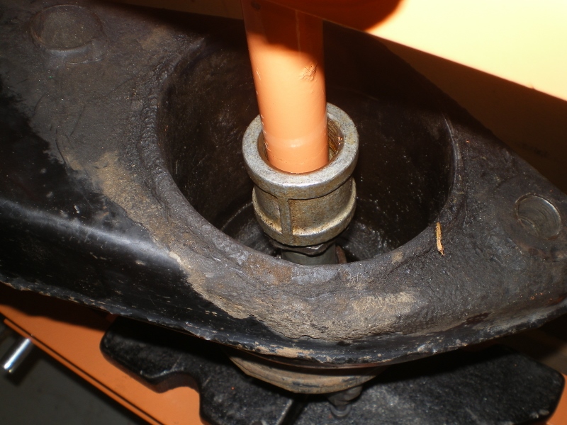

Definitely looks like Porsche approved "plumbing" pieces to push out the bearing... whatever works!

Kent, what's the tonage rating on that model? I can't read the jack.
I gotta get one of those!
championgt1
Looks like it says 12 ton.

bye1.gif Hey Mike, how's the new dig's? Jack is right. It is a 12 ton. It was $40 bucks more than the 6 ton which was worth the frustration level of finding out that a 6 was too small. hissyfit.gif Really, I wasn't sure and the HF is a hr round trip so I went with 12 ton. I was worried about floor space but these don't take up any to speak of. I laughed aloud when I read Bulitt's comment. How many times have I done something similar.

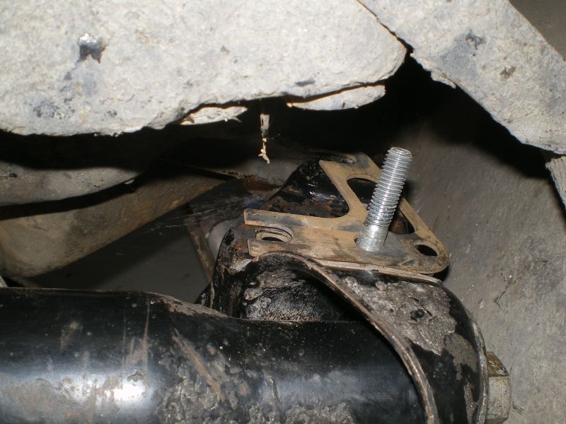

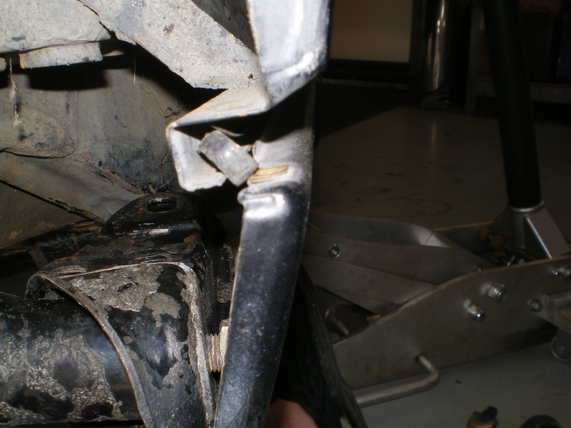

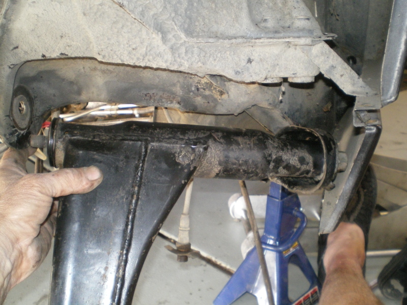

OK, here ya go Jimbo. It helps to remove this little screw

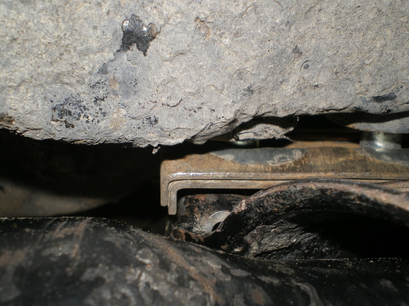

then you can slip the outer side in first as shown with the horn oriented in the correct position.
now slip the inner side into the hole of the ear and just start the bolt a few turns
now slip the bolt up thru the washer on the bottom side (not seen in this pic) and thru the captive hole of the spacer. the rest will slip into place later.
the others spacers in place

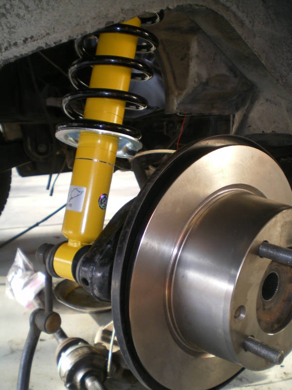

shocks in place
FL000
