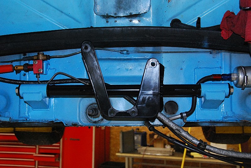

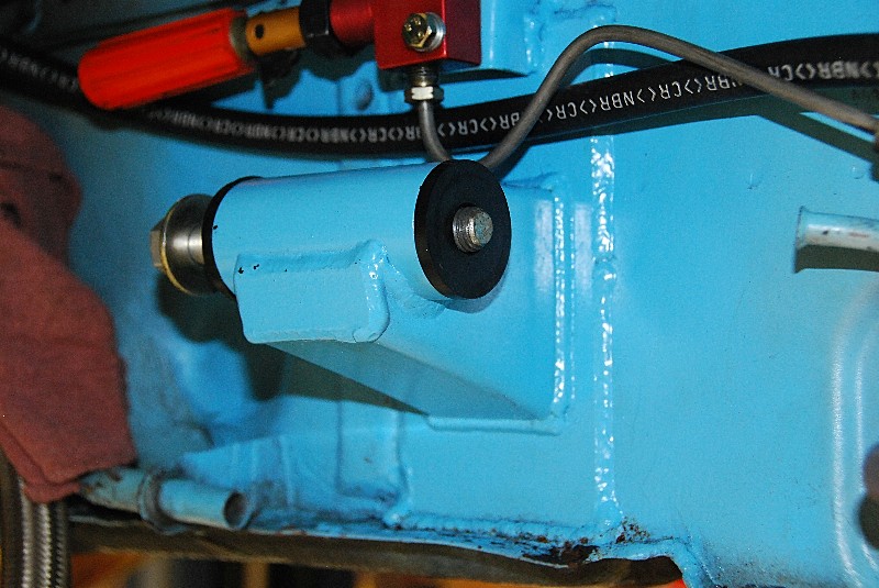

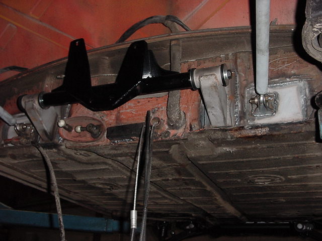

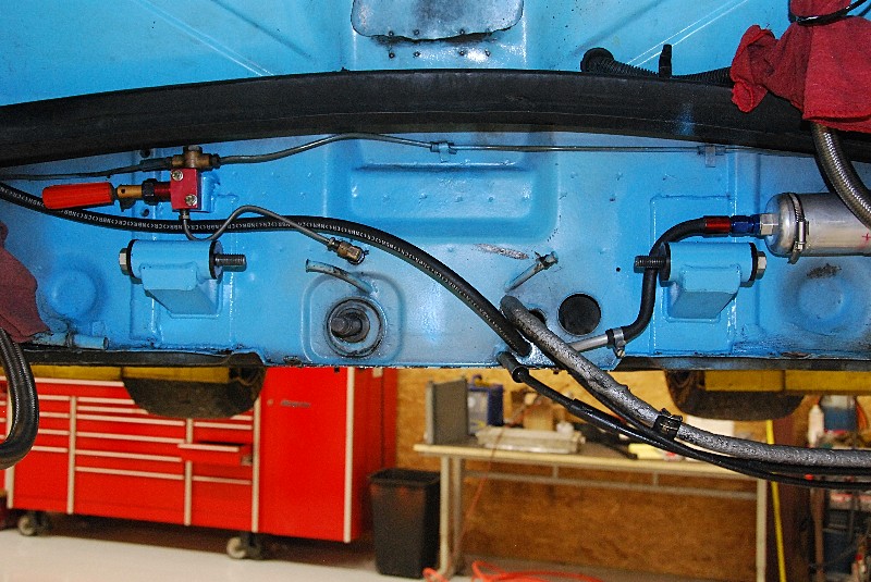

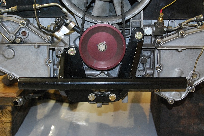

naro914
It's a weld in mount (sorry if I forgot to mention that)
Pictures are from Papa Smurfs install...
