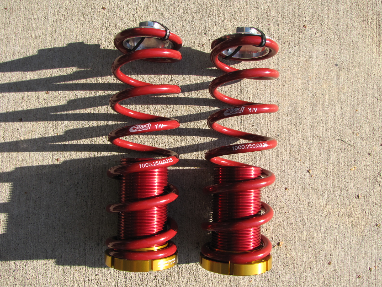

1) The # on the spring tells you all you need to know: 1000 = 10 in, 250 = 2.5 id, 0225 = 225 lbs spring rate

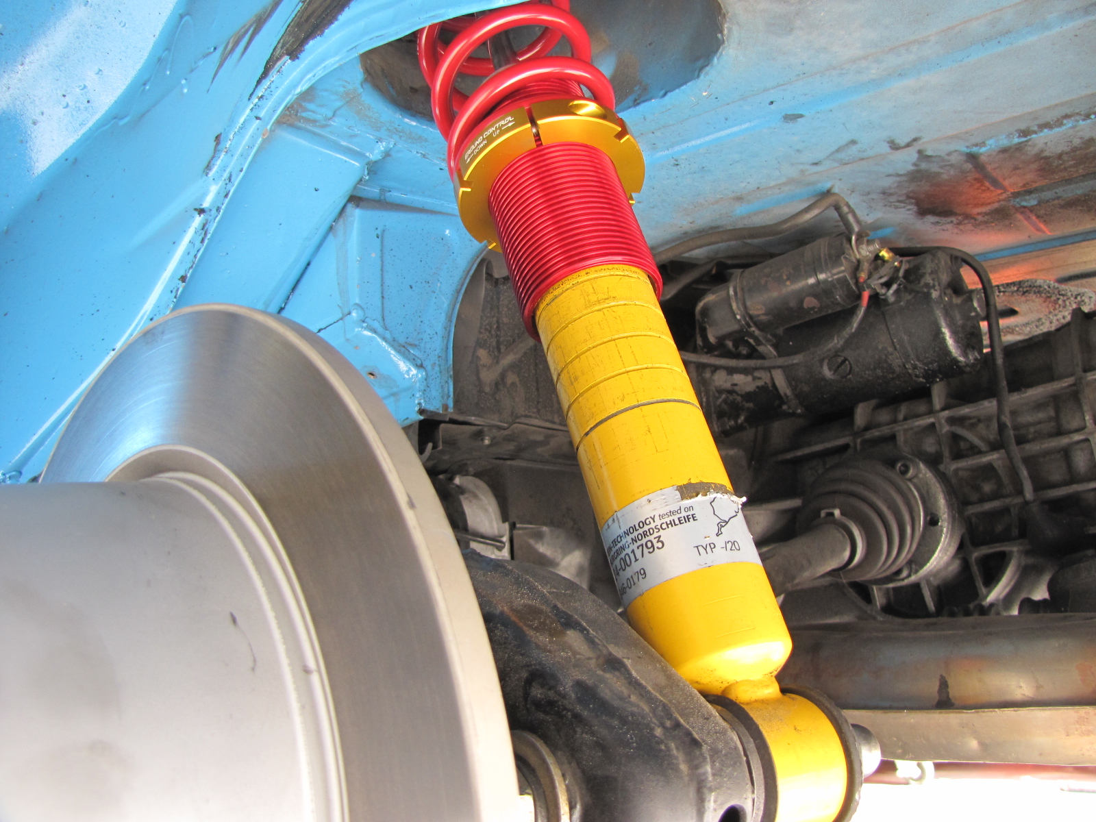

2) They are on the 6th clip position from the bottom. You can count them in the photo.
Edit: The above photo is not where they sit now. I will post some pics later.

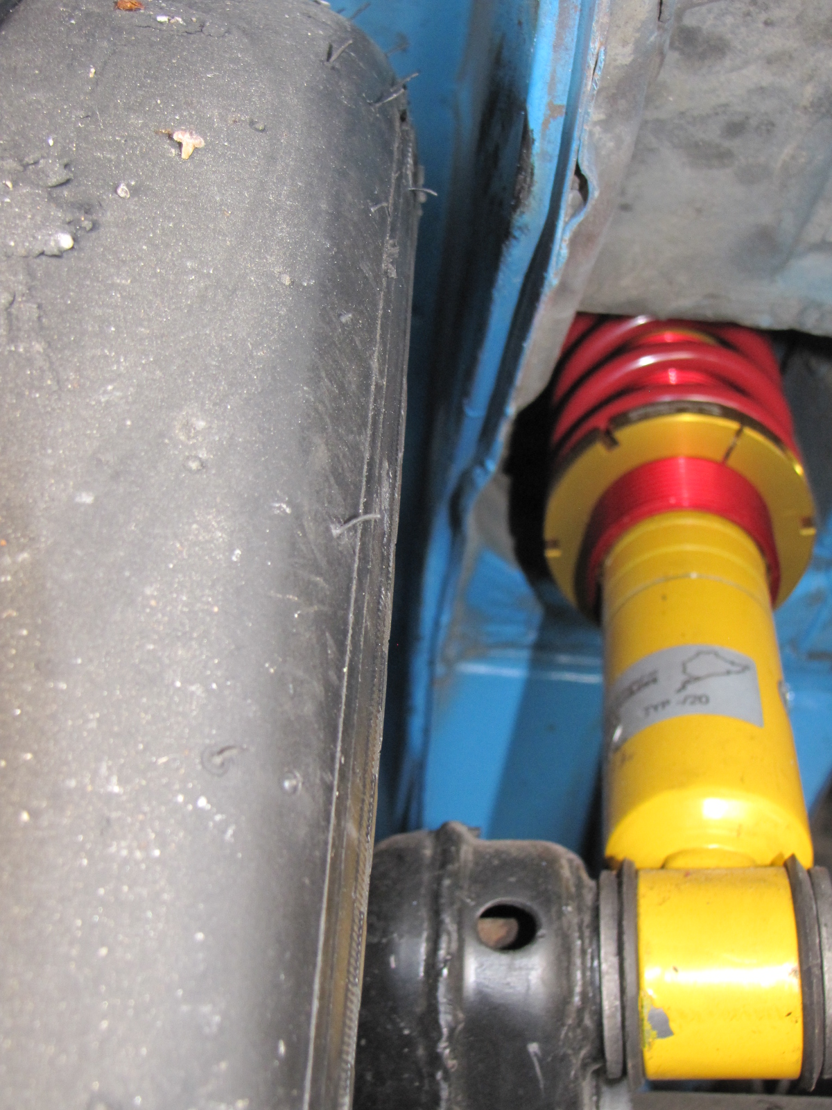

Here is the clearance inside the fender. The coilover is on the 4th perch.

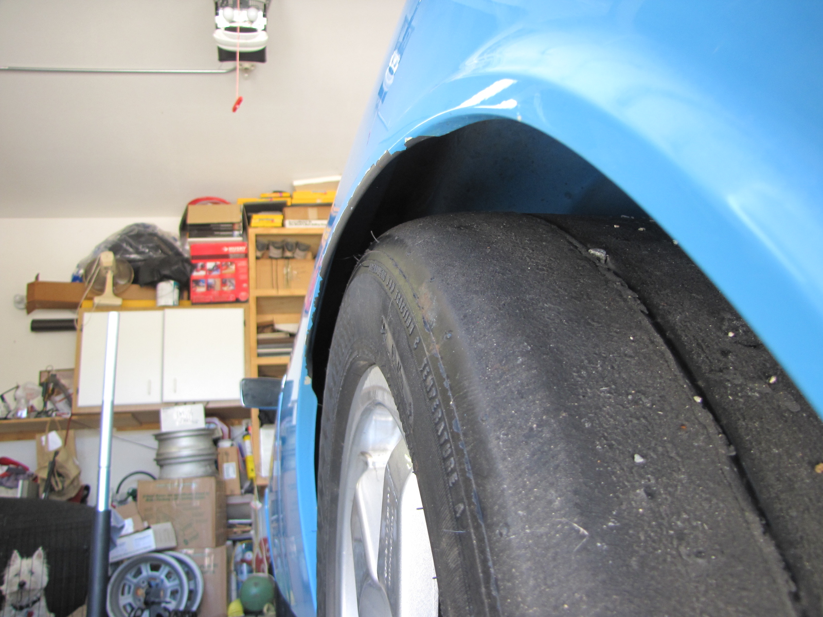

Click to view attachmentHere is the clearance after I rolled the fender. In this shot I could barely get one finger in between, so I pushed the fender out about a 1/4" with a jack.
Click to view attachmentHere is the way the car sits. The measurement from the middle of the fender to the ground is 207/8" in the rear, 2211/16" in the front.
