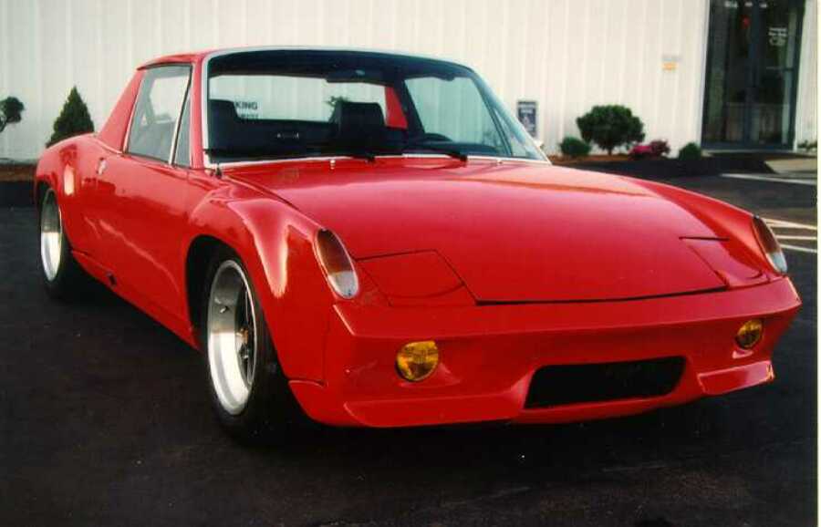

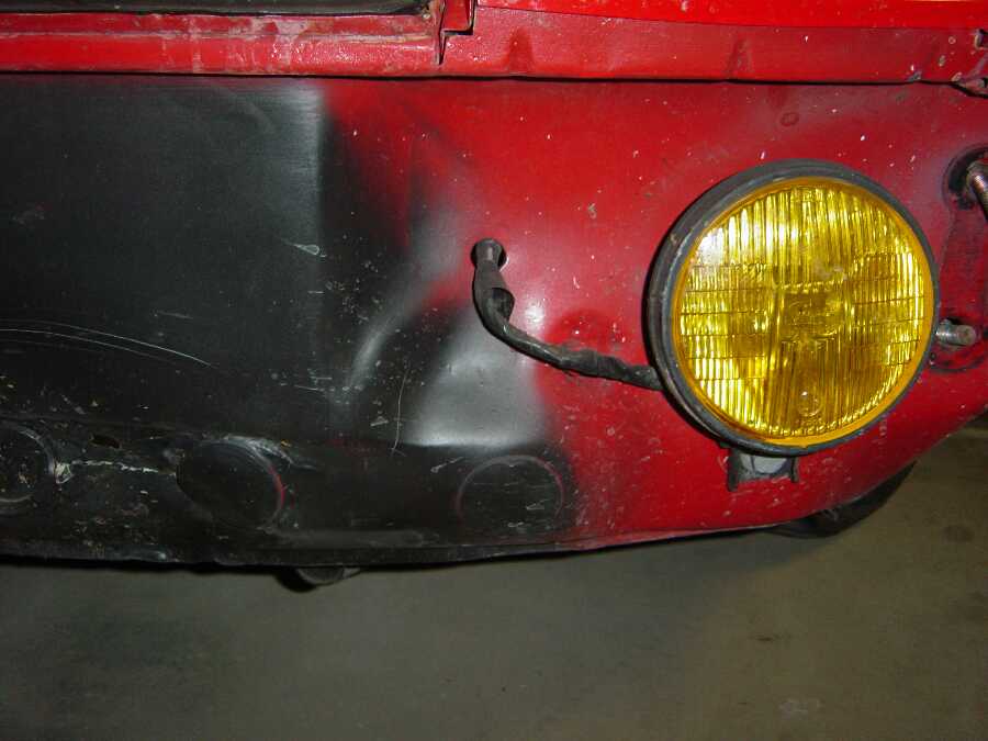

I scored a decent 916 nose the other day - and am looking for pix of other 916 noses with driving lights installed please>
and - are they attached in front of the depressions for the lights - or - are the depressions cut out and the lights are behind / inside?
thanks in advance!
td
carr914
QUOTE(tadink @ Apr 10 2013, 10:33 AM) *
Don't cut the Whole Depressions, just where the lights will come through
Phoenix-MN
PIAA lights mounted with the stock brackets in the stock location, I cut out only enough to fit the dia. of the lights
gms
Mount Fog Lights
Cut holes in bumper
Mount bumper
tadink
QUOTE(gms @ Apr 10 2013, 09:24 AM) *
Mount Fog Lights
Cut holes in bumper
Mount bumper
PERFECT - exactly what I was looking for!
THANKS guys -
