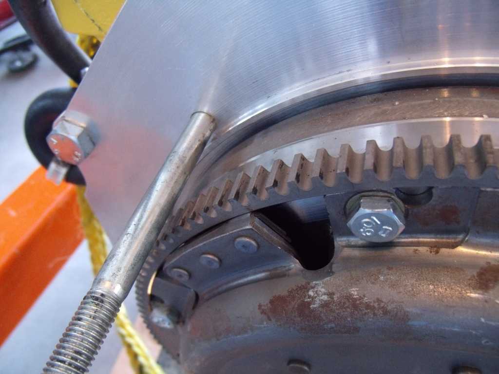

I have Kennedy adapter kit (#4950) for a SHO V6 3.2L motor attached to my Porsche 914 stock 901 transaxle. I'm using the stock starter. This is a Stage II kit with their flywheel & clutch disk.
I've had the engine on a test stand for several months working on tuning the
motor. I recently dismantled to do some maintenance and noticed that the starter does not appear to be engaging the the flywheel sufficiently (see image).
Has anyone else had this issue? Solutions?

Mark, contacted them twice - still no reply, which is weird because they have replied to me previously when I was needing install instructions months prior.
The teeth on the starter do have a slight bevel at the end - which means there's that much less of the engaged distance being used by the teeth. The wear pattern on the flywheel teeth indicates this.
Anyone using a KEP could potentially have the same issue if using the KEP flywheel - engine mating doesn't matter - its about the design. Just trying to see if there is something out there others may have experienced also.

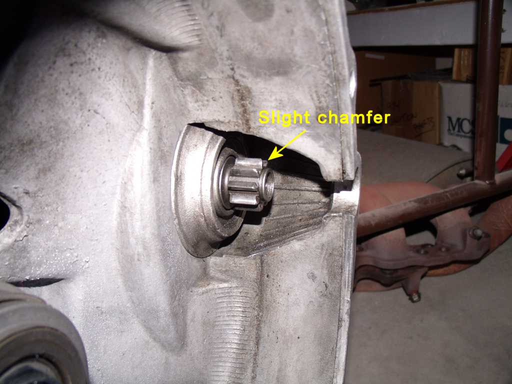

3d914
Apr 18 2013, 11:04 PM
Got a shot of the starter teeth and slight chamfer at the front. I was planning to do a dimension stack up this weekend to see if the numbers coincide with the indicated wear.
Mike Bellis
Apr 18 2013, 11:11 PM
Either jumper the starter or just pull the bendix to see how far from the edge of the bell housing it will reach. Then measure from the adapter and see what the difference is.
Because of the physics involved, the starter drive shaft will try to pull away from the flywheel as it spins under load. Your pic of the flywheel looks to have minor marks towards the adapter and heavy marks closer to the tranny. This is what should be expected since the end of the starter shaft does not have a pilot bearing.

Yep, take a measurement starter gear at rest to the trans flange surface and then put 12V to just the solenoid and take another measurement. Then measure you ring gear to engine flange surface.

Mike & Mark, that's the direction I was headed. Checked the dimensions and sure enough they're good. I have 2mm of gap between the rear face of the flywheel teeth and the front face of the starter teeth. during engagement starter teeth travel 14mm which is sufficient to cover the 11mm width of the flywheel teeth.
So as Mark indicated - the dark markings must be due to "starter drive shaft will try to pull away from the flywheel as it spins under load. Your pic of the flywheel looks to have minor marks towards the adapter and heavy marks closer to the tranny. This is what should be expected since the end of the starter shaft does not have a pilot bearing."
Didn't really doubt that Kennedy's design was correct - just wanted their check to coincide with mine -but I'm good with my numbers.
