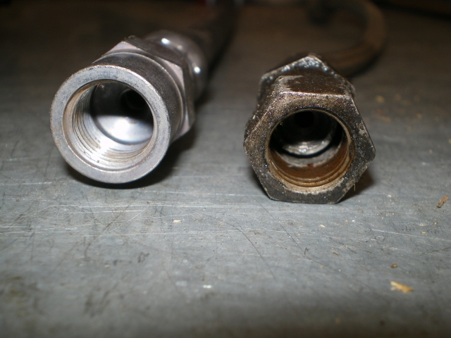

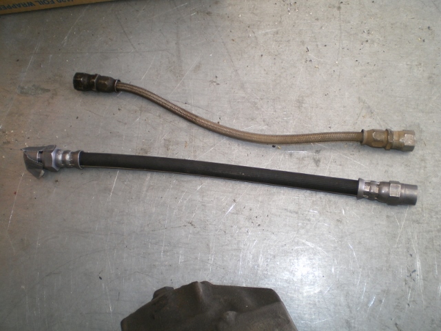

I tried to install new brake lines today but apparently I need help. The old lines are S/S and are being replaced w/ rubber Meyle's. The old line has a small end on each end whereas the Meyle has one small and one large. WTF.gif It fit's tightly on the hard line off the caliper but loose as a goose on those 1/2 union fittings which are both a bit smaller.
old n new
different size ends
I have more pic's if needed. The size difference is appx .020.

Just dab a dollop of black RTV on the hose, and let it sit over night. You'll be fine smash.gif
But yeah, remove the union from the car. the hose mounts to the car, and the hardline screws directly into the hard line.

If you don't use the union, don't you have two female fittings? One on the hose and one on the car?

Thx, makes sense. Duh! Technically speaking, this doesn't have to go in the what I did WRONG thread, does it? biggrin.gif
type47
QUOTE(Elliot Cannon @ Apr 17 2013, 09:11 PM) *
...don't you have two female fittings? One on the hose and one on the car?
doesn't the hard line have a captured male threaded nut to screw into the female end of the rubber line?
So no double female seeing each other....
Elliot Cannon
QUOTE(type47 @ Apr 18 2013, 10:19 AM) *
I think you're right but what size is it??
bare 1
Technically there are no unions in the line. Different fitting. Lose that adapter on the car and the lines will go together like Scotty boy says.
76-914
QUOTE(bare 1 @ Apr 18 2013, 12:19 PM) *
1/2 union, not union. the adapter is a half union. and yes, I will be doing it like scotty says.
