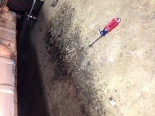

First time these rockers have been off ever! Drilled out original rivets and then cleared out three ponds of dirt! Amazingly, rust free!

Thanks all! These little guys were stuck!!
Was 2 for 6. I soaked for 36 hours and then used mapp gas and locking vise grips. The dirt that came out was laughable!
They've never been off before. Good tip on rivnuts. I end up drilling the stuck ones out and then tapping new 6mm 1.0 screw.
