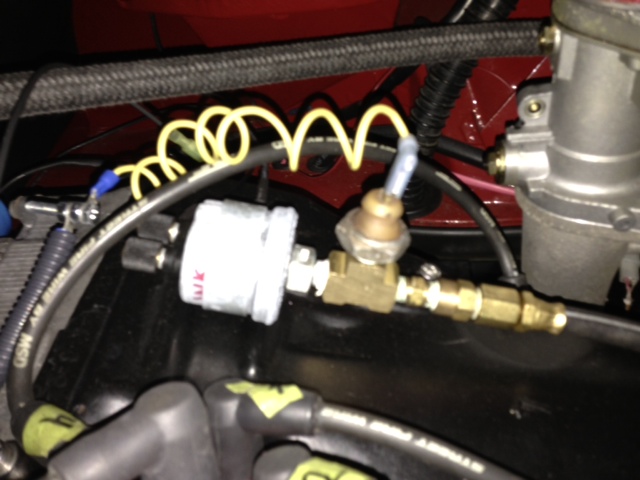

There's no need to lose the light. Add a tee on the end of the extension hose so both the stock sender and gauge sender can be installed.

Example of what Chris said in photo.
Click to view attachment.
But, I would be concerned that the idiot light was not triggered by the VDO. Most complaints are that the VDO triggers the idiot light at higher pressure than the idiot would normally trigger on it's own. If your idiot light is not lighting when you crank the car then it's not getting a signal from the VDO. From the installation shown in the photo, you get two independent opinions, one from the VDO sender and a second from the idiot light which is no longer dependent on the VDO sender
