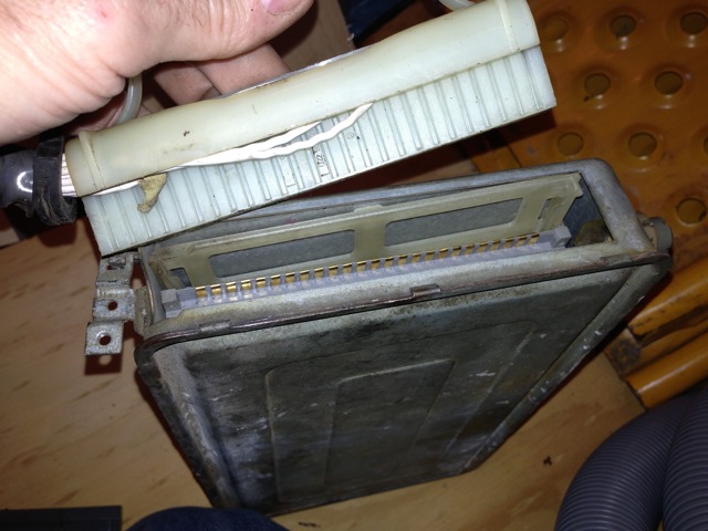

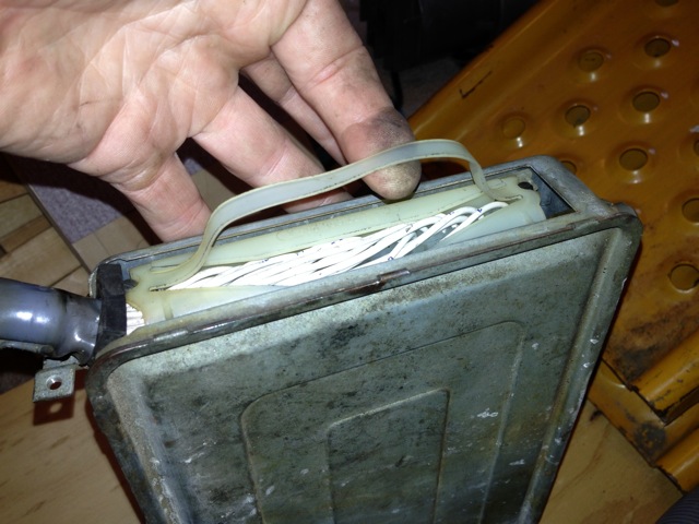

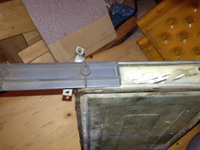

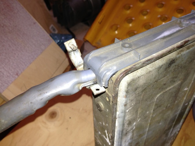

Bob L.
May 25 2013, 10:26 AM
QUOTE(warrenoliver @ May 25 2013, 10:43 AM)
Thanks for the Anders troubleshooting tips. When i follow his guide, it instructs me to "remove the ECU from bracket and remove wiring harness plug" - I don't see a plug, the wiring harness goes directly into the ECU. Do I have to open the case of the ECU?
QUOTE(76-914 @ May 25 2013, 09:09 AM)
There's a clamp that holds the harness at the corner of the ECU where the wires go in.
Click to view attachmentLoosen it and slide the plastic cover off.
Click to view attachmentYou will then be able to grab the plastic handle and unplug the harness from the ECU. Carefully pull it straight out.
Click to view attachmentClick to view attachment
warrenoliver
May 25 2013, 12:17 PM
OMG, thanks Dave for the pictures. Without those, if i had opened the ECU and seen that mess, i would have closed it up! I will have to get after it this afternoon.
Thanks again.

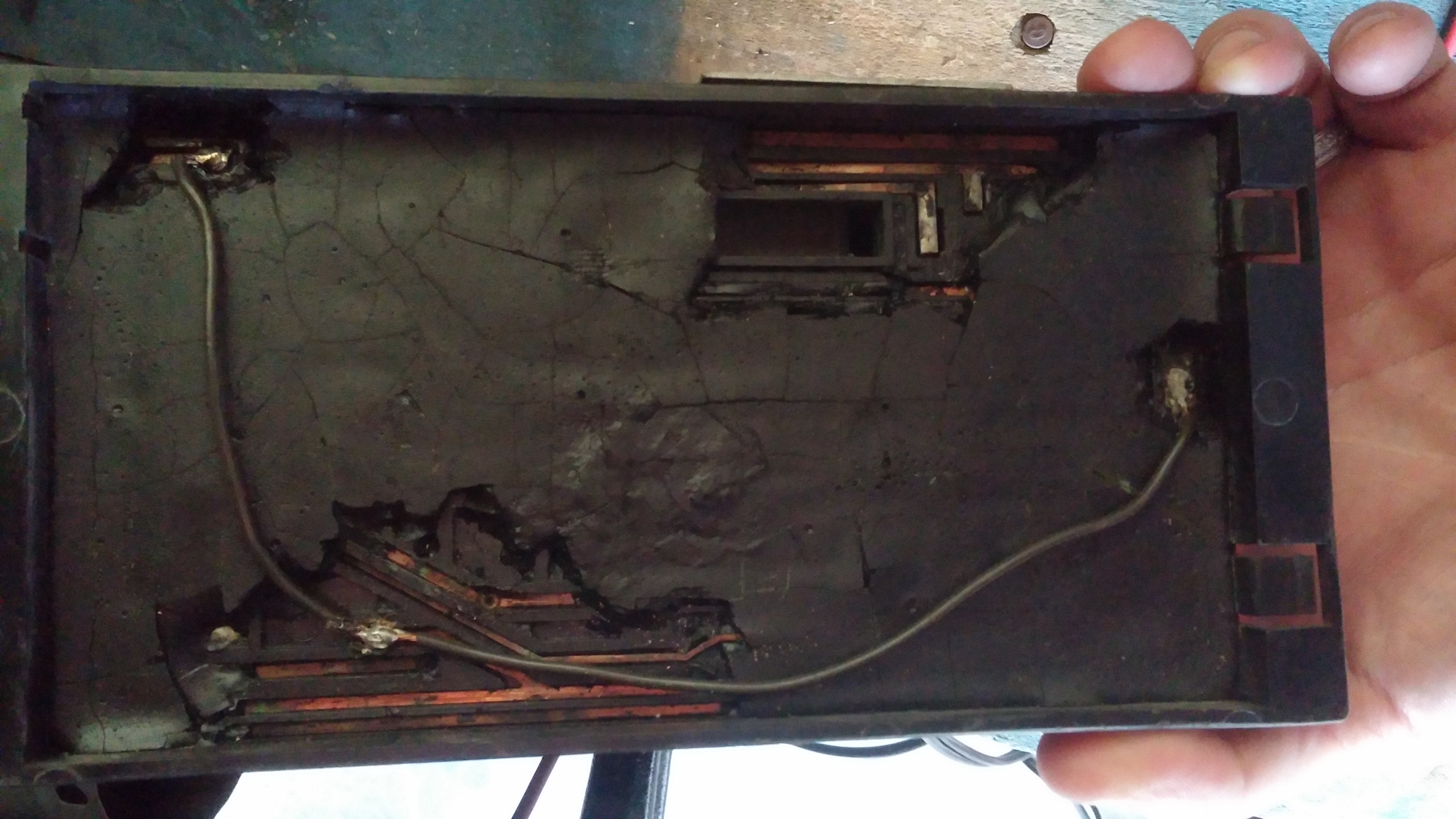

As I mentioned in an earlier post, my relay board had a connectivity issue with that same fuse holder. I wire brushed it and soldered the rivet head to the fuse holder. No more problem and that was 6 years ago.
EDIT: Who is to say another relay board will not have the same problem at some time!? Unless you could find a new one at ??? cost, I would fix the one I had and be assured it wouldn't rear it ugly head again anytime soon, but that is just me. I do have a spare that has been checked out and repaired on the bottom for the voltage regulator contacts and it works just fine if that is the direction you want to go. It does need to be resealed in the area of repairs however. If you decide to repair yours, I am sure there are folks here that can give you advice on how to repair and then reseal the bottom of the board.

Hey guys, This post save me a bunch of time. I had the same problem- car restarted then died on Friday morning at the Staples store parking lot. I got it flatbedded back to the house, then came in to research the symptoms, and found this thread. I got to this part, and tried the small wire test- the pump ran for 1.5 seconds, then the car started, and ran with no problem!!! I ended up soldering a wire to one end of the fuse, and the other end to the pin on the relay. Installed them both and the car's running fine. Since this wire just parallels the trace under the relay board, I don't see any reason I can't leave it in place for the season, and then remove/rebuild the relay board as my next winter's project.
Thanks for the writeup!
Jim
flylarry
May 17 2015, 08:15 PM
If the relay works and a jumper between the fuse and pin #13 makes the pump work, you have corrosion in the runs under the tar under the relay board. You can put an ohm meter on #87 fuel pump socket and pin #13 on the 14 pin plug to verify.
Check this, pretty sure this was a repair for the fuel pump problem...
click here.
