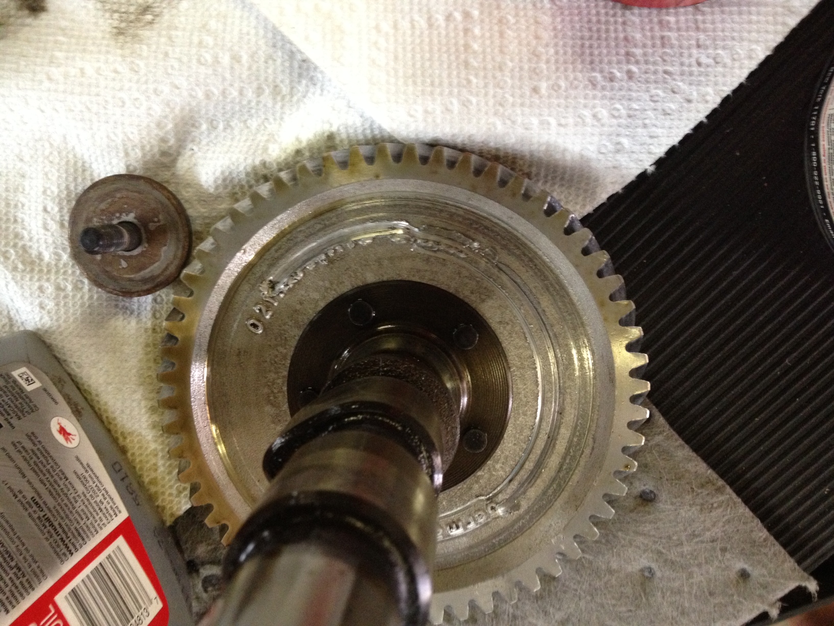

Engine's out but not apart yet - some of the head studs are jammed and will have to be cut.
And here's one very good reason why the engine needs a rebuild:
https://www.youtube.com/watch?v=6H5e4wrnP9I
I'll try to post pictures of the carnage once they have the case apart. I brought home some of the tins to clean, and I need to send out my speedometer for a rebuild -- want to get the odo working again before I start putting miles on the rebuilt engine. Anybody do these on the East Coast, or do I need to send to North Hollywood or New Vintage?

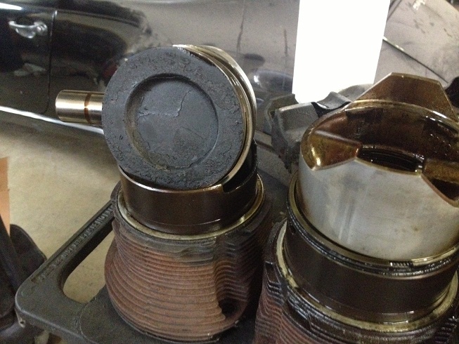

Decision time!
My engine's apart. The Cylinders have enough pitting and scratching that I will probably go ahead and replace. And are these bus pistons???
(Assuming they are, I'm very confused... thought this engine had never been apart, but I've only owned it for 4 of its 40 years!)
There's some carnage from some loose metal - fortunately, no significant damage to the Crank or the Case. But look closely at the cam gear:
So now I need to decide what Ps & Cs to get, and what cam. It's a 2.0 case, running EMPI 40mm carbs. Primary concern is drivability - this is a street car, not a race car... but power (and to some extent, fuel economy) are considerations too. Who makes Ps & Cs that bring it up to 2056? What CR should I be targeting? and what cam?
Opinions welcome!

Just thought I'd update the World...
We are building a 2056 out of the original 2.0 engine. My stock cylinders had some minor pitting, which was enough to convince me to go to 96mms. The Ps & Cs are coming from European Motorworks - George also rebuilt the heads & rods (and balanced), and provided his G camshaft and a few other valvetrain goodies.
