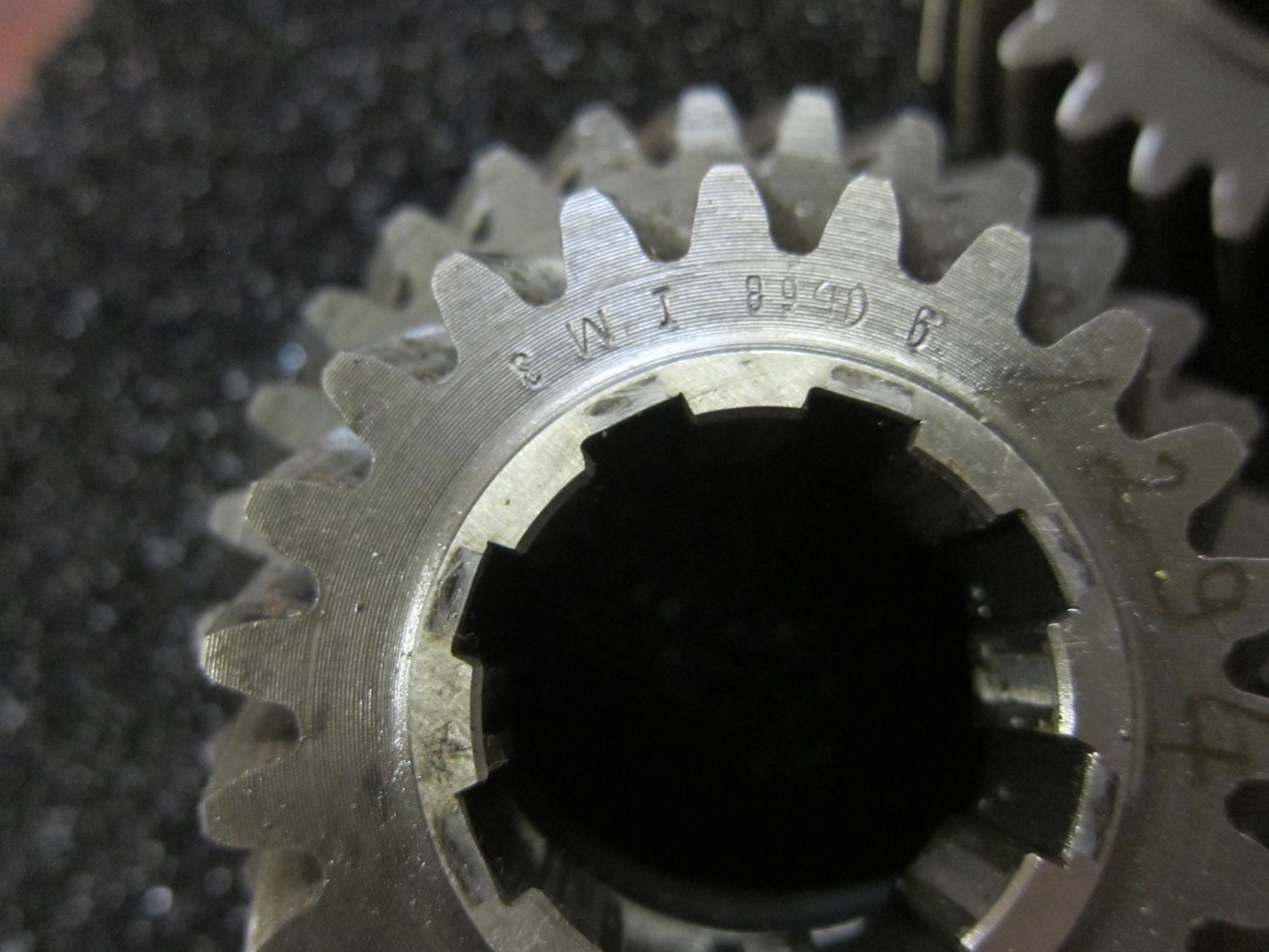

In anticipation of the good Doctors upcoming tranny clinic I have been cleaning my trannies and getting things ready for the clinic (trannies and clinics-the jokes are endless). Anywho...I recently picked up a 901 tranny and an additional gear stack that I have been able to identify as coming from a 912 ( I ran the #on the intermediate plate). I pulled the stack apart and was able to ID the following gears A, F, S and Z but the last one I'm not sure, it is either an M or a W, can some on please tell me which way the stamp goes?

Just count the teeth and look up the code that way.
--DD
sixnotfour
M 22-29

Thanks! Good tip Dave, it never occurred to me to count the teeth. This is my first time digging into a tranny.
