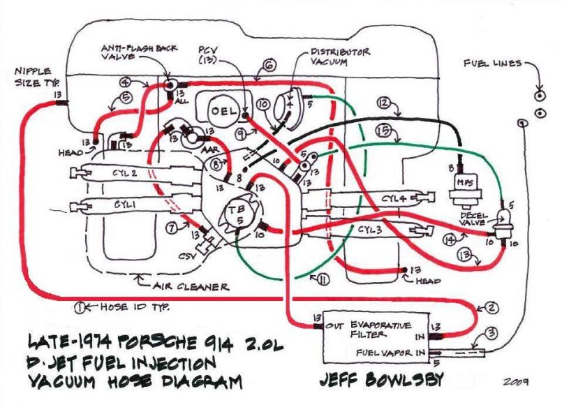

nathansnathan
IPB Image
The orange ones go to the head vent tubes and to the flashback valve. The elbow goes to the air cleaner. - I think that's what you are looking for?
type47
hoses 4, 5 and 6 in the diagram but with carbs, I don't know where the hose (in the diagram from the anti-flashback valve to the air cleaner) would go to. With FI it goes to the air cleaner so maybe to one of your carb air cleaners. There is also an aftermarket "thingy" that the head vent hoses go to; don't know the exact name but I've seen pix of it here... the vent hose is 13mm if I recall.... (but then the Bowlsby diagram says that huh.gif )
