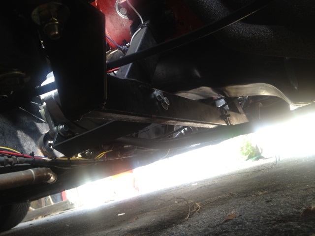

Andy: Here are some photos of the shift rod and engine cradle
Shift Rod
IPB Image

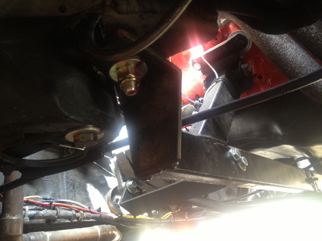

Engine Cradle
IPB Image
Engine Cradle 2
IPB Image

JRust: Just tried shifting into 4th and 5th while looking down at the rod and it looks like it clears the engine cradle just fine. The above images were taken when 5th gear was engaged. I was really hoping this was the problem biggrin.gif

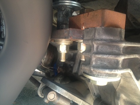

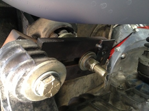

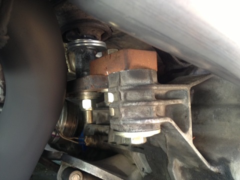

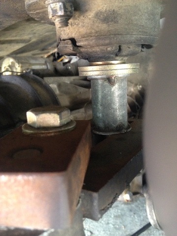

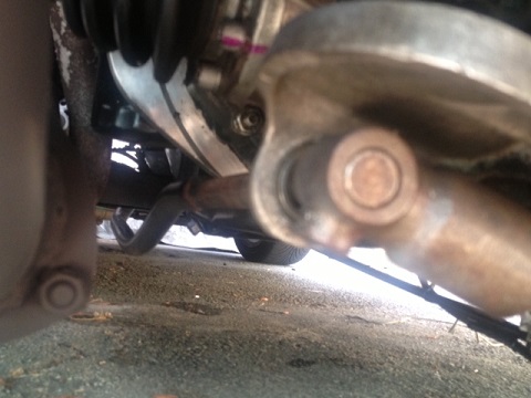

messix: I think your right, it's definitely wiggling back there as evidence in the passenger side tranny mount is skewed to the right in the photos below.
Passenger side tranny mount:
IPB Image
View from under passenger side tranny mount:
IPB Image
Drivers side mount:
IPB Image

The rubber on that mount looks like it's complete junk ...
PS: It also looks like your whole setup is several inches lower than stock. That can't be good ...
Steve
You can get 911 motor mounts pretty cheap from pelicanparts.com that can be used for 914 rear trans mounts. I don't mean to be mean, but your whole setup looks pretty mickey mouse and dangerous. I would advertise in the classifieds for the correct setup. Someone might have some v8 conversion parts laying around you can get a good deal on. Or buy the parts new from either http://www.rodsimpsonhybrids.com/ or http://www.renegadehybrids.com/

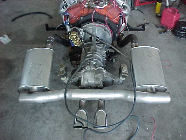

Look at the rear mounts on mine. The "brick" colored piece is a relocation bracket. It moves the tranny rearward 1.25". The factory rubber mount (that you have) gets removed and replaced with the solid bar stock of the semi solid mount. The poly block is mounted between the relocating bracket and the bar stock.
You have a piece of pipe for a lowering spacer. This should not be there...
Although not a good pic, here you can see part of the front mount. It is straight across with a round end that bolts into the stock location. Again the factory mount is removed and replaced with a solid bracket of steel.
Dr Evil
Do you have a metal piece under the bolt that is going through that engine mount? It looks like it is about to pull right out.
EthanBlack
kg6dxn: Thank you for the photos and clarification. Good thing none of the jerry-rigged components failed on me while I was driving at speed
Dr: Better for my health to not drive it around till I install the Renegade mount
