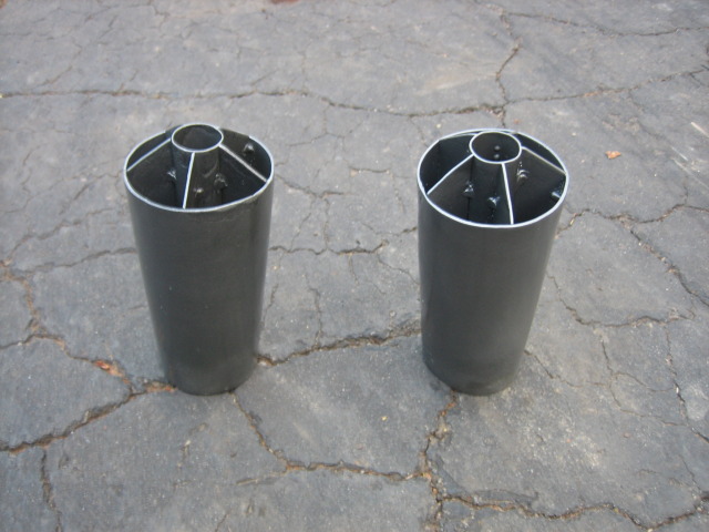

vw505
Were can I find mega phones with the inserts like the one pictured above.

QUOTE(vw505 @ Jun 19 2013, 10:50 PM) *
GT Racing (but I'm sure you will have to buy a Pair

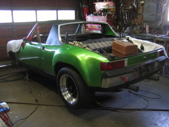

Porsche930dude
iv got bus manifolds running into glass packs then into the the megaphone style tips you posted. i made them myself. I only have had it running a few days so its hard to say but first impressions doesnt sound very good. not crazy loud but you really only get the race car ear piercing sound with a race engine. I may end up making some sort of collector pipe across the back. time will tell

Porsche930dude
well that straight exhaust was terrible so i made my own muffler for it. i kept the bus manifolds and used a bus muffler. made extension pipes to the inlets. I cut an opening in the muffler so i could drill out the pipes inside it make it flow better. i cut open the baffles too. I ran the original single out exhaust pipe to one of my tips and cut a hole directly in the muffler for the second tip. so its a bit offset under the car. but it flows evenly both sides since I opened up the original tail pipe pretty good inside. and the tips are placed just like they were with the straight pipes. sounds good now not too loud but definatly not too quiet. just how i like it smile.gif lots of cutting and welding and drilling but only took about a day and well worth the effort
