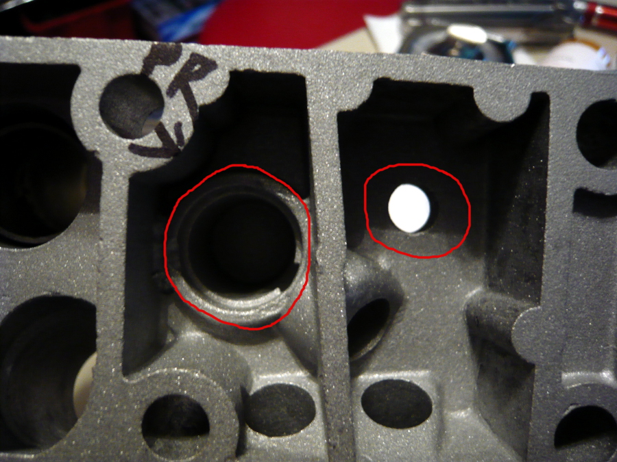

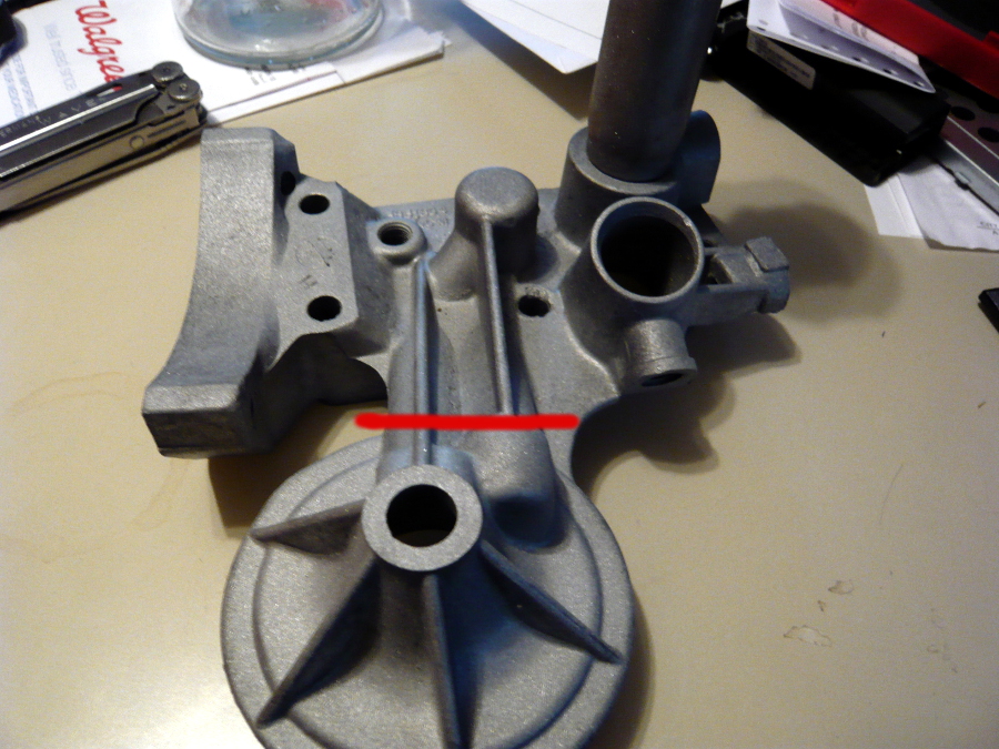

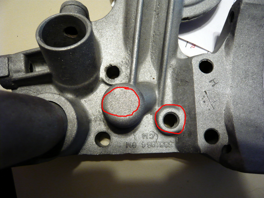

r3dplanet
Aug 18 2013, 08:19 PM
Hey, can you post a good close up pic of right where your oil lines leave the front engine case? I've never seen such a close cut job on that and I'm super curious how it's set up. I can see now that any remote oil filter will have lines that sit in between the belt.
Let me know when you get your parts from Clark's?
-marcus
JRust
Aug 18 2013, 08:35 PM
Here are a few Marcus
JRust
Aug 18 2013, 08:36 PM
Sorry I bought a Mac & haven't figured out the resizing program yet
r3dplanet
Aug 18 2013, 09:12 PM
Super interesting. I took some photos on the piece in question. You can see with the aid of my unparalleled Photoshop skillz what the top and bottom of the holes that were modified for your setup look like.
Click to view attachment Click to view attachmentNote that big hole houses one of two oil pressure relief valves. I have a worry that perhaps you might be missing one if the PO just drilled this out and welded on a fitting. It does have the advantage of clearing the firewall with ease and I like that they point straight up. I also like that the PO took the time to install an oil pressure sender, so he must have been cognizant of the oil pressure issue at some unmeasured depth of his psyche.
On other conversions (incl Dr. Evil?) I've seen that the oil filter is simply cut where I show the red line and then two -AN or other fittings are drilled and threaded into the two corresponding tubes. I realize that the more I learn about your engine the more work I make for you. Sorry.
Dr Evil
Aug 19 2013, 11:38 AM
Yup, I keep the pressure valve. Just cut the filter housing off and put fittings on.
Dr Evil
Aug 19 2013, 11:42 AM
The above is a bit more elaborate than what you need. Root hooked me up with adding aluminum to the adapter so it could be tapped for NPT nipples.
Dr Evil
Aug 19 2013, 11:45 AM
Few more.
