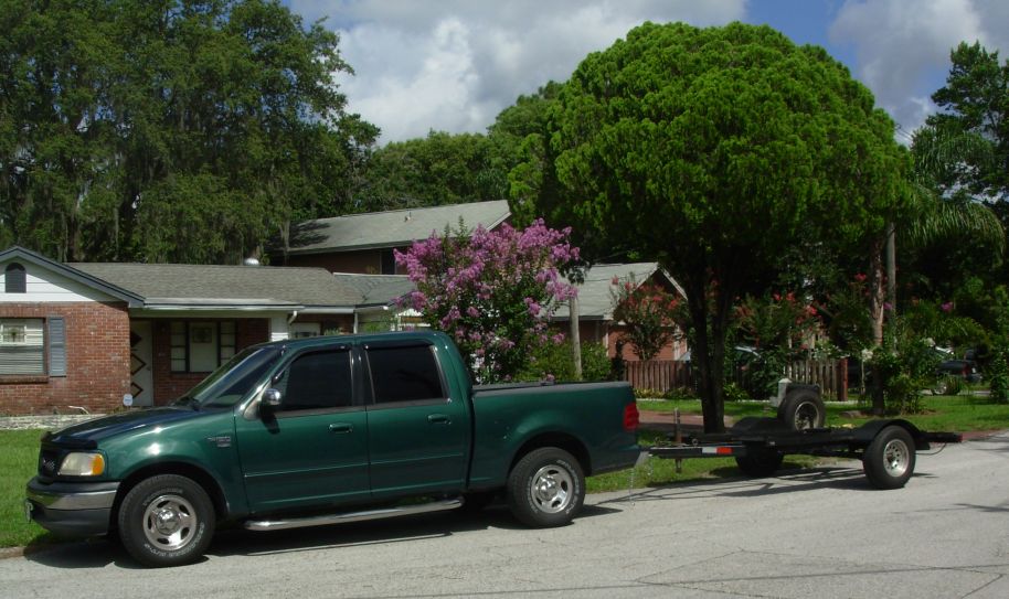

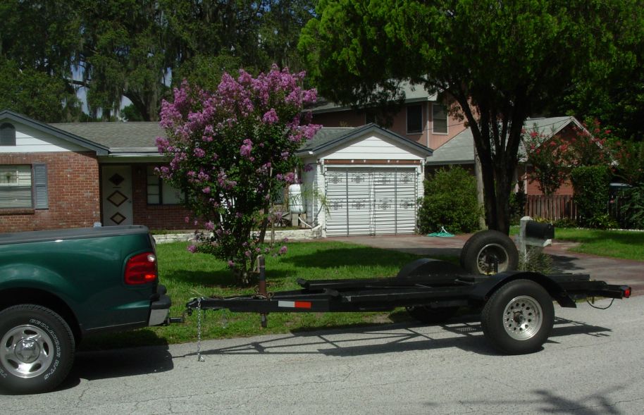

I bought a Car Trailer today ( my 1st in about 10 Years since I got rid of my Trailex). It's small, just big enough for a 914. It just made a Trip from California and the people wanted to sell it upon arrival in the Sunstate State. I got a Good Deal!. Paul (URY914) went with me to check it out and he gave it his Thumbs Up Approval! thumb3d.gif

Sweet. I'm looking for something similar to that but yours seems kinda tall. May want to invest in some shorter tires. Very cool though, haven't seen many single axle trailers.

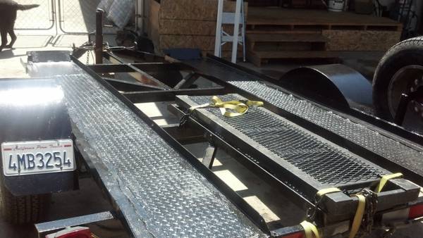

I built my single axle trailer back in the 90's, TC's is a straight axle and mine is a drop axle, so it's a bit lower.

Probably not a Huge Selection of Trailer Tires.
I need to do some Tweeking this week - Need to make the Ramps Longer, Relocate the Spare, Move the Fenders outward

Whats the dimensions? 6.5x12' ?

2" Dropped axle, not smaller tires. Any trailer parts store has the drop axles for the same price as striaghts ( 80.00 -ish )

The Deck Dimensions are roughly 6x10 - I'm going to install a Winch as I'm not comfortable driving up such a tight area

I'm going to make the fenders removable and move them outward about 2 Inches

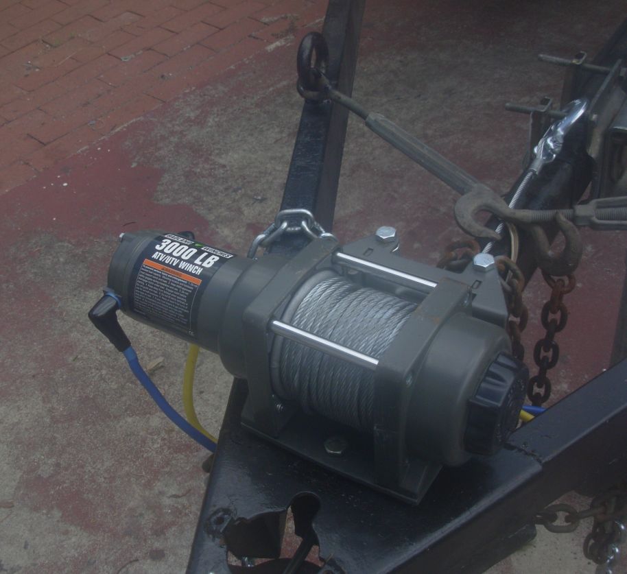

I went with the 3,000 Winch vs the 2,000 because it had the Remote & all the Mounting pieces- that was extra or non-existent on the 2k. After the 20% off Coupon it was less than a $100. Plus the extra pulling power in case URY throws a Bag of Cement in the Trunk before an A/X to gain an advantage!

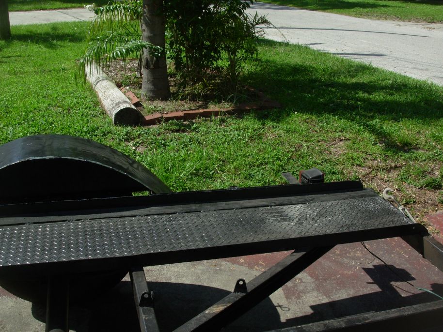

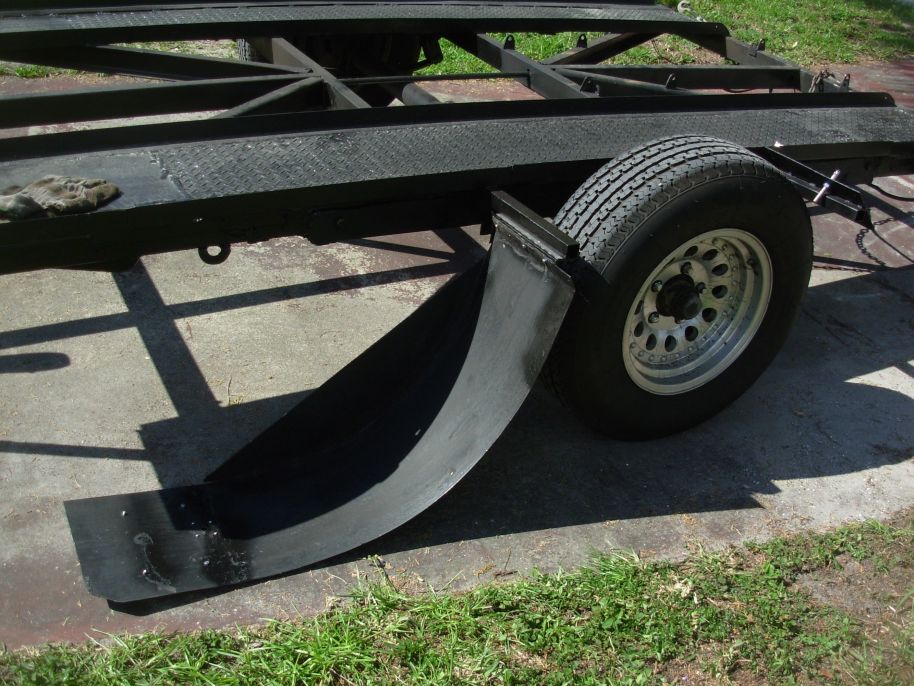

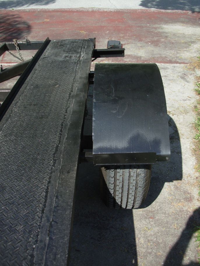

Cut the Fenders & Spare Tire Mount off today, Mounted the DS outwards 2 Inches with a Hinge at the Front & Hood Pin at the Rear, so it swings completely out of the Way. Will do the PS tomorrow. Cleaned up a bunch of the Nasty Welds. Killed my Cut-Off Tool and my Grinder is acting wierd blink.gif

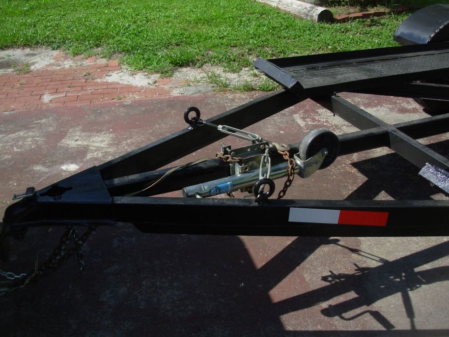

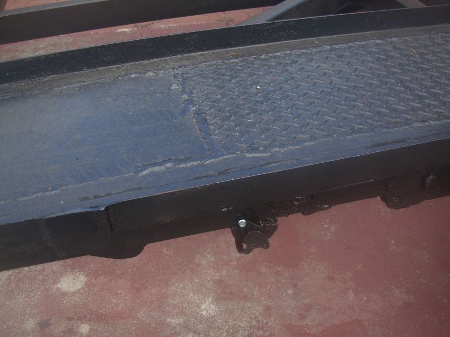

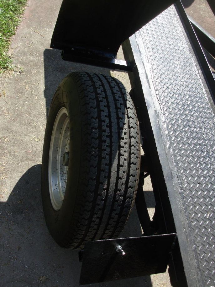

I Removed the Spare Tire Holder (trying to find a replacement Place) & the Center Post Parking Holder (Replaced with an Aluminum Fold-out w/ Wheel)
carr914

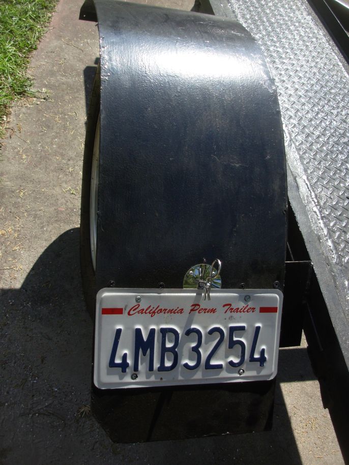

As I said I cut off the Fenders and then moved them out a Couple of Inches - then I hinged & Pinned them, so they fold out of the way

Winch Installed

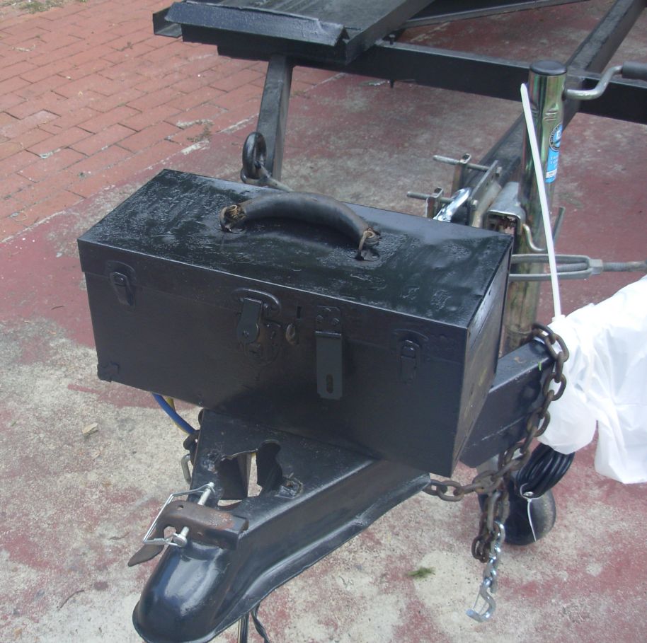

An Old Tool Box that I found when I moved in my house - I cut out the Bottom to hide the Winch & to keep it out of the elements
The Connection for the Remote Control

Cool. Looks nicer than the old cardboard box I threw over the winch on my brother's trailer laugh.gif

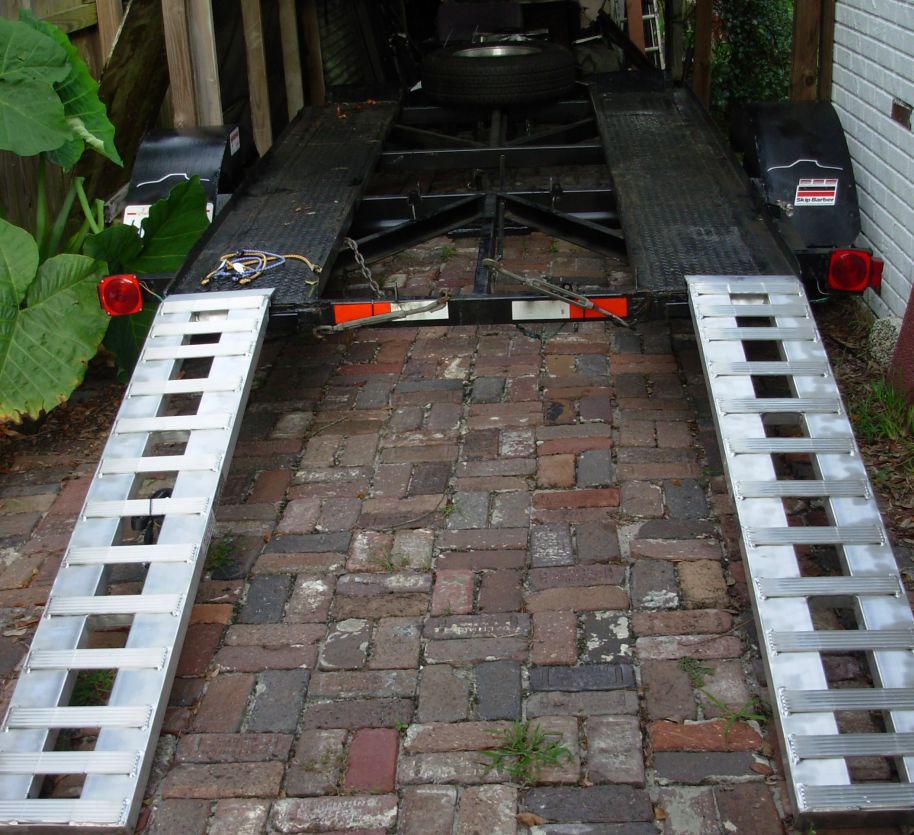

Got some 6' Aluminum Ramps - the Ramps that came with the Trailer were only 4' long and weighed 60lbs apiece, the Aluminum ones weigh 18lbs apiece.
balljoint
thumb3d.gif You won't even need that winch now. The car will just roll up the ramps on its own.

Where did you get the ramps, TC?
You might want to devise a method to 'pin' those to the trailer too idea.gif ... I have some aluminum telescopic ramps that have slid loose on me sad.gif
carr914
QUOTE(euro911 @ Jul 19 2013, 02:27 PM) *
DiscountRamps.com - Shipping was really quick
http://www.discountramps.com/car-trailer-ramps.htm
They have Safety Straps - I do need to Weld a Steel Strip on the Trailer so it goes up Higher to match the Hook on the Ramps. But I will also only be Winching a Carr on & off due to the Width (lack of) of the Trailer

Fuchin Harbor Freight Winch! headbang.gif - it never worked! AND I lost the receipt!! headbang.gif headbang.gif . Fortunately I called my Credit Card Co and they mailed me my Statement that showed my purchase. So I walk into HF and the girl says "Again?". Apparently someone who looks like me (poor asshat) has brought back 4 of these pieces of shit. They took it back, but since I didn't have the Original Receipt, I got the Credit back on a HF Gift Card.

I bought one of their 6000 lb winches (good deal when it was on sale) but I hooked it up to make sure prior to installing it.

I can see the line of cars back up on the freeway trying to get by this slow moving caravan !!!! biggrin.gif
