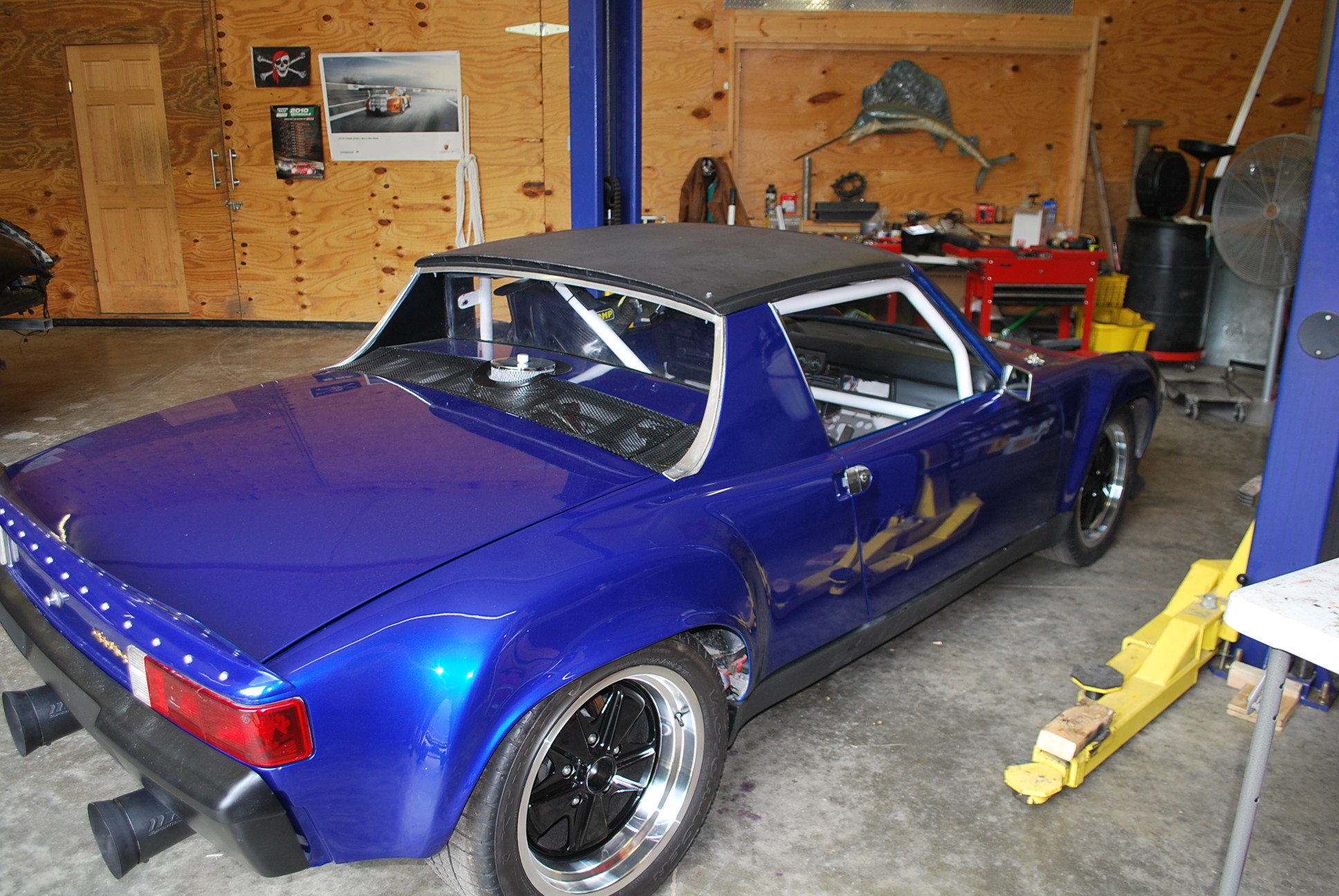

driving.gif aktion035.gif That looks fun!
tscrihfield
Very interesting! Cool build!

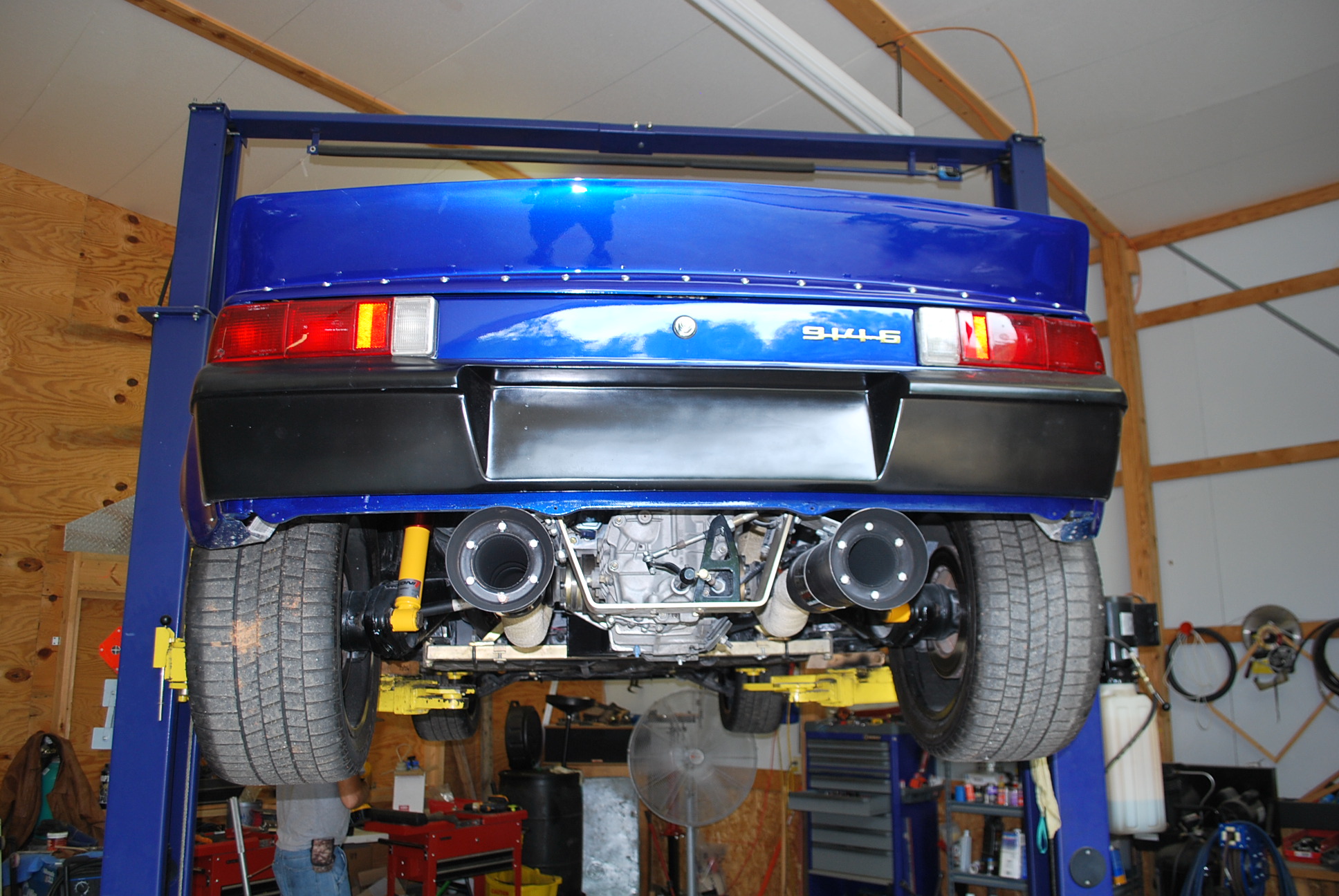

Trust me, they are strong.
RFoulds
spaceshuttle
QUOTE(Ferg @ Aug 8 2013, 02:03 PM) *
d914
If this is the right guy,,,,, you should see the trailers he builds,,,,
Hey how are ya,, I met you with bob! At the Mitty... How about a couple more pics of the rear spoiler?.. Sheridan right? I was thinking of the same thing!
spaceshuttle
QUOTE(d914 @ Aug 8 2013, 06:53 PM) *
THAT'S ME. I remember meeting you.
That is indeed one of Rogers "Ducktails". I'll try and post some more pics tomorrow.

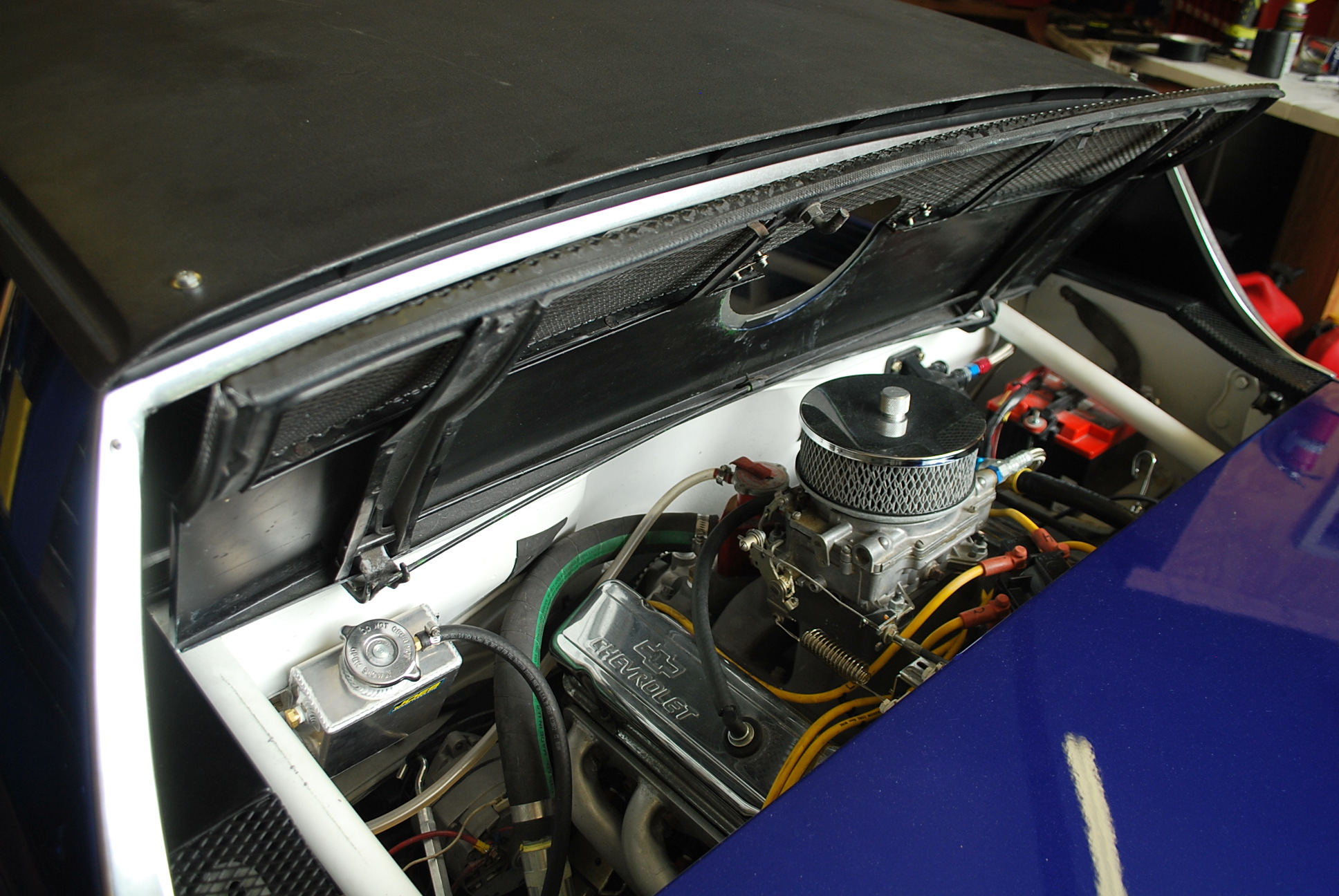

I thought about doing a 6 as well. I know one of the top turbo guys in the world working with that perticular engine. I just don't have the money. If he wants to sponser me, well we will be getting a v6.smile.gif
zambezi
The problem is he some how has two threads with the same title. People have been replying to both threads. his response was:
Went 4.3 because I had an opportunity to buy a really nice set up at a great price. Forged everything and Brodix aluminum heads. Should make 350 plus. the 930 was flipped and I have installed Renegade's cable shifter setup Have had the car for several years and finally got around to finishing it. Steel Flairs. And yes there is a little move around room in the engine bay. Since it's a track car, I was not so concerned with the vibration issues. I have not had it at the track yet but it is screaming around he block. biggrin.gif

why 4.3? and what HP is it producing?
I personally like the way a 4.3 leaves open space in the engine compartment but there have been issues reported about balance issues with a 4.3?
are you running 930 inverted or did you have it machined to run right side up?
jim
anyway - his reply was ..
he got a great deal on a 4.3 on steroids.
he also had the 930 machined and is running right side up - vs running up side down and unmachined.

That 4.3 is very nice and probaly makes more HP than most V8s. This is a first class car
spaceshuttle
Thanks for all the props guys.
The 4.3 V6 seems to be where most have questions.
I have another V8 914 with a 383 that makes about 450 HP (documented) that I absolutely love to track, but frankly, that car is a beast. Fast as hell but almost frightening, and it has a tendency to shred Trannys. I also have a 2001 996 that I use as a DE car. The 996 is a joy to drive at the track, but just not fast enuff after driving the V8 914.
My objective here was to build a RELIABLE track car that has the HP to hopefully keep up with the GT 3s etc. So, if I have been successful, the V6/930 will be a nice blend of my other 2 cars and will become my primary track day car of choice, and allow me to sell the other 2 cars. Unless I get around to fixing the GT 3 in the background, but that's a whole nother thread/can of worms.

Larry....I like the way the rear flares are done. What size tire are you using ??
Also lets see some pictures of the trailers that you build and some of the Blue and red cars.
spaceshuttle
QUOTE(BIGKAT_83 @ Aug 13 2013, 05:41 AM) *
Bob,
We rolled the steel fares a good bit. Currently running a 275/40-17 with 1" spacers. Could possibly get 295's with less spacer, but then I need a wider wheel than the 9" I am using
