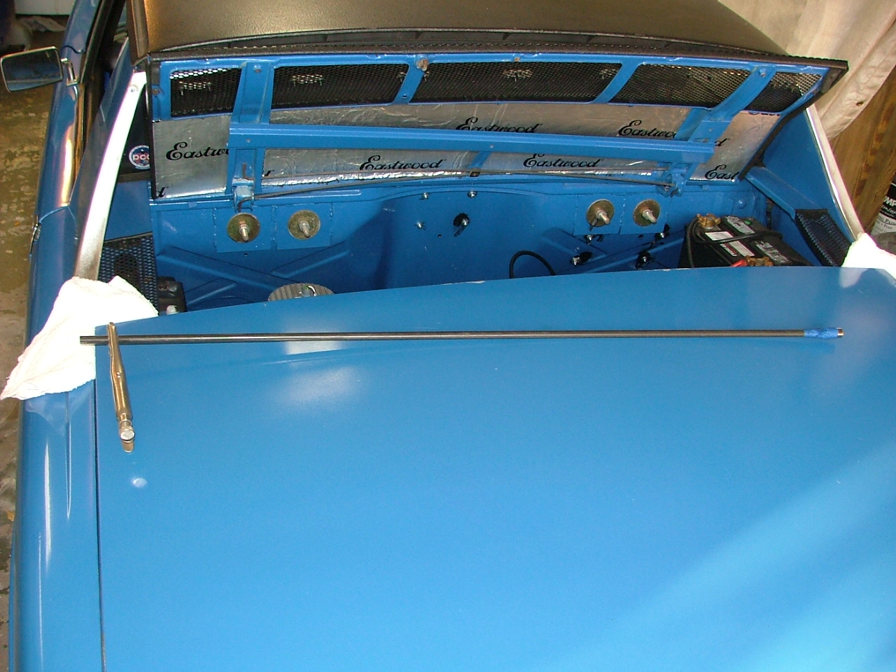

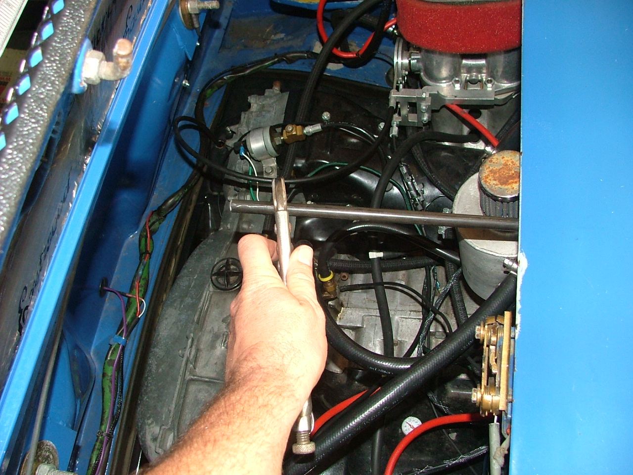

FourBlades
Aug 12 2013, 06:02 PM
I found a long set of extensions too wobbly to remove the 10mm bolts holding the lock on.
Made a "tool" for removing them.
Steel tube with 10mm socket pounded onto one end and taped on for paranoia.
Grab with vice grips.
Click to view attachmentRemove hinge bolts (I have gas struts instead of the dreaded spring rods).
Lift up end of trunk lid and insert tool.
Click to view attachmentJohn

914werke
Aug 13 2013, 01:42 PM
Rich, Yes
Robert, coat hanger may work but I found the wire gauge to thin so I made that one pictured out of some thicker gauge material I Picked up at the local home improvement place.
click here.
