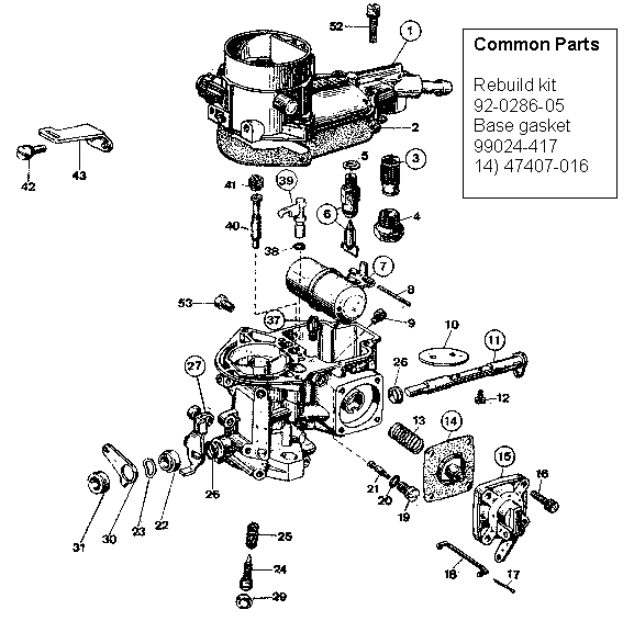

Here Is a diagram along with part numbers for your carbs:
http://www.racetep.com/weber/34_ICT.pdf
I really think your problem is that the float bowl or bowls if both carbs, are overfilling........This can be from fuel pressure too high, overriding the float adjustment........or..........the float adjustment itself. There are only 4 screws to be removed to lift the carb top and see.

In the diagram form post number 6 above the item number 6 upper is the seat and the item number 6 lower is the needle. The float is number 7. The float has a tab that pushes number 6 lower into number 6 upper and cuts off the fuel supply. You need to bend the tab very carefully to obtain the correct distance from the bottom of the float to the face of the fuel bowel gasket. If the float sets to high in the fuel bowl it will allow to much fuel into the bowl causing it to give a mixture that is too rich.
pilothyer
Weber 34 ICT with plastic floats Should be set at 3.6mm for the upper limit, and the bottom at 12.1mm. Remove the top of the carb by removing the screws and gently lift the top off....the gasket should stay with the top. To check if the inlet/shutoff valve is in good order, turn the carb top upside down (so the float closes the valve, and blow into the fuel inlet (where the fuel line was connected) you should NOT be able to blow through it. If you can, the seat and the valve should be replaced (comes in the rebuild kit) If you can't you are good to go. Turn the carb top back over in it's assembled position, with the float hanging down..You measure from the gasket (still on the carb top) down to the top of the float this will be the 12.1 mm measurement......bend the tang till you obtain this measurement. Next lift the float untill the tang just closes the valve (not tightly) and measure from the gasket to the top of the float. Bend the tang to get the upper limit of 3.6 mm. Hope this helps you.
