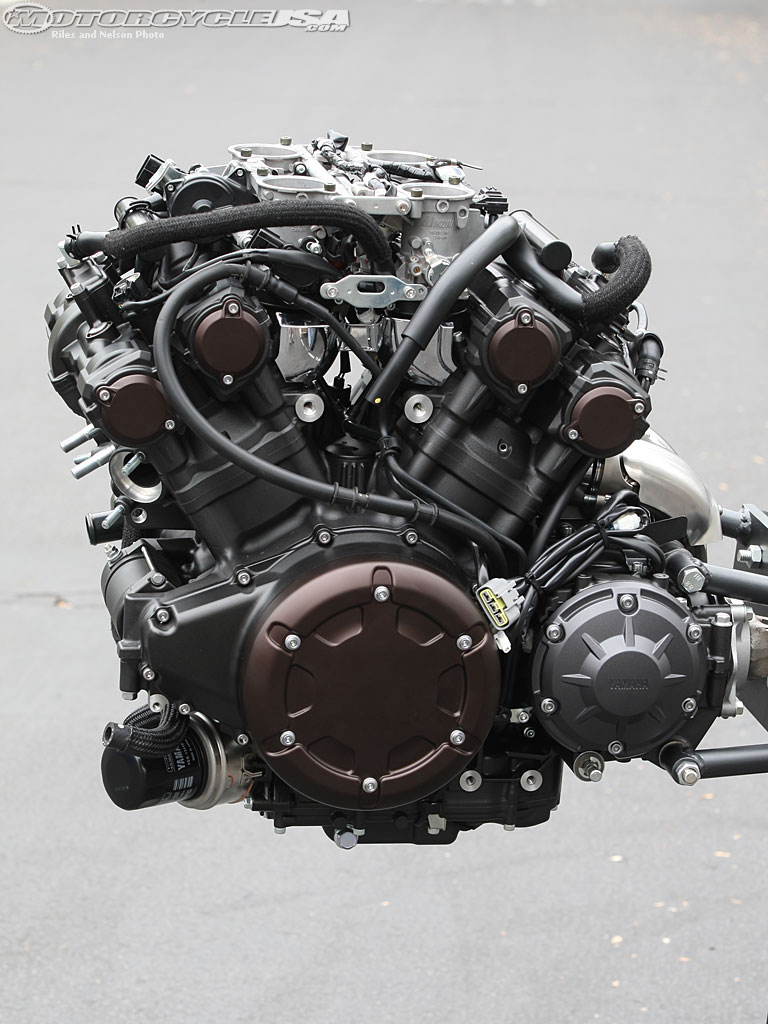

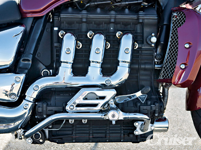

Anyone ever put a larger displacement motorcycle engine in a 914? The VMax features a compact v-4 that makes 197bhp, 123 lb/ft torque and will peel your face off. Obviously it weights a lot less, but then I got to thinking about other options. idea.gif We just got a Triumph Rocket III in stock and it's a 2.3 litre inline 3 cylinder. Makes 146 bhp and 163 lb/ft torque. Both motors are pretty compact and feature a shaft drive 6-speed transmission.
I think the transmission mating would be the most difficult, but what about adapting the motorcycle transmission somehow? I picture connecting the drive shaft to a rear differential of some sort. Or...if you could mate the shaft drive from the bike somehow to the 901, you could essentially have 30 different gearing combinations. All I would do is mount a hand clutch somewhere, maybe near where the rear brake is, and replace the heater lever with a simple hand shifter that would link to the bike's transmission. You could ALWAYS have the right gear, but you might need an extra hand or two, or a co-driver to manage the second transmission lol.

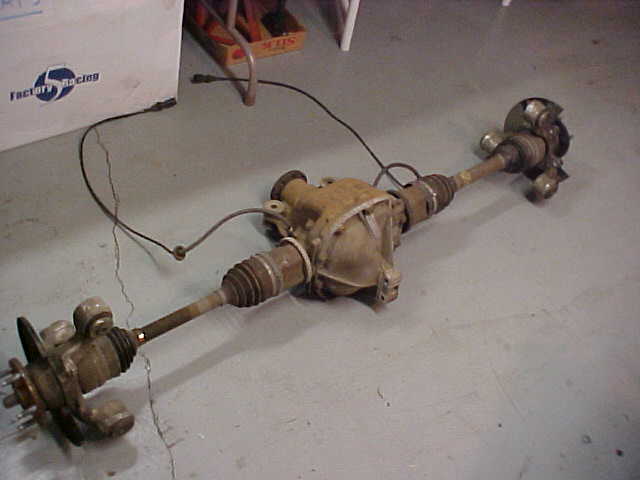

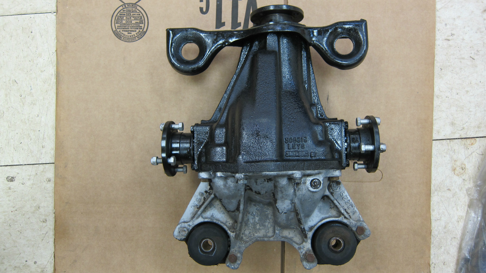

Motorcycles converted into trikes are using IRS rear ends now, that may be something to look into...
Tilly74
02loftsmoor
Tilly74
Or stick with the trailing arm suspension and use one of these...

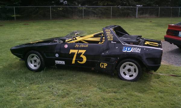

GSXR 1000 powered fiat X1/9
http://www.youtube.com/watch?v=cQM3krBmqbg
The x19 is smaller & lighter than a 914. Mass has a lot to do with the survivability of the bike gearbox in a car. (the GSXR 1000 and hayabusa seem to have gearboxes that hold up a bit better than the R1 and CBR's)

What does the fiat weigh? I've always heard they were heavy. I see that one is a racecar. A teener racecar can be 1600 with a -4.
What does that one weigh?
BKLA
QUOTE(brant @ Aug 21 2013, 05:05 PM) *
I haven't weighed it yet but it is very light. My son and I easily pushed it up on the ramp trailer. Every panel is 'glass except for the door skins. The car currently has about 50lbs of lead bolted into the passenger footwell from when it ran GP.
I'd hazzard a guess that it is about 1000# without the motor/gearbox/axles...
