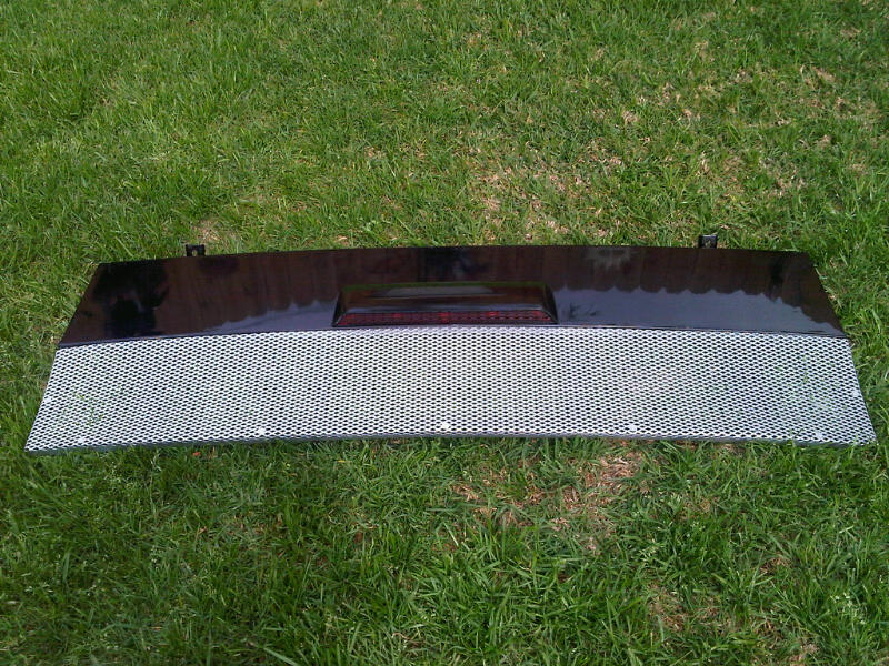

Garland

bandjoey
Sep 9 2013, 07:39 PM
Mine looks like Garlands, except it's an allweather stick on 24" led from Autozone. Been on for almost 2 years, 60 miles a day in all weather. I know it's stopped trucks from running over me on the freeway. Wires through the chrome. Put in a small cut of rubber vacuum line in the metal and inserted the wires, and then a dob of clear silicone glue. Wires down and into the mesh next to the engine lid, down the wiring harness, and a double plug onto my stop light on the left brake light. Quick, simple, and easy.

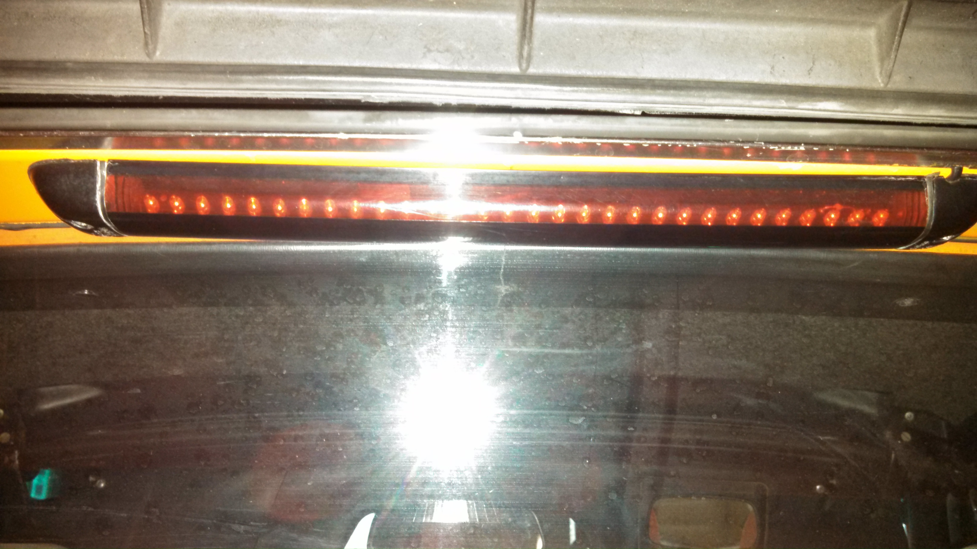

wndsrfr
Sep 14 2013, 12:29 PM
QUOTE(AvalonFal @ Sep 11 2013, 06:25 PM)
What about the turn signal feature on the lite I originally asked about? Anybody got a turn signal function on their 3rd lite??
Paul
Heres my setup, $ 25 strips, only have brake function now but I think a simple mod would add turn function as well....
