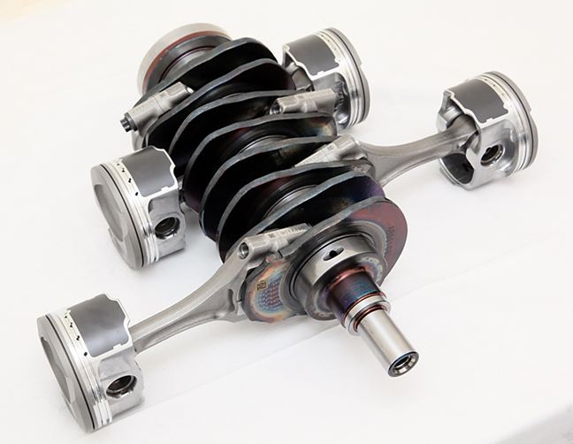

So Jake, I assume that the FA20 motor in the Subaru BRZ gets it's 7500 RPM redliine because of the DOHCs?
And possibly the fact that it is a "square" motor (86X86)?
In my other thread, I posted a motor for sale for only $3k that I thought you could have some fun with.
Stu
DBCooper
Sep 10 2013, 09:06 AM
Square actually makes it harder to get high revs. Jake was describing an oversquare engine, bore a lot larger than stroke, so lots easier to buzz. The square ratio makes for a more balanced motor.
That's a beautiful engine, by the way. Look at the size (and number) of main bearings, the little tiny coated piston skirts, those beefy rods, long rod bolts, big thin and smooth counterweights. That's nice.
