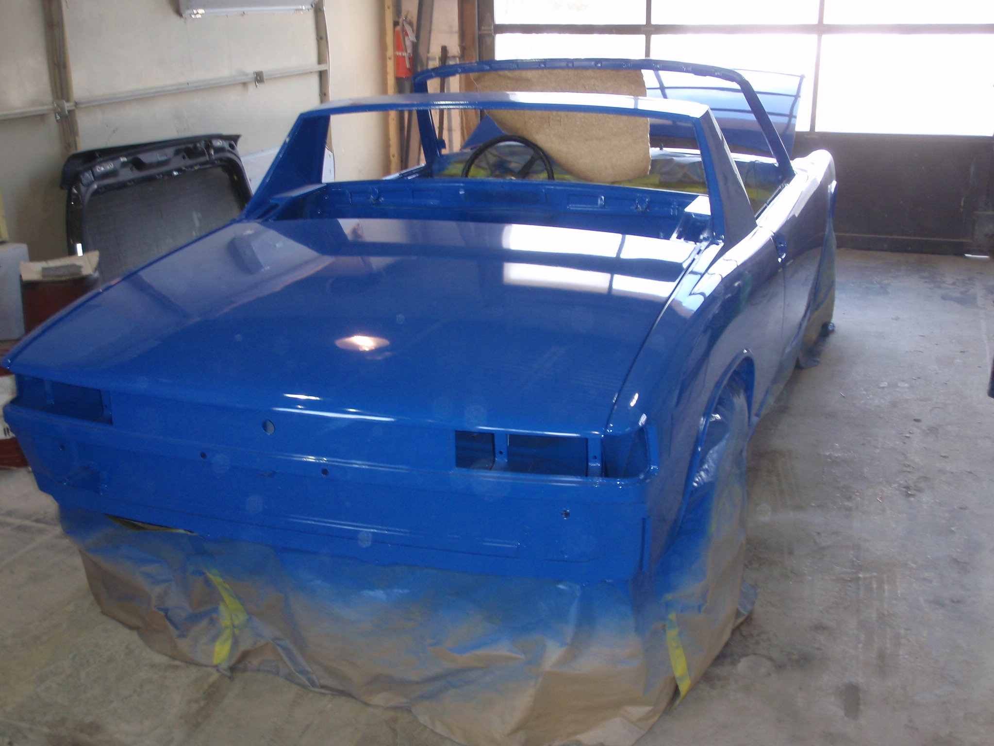

Dupont Adriatic blue
'73-914kid
That right there is the color.. Once you get home, please please send it to me. There is a chance that they'll be spraying color saturday morning.. so the sooner the better.. BTW, if anyone else has it, please post it..the sooner the better
wndsnd
Here is a sun shot.
I will send when I get back if you dont get before

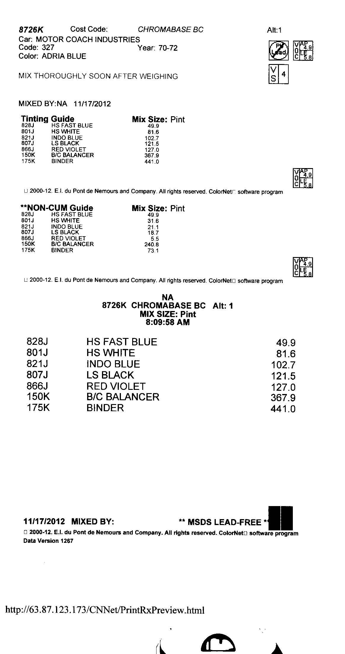

wndsnd
This is what I have.
The code is 8726K from what I have been told. The letter at the end designates the Dupont type of paint. The mix is supposed to be the same.
This mix is for the pint, but your Dupont guy can mix convert to gallons.
Have fun.
John

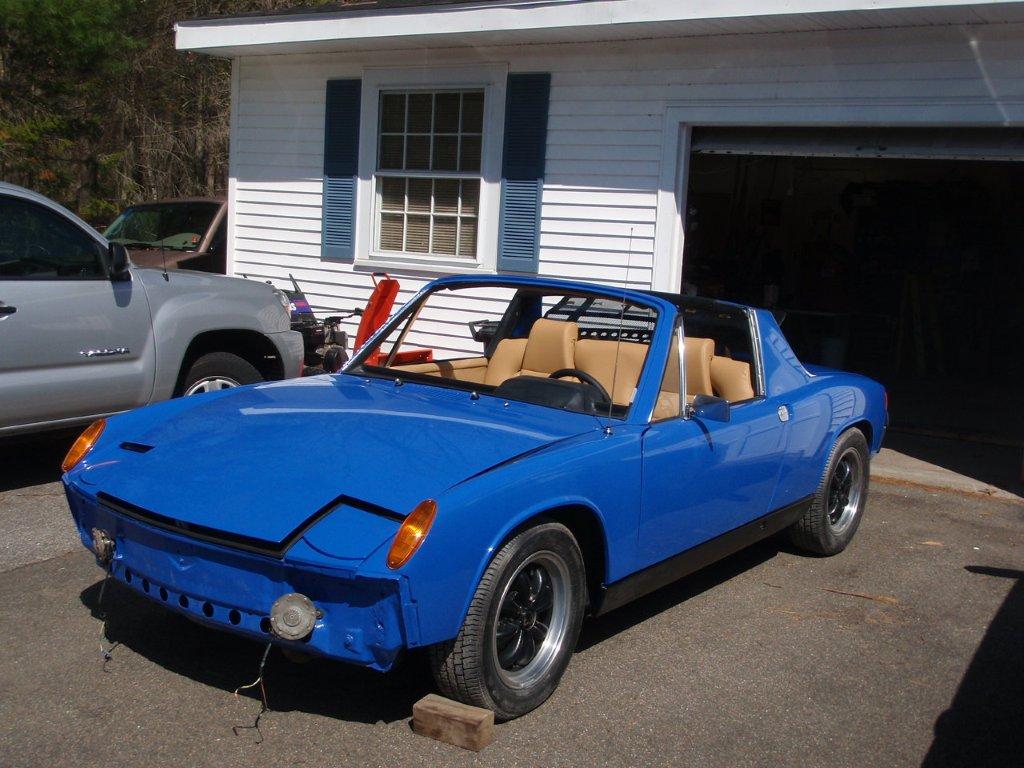

Harpo
Wndsnd love that color with the tan interior.
David
wndsnd
QUOTE(Harpo @ Sep 14 2013, 12:04 PM) *
David
Thanks David,
It is starting to come together.
