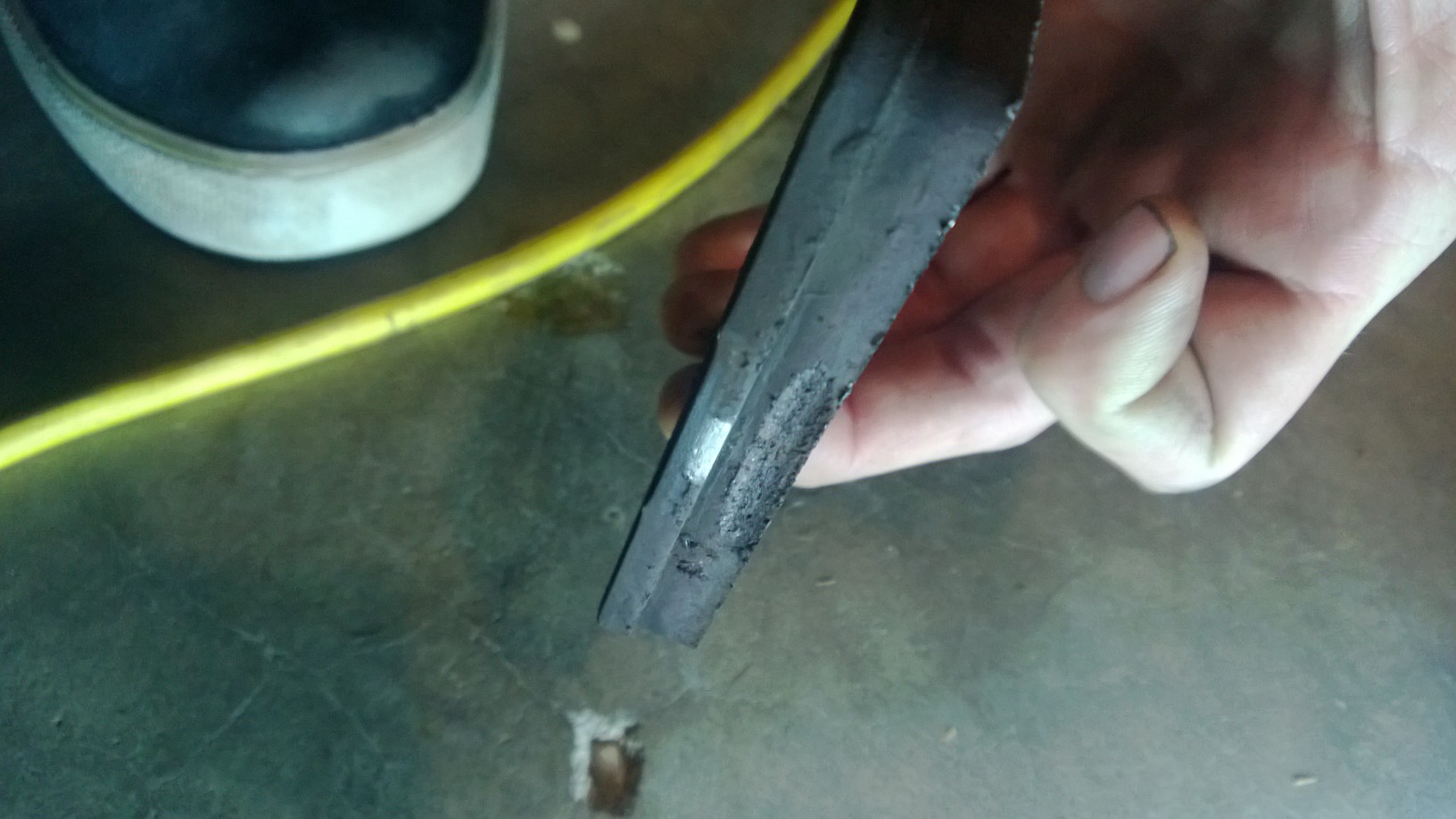

Cooling ducts will be ordered shortly. I pulled the wheels off and upon close investication it looks like the metal pad backing is actually rubbing the aluminum of the hub a bit, I'm sure that's not helpful heatwise... I believe the front calipers are Volvo types. Maybe just grind the metal edge down a bit?

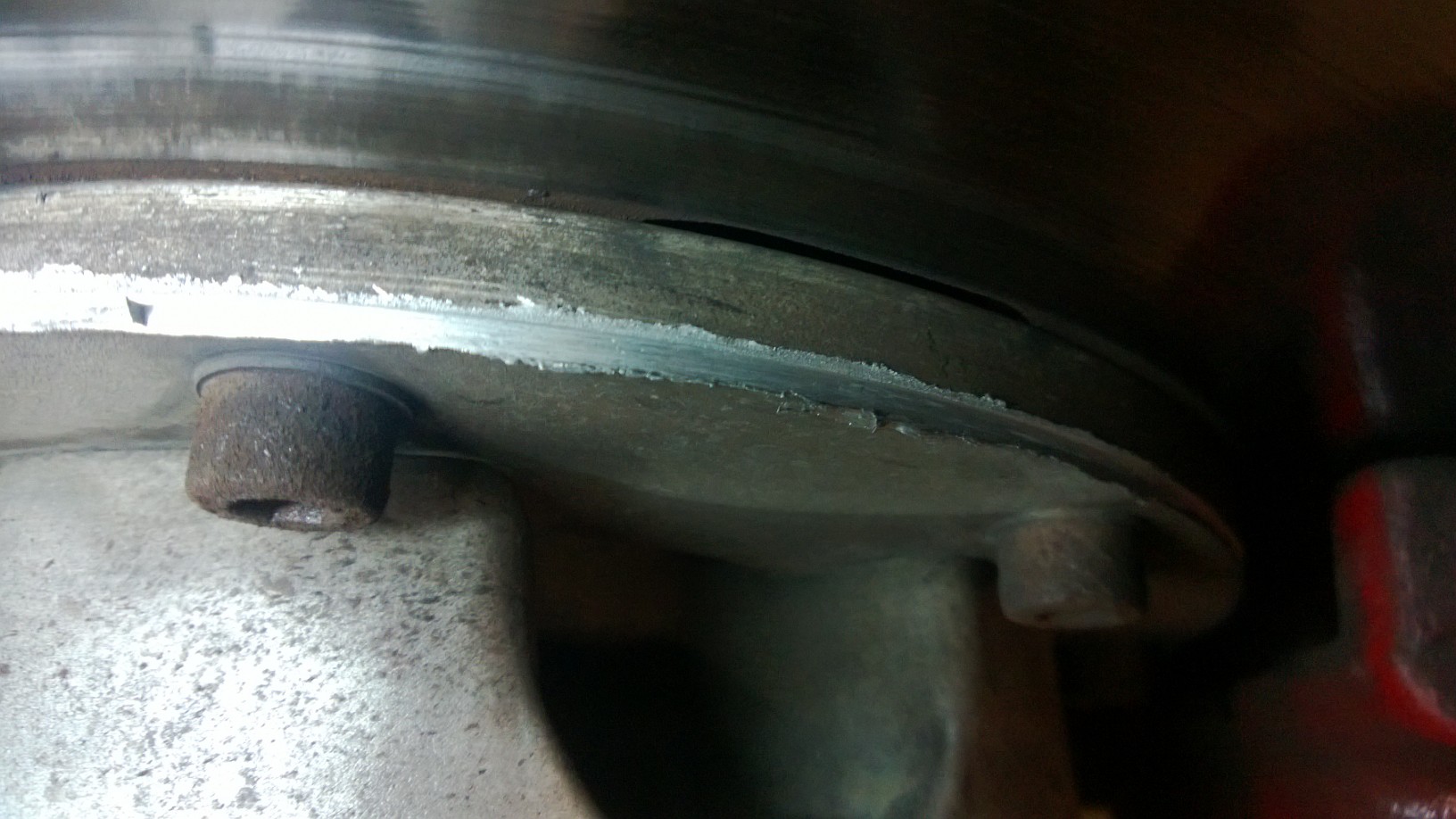

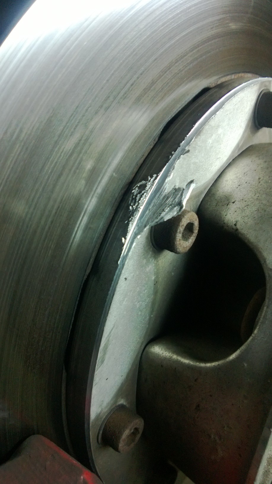

For my 1000'th post, I have attached a few shots of the damage to the hub from the brake pad. My plan is to take a grinder to the metal lip and take enough of it so it clears. Anyone see problems with that?

tscrihfield
Ross,
That's not the hub...that's the rotor hat! Dude... Not good!
Thomas
'73-914kid
I'm gonna guess you have the Volvo 4-pot calipers? If so, yes, with some pads you have to grind the metal away. I noticed it when I went and put a new set of pads on my calipers that it rubbed on the rotor hat. It's not a huge deal.. take a fine rasp, clean off the burrs, and grind down the metal backing on the pad..
No harm, no foul.
Eric_Shea
That's not the rotor hat either... That's an aftermarket cool rotor block off plate. Probably needs it because of the size pads in the Vulva calipers.
I'd probably make some changes.
Edit: it appears to possibly be a spacer to properly center the rotor. Cool rotor block offs should go in the back.

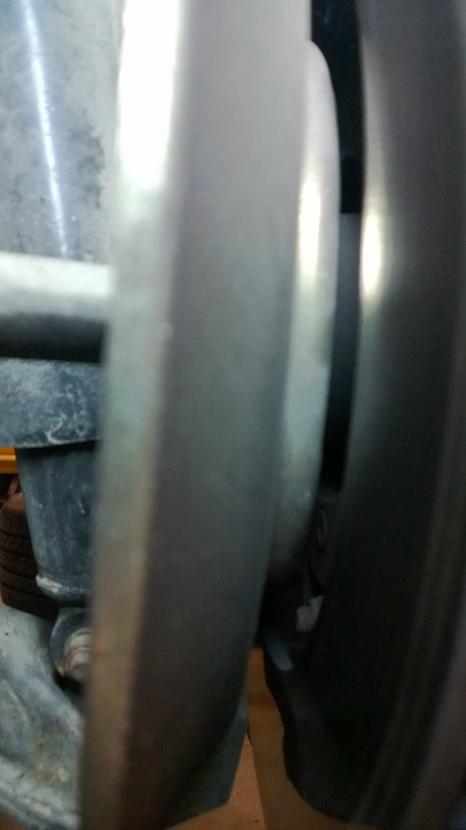

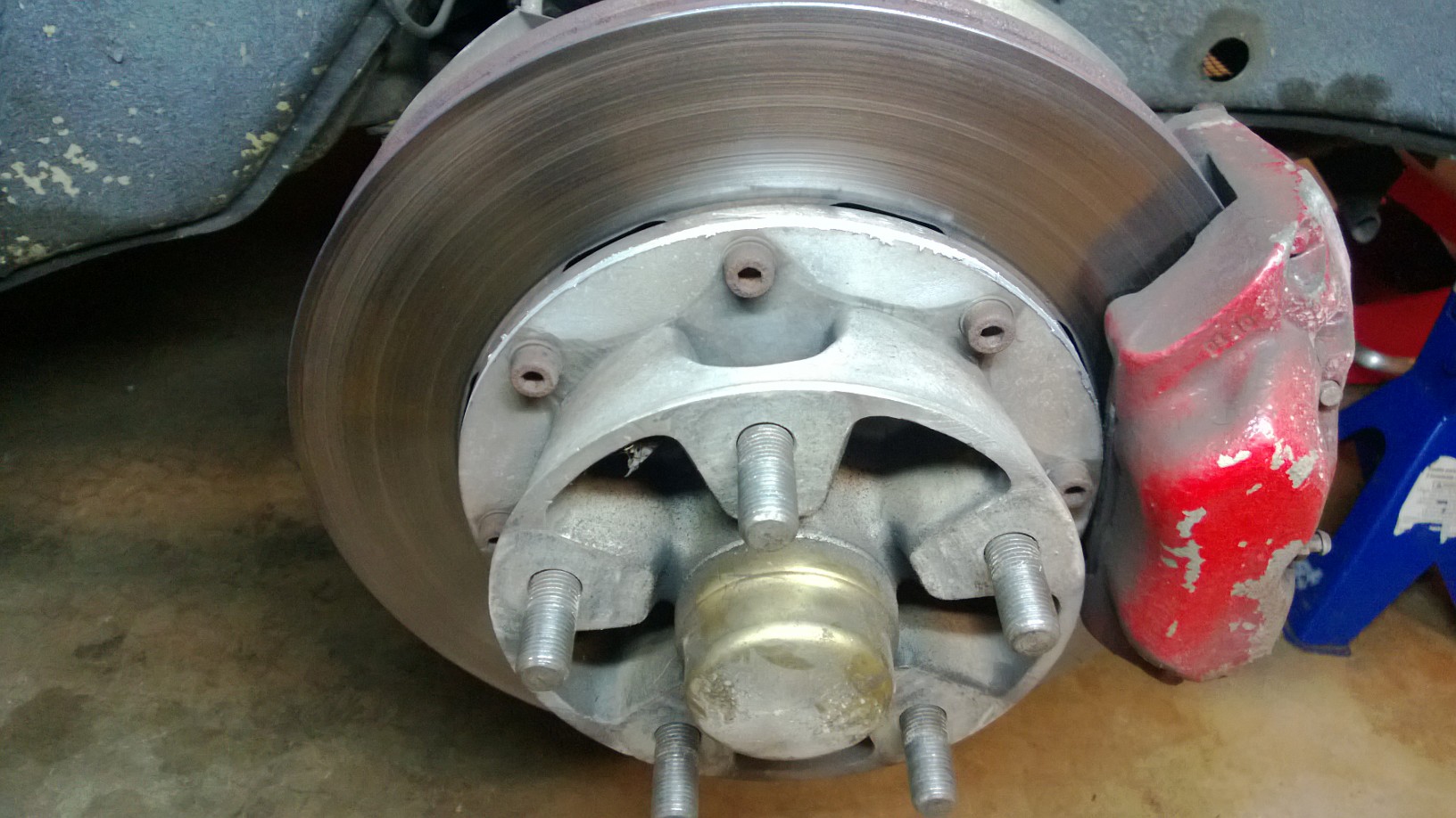

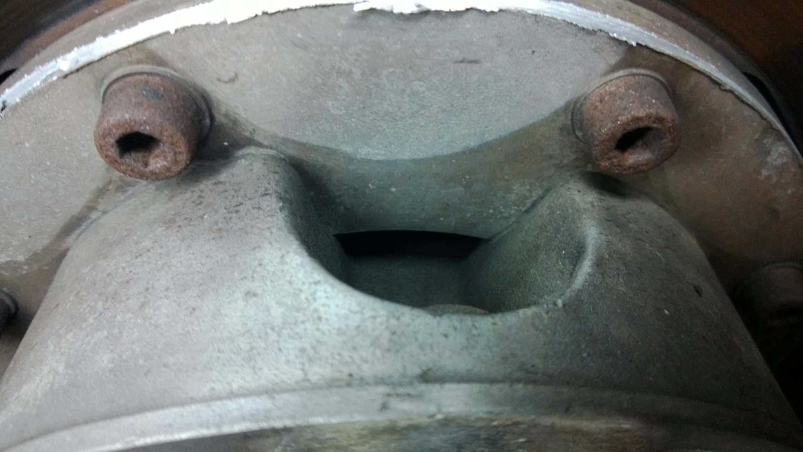

rnellums
Maybe these photos will make it clearer. I'm running 911 struts, and the rotor is bolted only to the aluminum disc, which in turn is bolted to the hub. The other side of the rotor is floating.
tscrihfield
Those are some sort of hat... Doesn't look as bad now that it's zoomed out...
