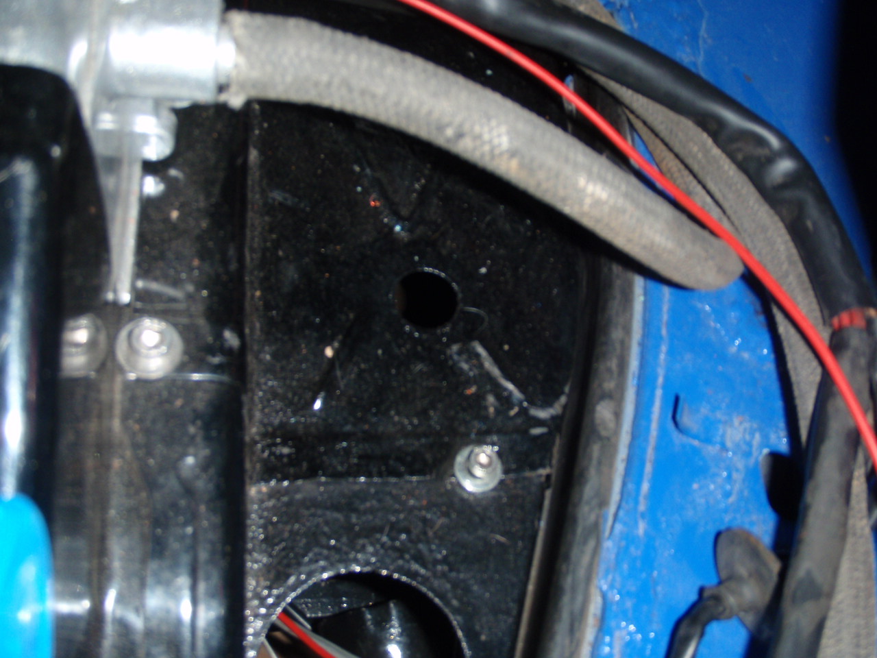

From all the pictures I could find it looks like it enters under the battery tray. Does is come through the engine sheet metal or the shelf surrounds.
Anyone have a picture you can post ideally feeding dual webbers?
Thanks

Thru the engine tin, passenger side forward .... look for the hole in the tin.

QUOTE(SLITS @ Oct 14 2013, 03:21 PM) *
Specifically the engine head tin on the passenger side, near the front of the motor,
On the horizontal section in front of the 2 inch heater hose hole.
should be a hold about 1/2 inch for the throttle cable, you may need to source a grommet.
rich
wndsnd
Must be here?
Thanks Rich
r_towle
X marks the spot....

Thanks guys,
I got it in and set it up with the carbs. So far so good.
