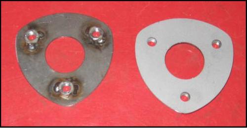

You have to remove the tank to but the thinker plate on the inside. You will have to trim for the bottom bolt hole. I just did this to mine this weekend, before and after pics of what I had to trim for the backing plate to fit.
chads74
Oct 14 2013, 05:58 PM
euro911

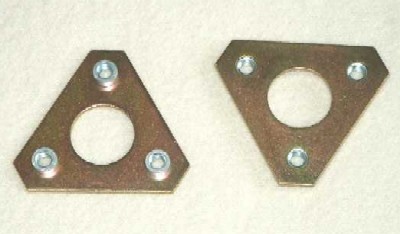

Yeah, you have to remove the tank either way. Dave (maddog) is now manufacturing Engman 'clone' reinforcement plates too ... I would suggest having a set welded in to spread the loads over a larger area.
Click to view attachment ...
Click here

Terrific images Friend! Thanks for that. Were you planning on welding or through bolting? Very helpful image. No doubt my tank will have to come out either way, lol.

Well that's quite interesting. Certainly more re-enforcing than I intended. My bar is stock and my driving is "spirited" (it is after all a v-8 converted) but I'm not at all sure that level of re-enforcing is needed given the level of driving. Seems more "race carish". Pretty neat stuff though :-)

Click hereI had my hands on some of Dave's plates at Okteenerfest this weekend. Quality stuff for sure. I am planning to do my install this winter so I will be following what happens here. Don't plan on auto crossing so I had convinced my self there was no need to weld. Now I am not as convinced.

The factory used a tri-oval shaped reinforcing plate with nuts welded onto it.
However, they spot welded the plate to the body from the outside instead of perimeter welding it on the inside.
I've seen original factory installations that cracked but only after the suspension had been upgraded with a larger anti-sway bar.
